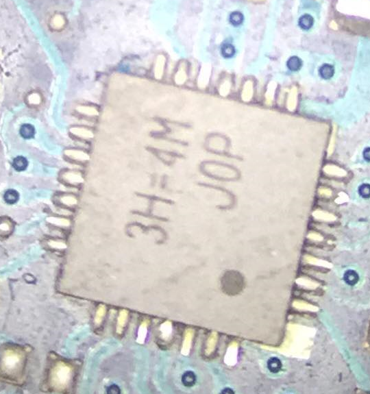

i need to identify this regulator pls help
    Hi bro
    how to identify this kind of regulator?
    PART NUMBER?
    Product code : 3H=4M

      sorry bro but i cant see this product code inside

        anyone plss help to identify this product code 3H=4M

          Rt6585bgqw=3h

            The ic is a Richtek RT3601EAGQW

              Thats right R_J . To quote from the Richtek post: "The package also matters, different ICs with different packages can have the same marking code."

                Yes, R_J is right. I accept my mistake and apologise for misleading the author.
