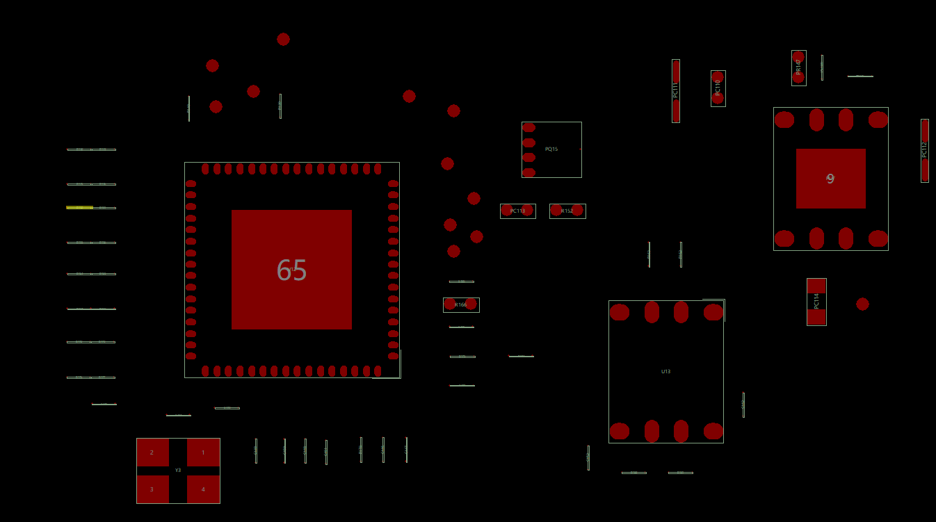

    The usb 3.1 chip (ASM1142) U12, is not mounted.
    Seems U12 is mounted in version 1.1 (page 33: PCB 1.1 modify)
    It is a bit weird that in version 1.0 the USB3.1 TYPE C (CON3) is controlled By PCH (U15)
    All readings in usb ports are good, there are no shorts and 5 volts are present.

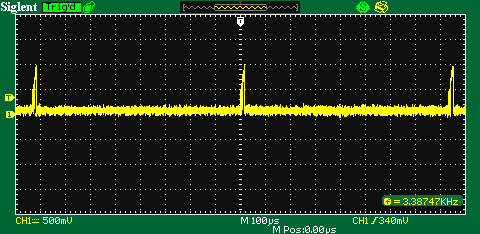

    I have tested some PCH signals and found that USB2_COMP has some weird pulses.
    OTG_ID_JNC circuit in pch (pin AG2) has no voltage and R185 seems good (1K)
    R446 (USB_OC) has 3 volts in both pins.
    Please help.

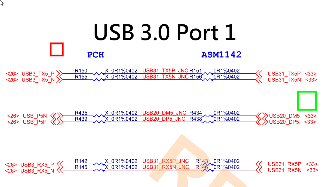

              Review the attached diagram.
              Which resistors are stuffed on your logic board?

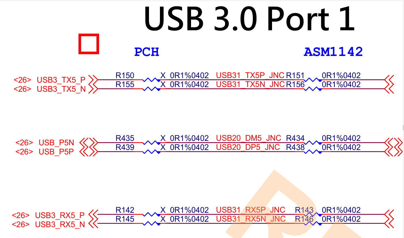

                Re: MSI PE62 not working webcam and usb ports.
                Hi, all resistors going to U12 are missing. This board not mount ASM1142, this port is controlled by the pch.
                I have tested USB_OC signal just in case pch sees an over-current but it has 3,4 volts and nothing changes if this signal is grounded manually.
                I'm trying to find a resistor strap that disables all usb but can't see any.
                Thanks for your help.

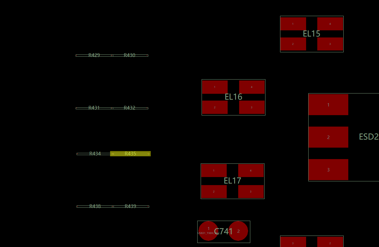

                  Hmm. As a suggestion, consider to remove temporarily the 0 ohm resistors linked to USB 3.1 port 1 and then test to see if port 2 is functional or not.
                  Then repeat this exercise for USB 3.1 port 2. Only to see if USB components are to blame for this non-working condition or not.
                  Perhaps one of the ESD protection device is causing these issues.
                  • Francisco.s
                    • Jan 2013
                    • 686
                    • Spain

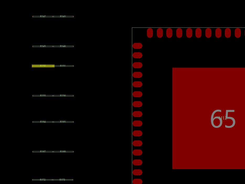

                    Hi, can not find this 0 ohm resistor.
                    Can you point me how it is called on the schematic?
                    Thanks.
                      See if the attached helps.

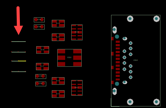

                          I misunderstand you, I thought you were referring to a a 0 ohm resistor in the USB5V_PTx pin of ESD protection devices.
                          I have removed esd protection devices in order to not interfering the circuit.

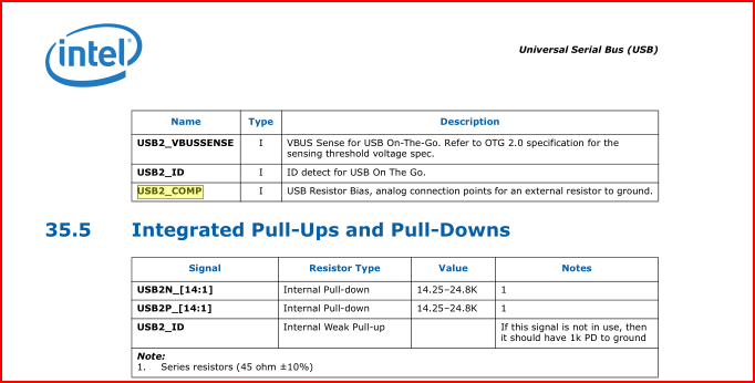

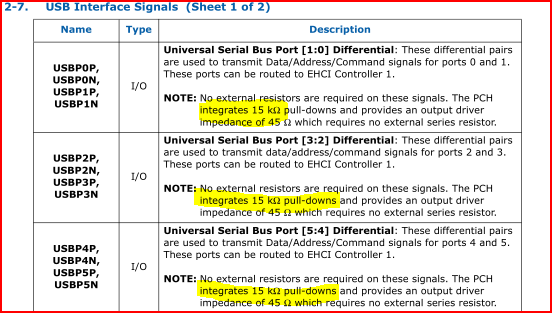

                                      R186 is 113 ohms, but I can't tell you if there is a goo connection with pin AG3 of pch
                                      I have removed R186 and the reading in diodo mode is .475, so no problem with this connection.
                                      I have checked USBSMI# signal has no voltage at all, as consequence of R175 not being mounted in this motherboard.
                                      The ohms readings in all of usb lines are about 2.1 Mega-ohms, but data sheet says that pch integrates 15 kΩ pull-downs resistors.
                                      • mon2
                                        • Dec 2019
                                        • 14662
                                        If I recall correctly, the internal 15k resistor is not a resistor but a circuit that is enabled on demand. For this reason, you will not read 15k on that line. Also, believe that the USB spec notes that it is a 15k value to +Vbus.
