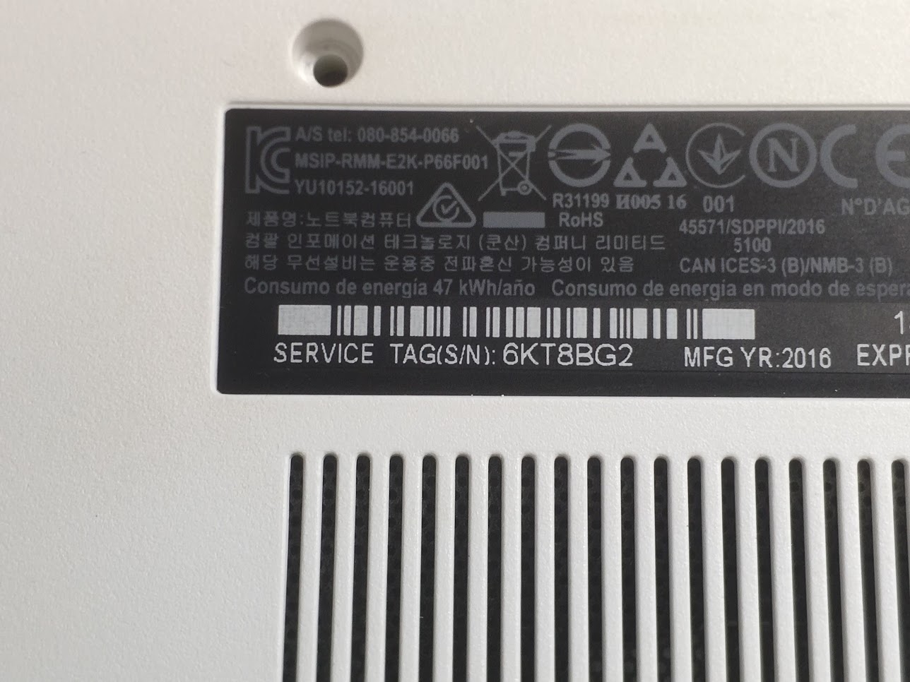

        What is your service tag number

          Re: Dell 5567 (P66F LA-D801P i7-7500 + amd discrete gpu) freezes while booting window
          picture.
            Try this bios - https://www.badcaps.net/forum/showpo...1&postcount=28 .
            There`s already quite a few bios posted for the LA-D801P, some have AMT enabled,AMT disabled,no bootguard, bootguard FVME 5 . It might not fix your problem but worth a try.

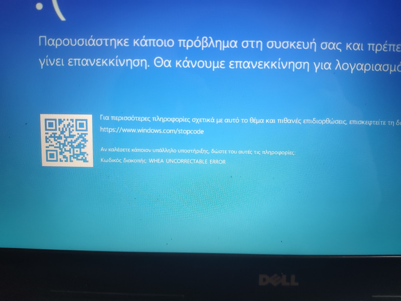

                  now i have this bluescreen

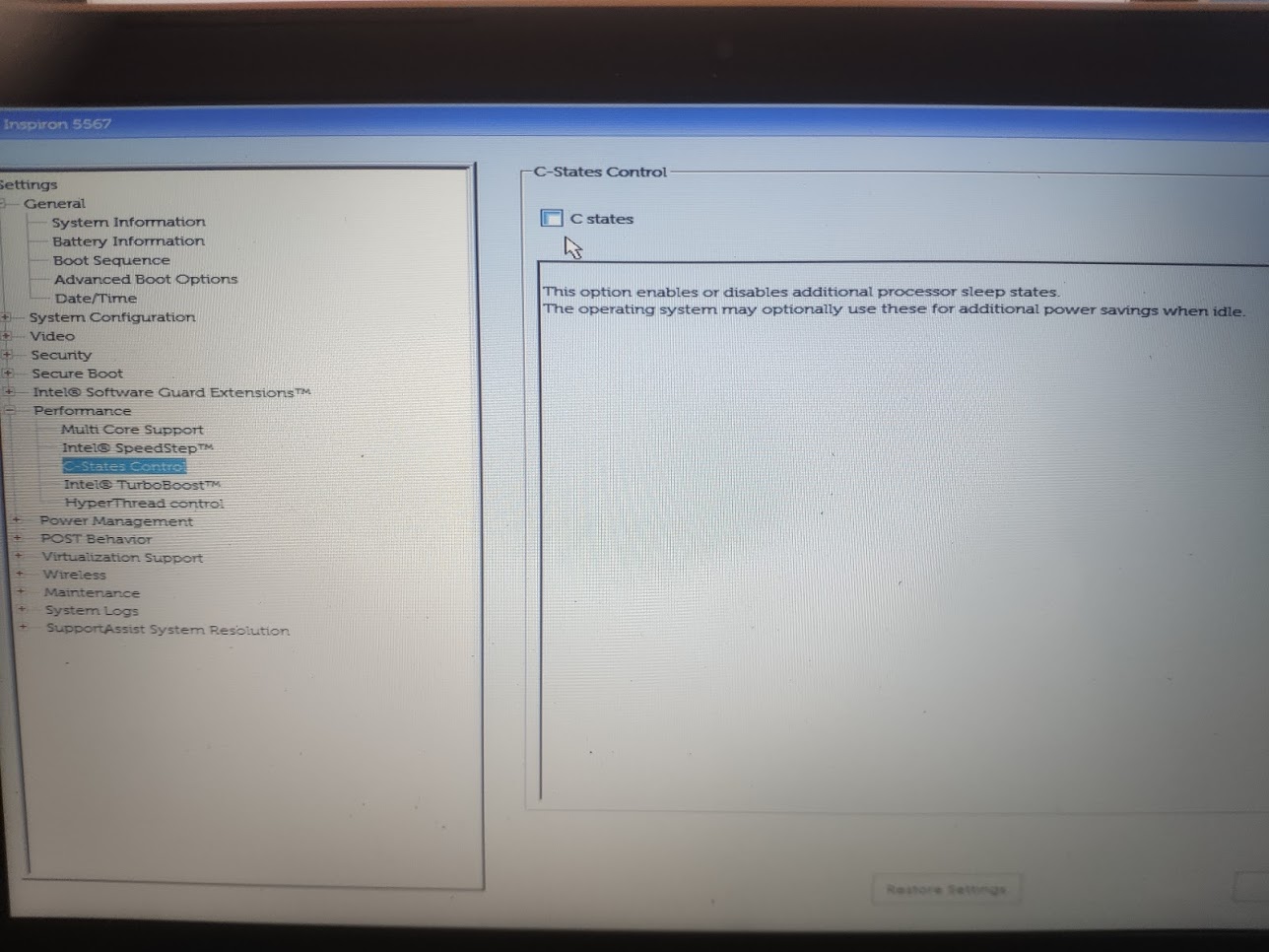

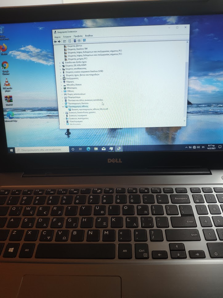

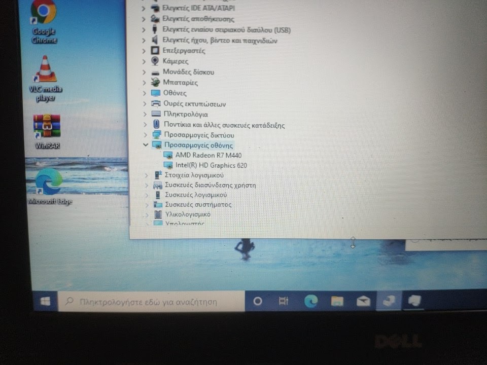

                    OMG! i disabled everything from bios from perfomance and i logged in!!with the last bios you send me!! now i enable one by one to see whats the option that gives the trouble.
                          so C states from bios performance gives me the problems. with disable it works just fine anymore only with your last bios

                            You are welcome. Can you explain the setting that you changed on bios?
                              i tried with other bios dumps to disable those settings and i just got black screen on reboot, only with the last dump the laptop was going really fast and when i disabled the setting it worked just fine, it rebooted and logged in to windows!
