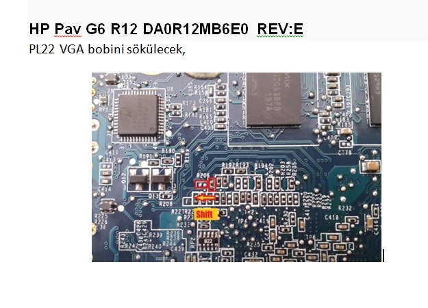

    Hello friends.
    Hp pavilion G6-1045 Motherboard ref : DA0R12MB6E0.With Graphic chip AMD.
    Issue : Power On ok but no picture , only backlight ( Nothing at External )
    Voltages taken :
    pl 20 = 5v
    pl 21 = 3v
    pl 17 = +BATCHG = 0.669v
    pl 14 = +1.5VSUS = 1.5v
    pl 15 = +1.05V_VTT = 1.078
    pl 18/19 = +VCORE = 1.1v
    pl 22 = +VGA_CORE = 0.900v
    pl 23 = +VGACORE_IGPU = 1.1 v
    pl 24 = +1.05V = 1.1v
    U5
    Pin 13 = PLTRST# = 3.3v
    dramrst pin 30 = 1.5v
    I try Clean ME bios , try another bios ( https://www.badcaps.net/forum/showth...&highlight=R12 ) but still the same.
    Try converting to uma same issue.
    Only backlight no picture .
    What to check else !

    the PL22 VGA coil will be disassembled. and resistance modification

      Re: Hp pavilion G6 Quanta 12 No picture .
      Thank you Sametbey
      I did this conversion ,removing PL22 and shift R207 to R206..still the same...that's why i m so confused..
        Did you check the LCD panel voltage in LVDS socket? Does the RAM socket have a 1.5 v RM_RST signal at 20 pins. are there voltages in the other coils? North chip HM could be problematic.
          Yes , the +3VLVD /3V/VIN blight are present ; the dramrst pin 30 = 1.5v ( pin 20 !!)
          I mention all this before.
            Have you tried another LVDS cable, checked voltage at DISP_ON
              Thank you SMDFlea
              Yes it's a basic things to do : changing screen , lvds cable.
              For DISP-ON taken at Q4 :
              1 = GND
              2 = Disp-on = 3.3v
              3 = 0.012v
