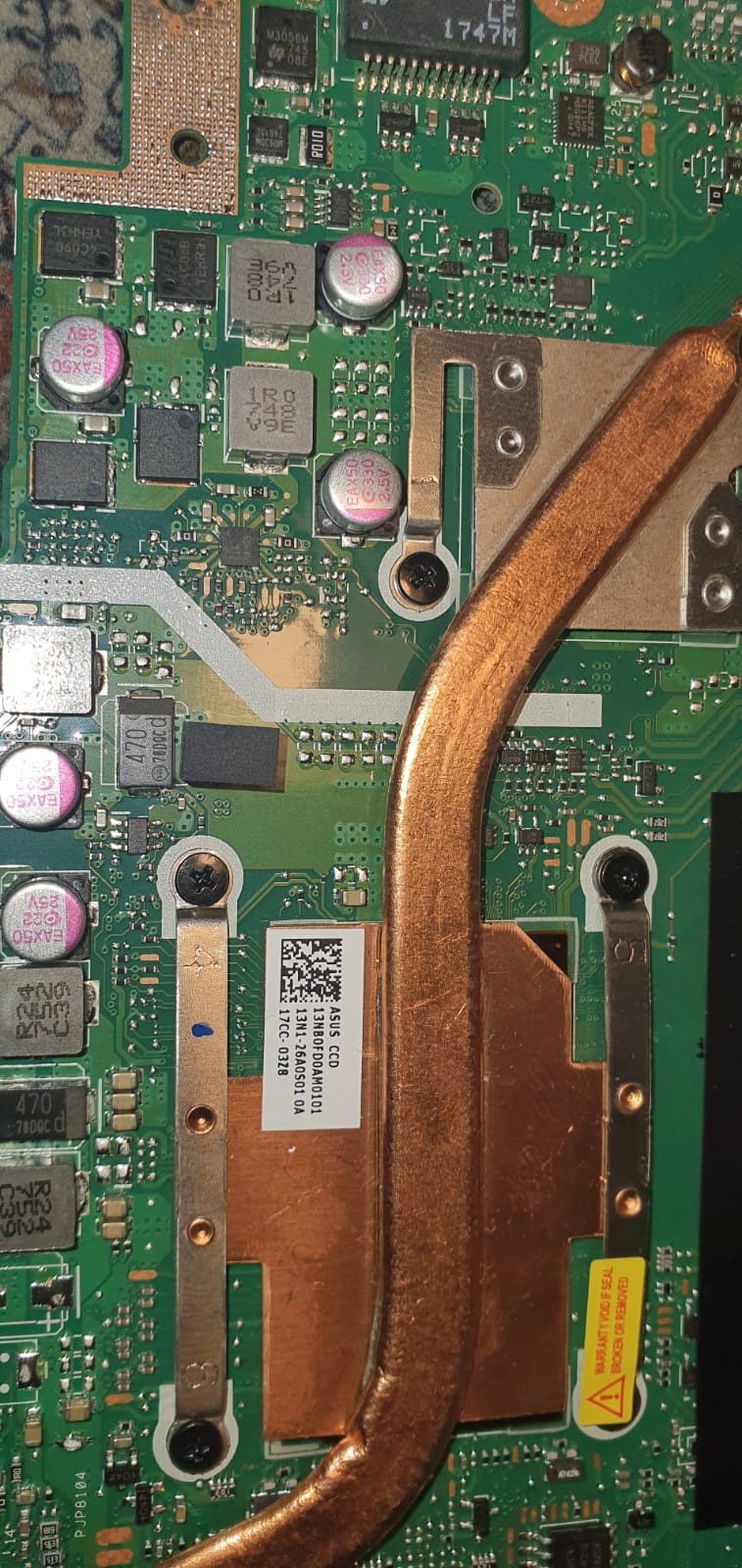

component value Asus
    Hi guys
    5u=4h
    what is it ?
    8205?
    8206?
    thanks in advance
    Mandel
    Re: component value Asus
    1) which exact motherboard model?
    2) where exactly is this component located?
    3) post a clear picture of this component that shows these markings

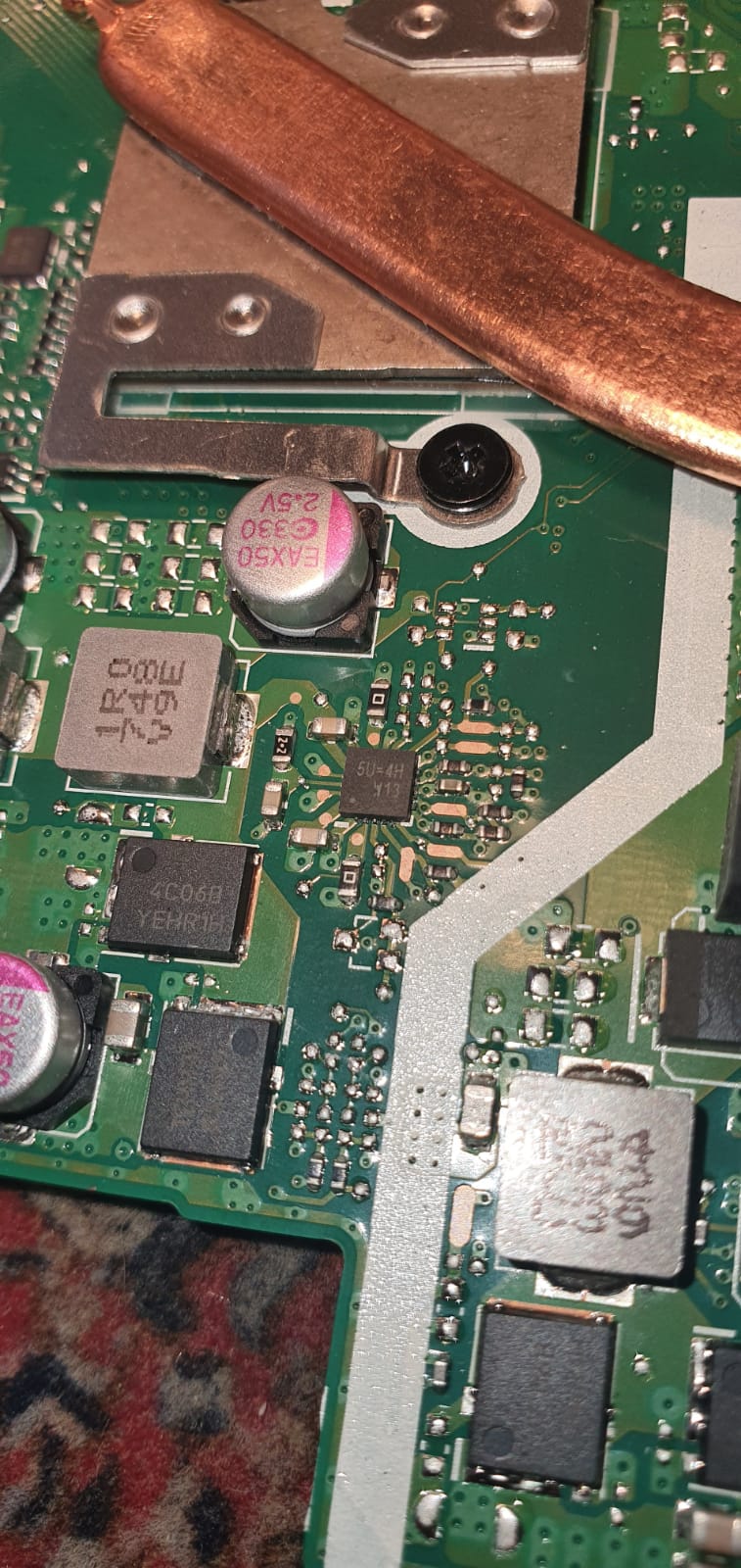

      thanks for replay
      send all you need to know on the photos
      thanks
        It seems to be RT8815A.
        https://cdn.badcaps-static.com/pdfs/...0313ef7ded.pdf
          Well done @Smoxx. Learning something new every day here.
          Did not know that Richtek had these markings.
          I believe another tech was hunting for a similar marking with "4U =" so that should also be Richtek?
                  Thanks.
                  You're welcome!
                  Do you have any pic or package info of this 4U=? And yes, as already pointed out by moderators, marking codes followed by = and - are likely to be Richtek.
