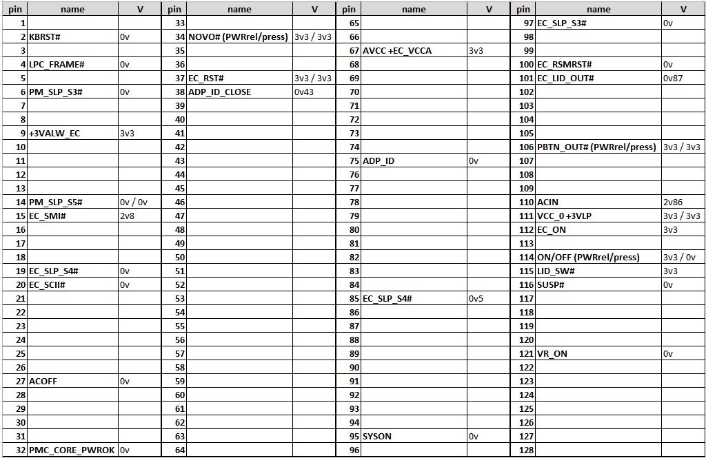

    Measurements of other KBC pins (ENE KB9012QF A4) attached in the table, see picture.

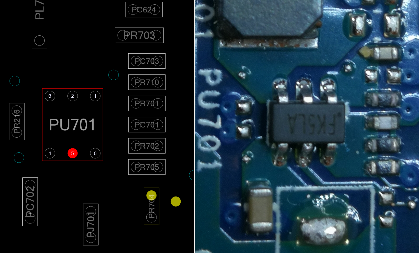

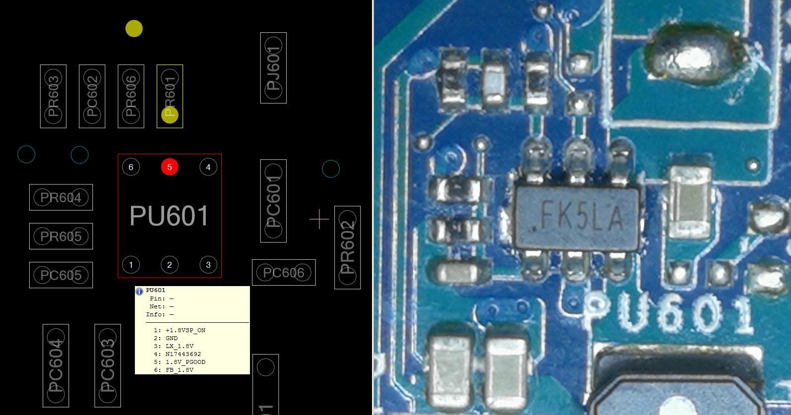

      I checked the voltages on the PG pins PU601 and PU701 and they are really low. But the pull-up resistors PR601 and PR704 are missing on the motherboard, see pictures.
      I checked the other same motherboard and it doesn't have these resistors either.
      What does it mean?

        Re: Lenovo G50-30 (LA-B102P) no POST when power on
        Those resistors are not populated as per schematics-so nothing wrong there. Do you get 3V on PG pins of PU601/701 on another mb??
          I do not get 3V on PG pins of PU601/701 on another mb.
          The result is the same.
