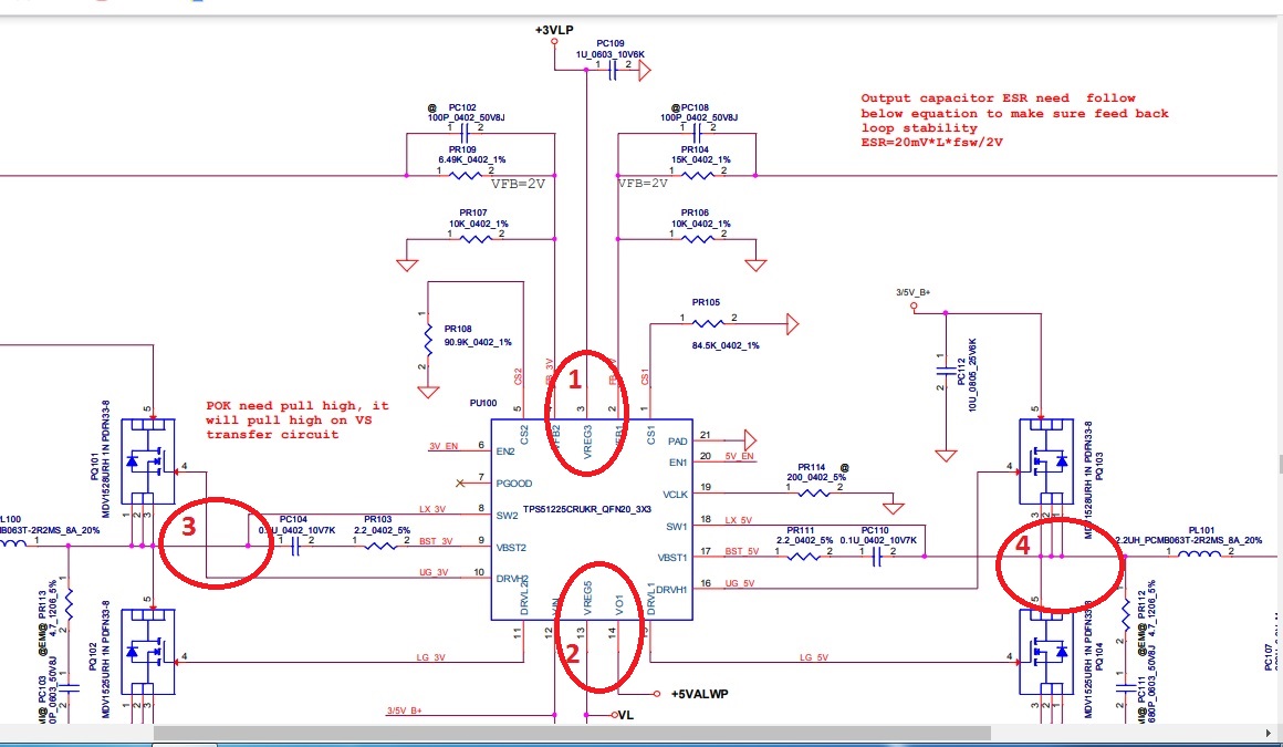

I've got this Dell Inspiron 3537, LA-9982P, can it powers on during POST (I'm guessing). Occasionally I get the typical Dell message complaining about not using the correct adapter with the right wattage, but that could be because I've removed the battery.
First thing I've found was that the original adapter was fluctuating between 12V and 0V, so going from 12V down to 0V, slowly. Then instantly goes back to 12V, and down back to 0V slowly. Tried two different adapters, just to be sure.
Removed all components I could, left one memory module (one doesn't seem to be working anyway), even removed the screen. Issue persists, shows POST screen, then turns off. So total power on time is like 5 seconds. Won't turn on again unless power button is pressed.
Would appreciated any help, from where to start looking etc... I'm attaching the schematics
 Thank you
