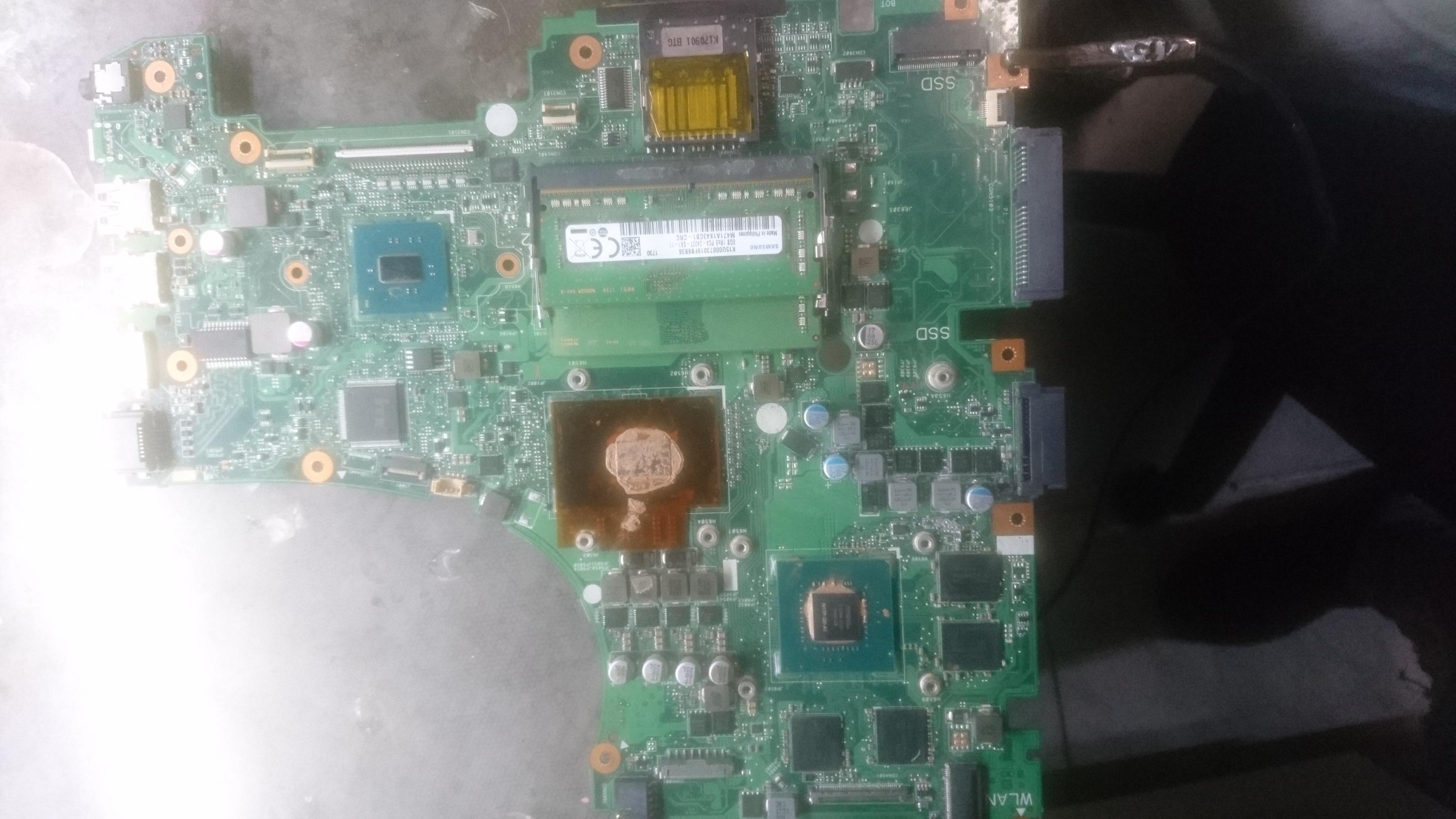

How to disable nvidia chip on rog gl553vd please

    hello guys does anyone know how to disable nvidia chip and live it as intel icore 5 working.i mean it is possible??
    here is the picture of the board thank you.

    Re: How to disable nvidia chip on rog gl553vd please
    Same problem please help
      u can try unlocked bios , but without schemtic u can only try remove power from it. intel can be disfunctional from design
        yes i disconected the power coil frome GPU and same problem i like to convert to UMA
          on some forums they remove coils with GPU ic
