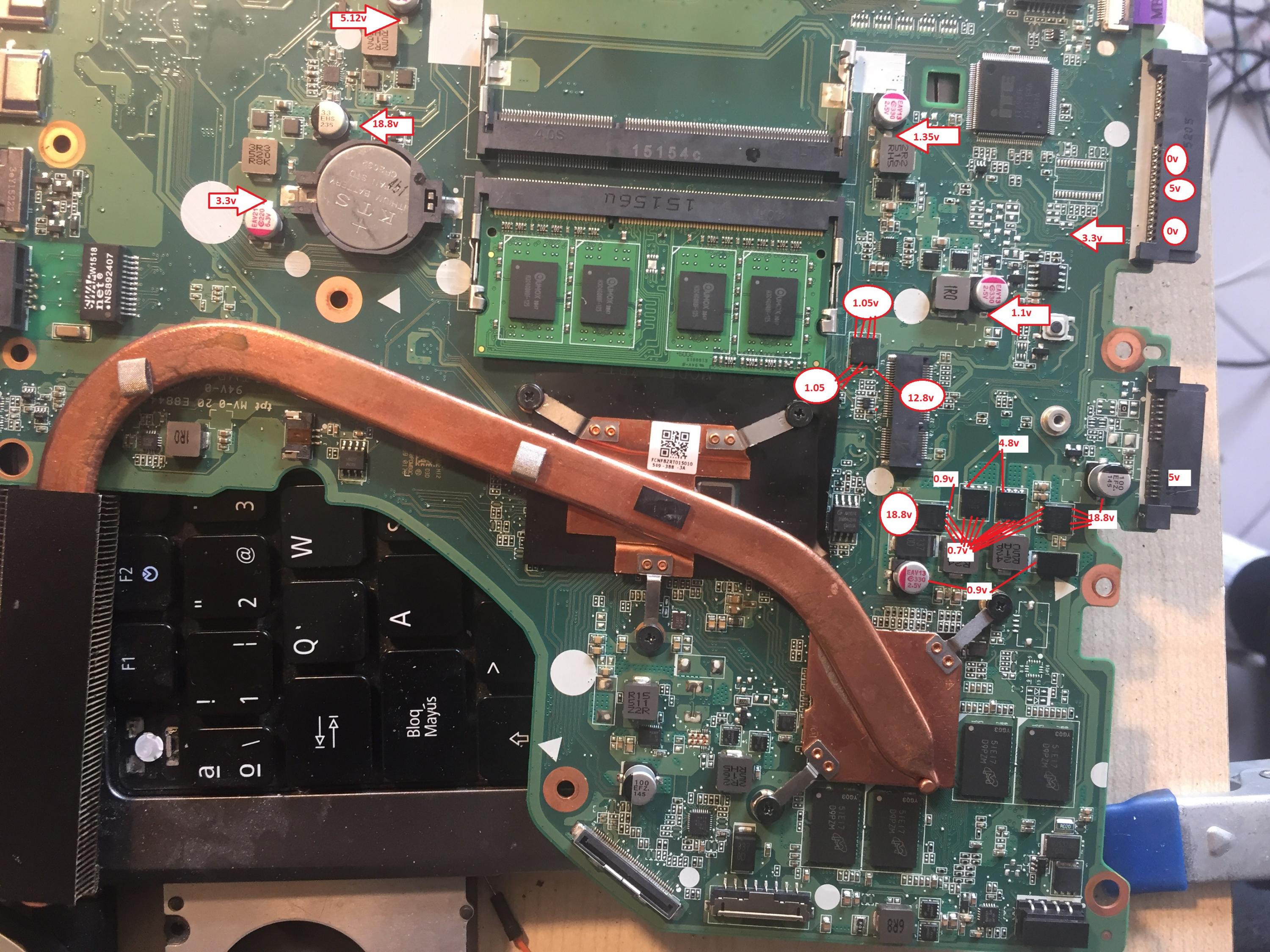

    My laptop has a problem I am having very hard times to identify:
    - No hdd, nor dvd, ethernet and wifi card shown in bios
    booting from usb everything else works fine, audio and other peripherals are working.
    I flashed bios multiple time using also the clean me version, no luck.
    i measured the voltages in any coil and I guess I am getting the right readings,
    I'm lost, I have no clue

    update:
    external vga works too.
    the hdd and dvd spin up regularly
    I upload a pictures of the voltages i did measure, they seem fine to me, does anybody have a clue?
    I really can't tell if it's a bios related issue or a hardware malfunction.

      Re: Crazy behaviour Acer 573G
      Please identify the board correctly.
      4.8 is a little low. Do you have a lab PSU? You should look for a pattern in power draw. What do you mean spin up regularly? Do they come up and down in a cycle?
      Because all the periphery you're describing feeds off 3.3/5 power rails, you should probably start looking there first. Look for things that overheat, low resistances, suspiciously looking elements and solder.

        Thanks for your reply.
        I mean that i can hear the hdd spin up when i turn the pc on, and then it will stay steady on (electrically), the dvd has voltage because if i press the open button it pops up the tray.
        They don't cycle.
        3.3 is present, 5 is present
        The board is a ZRT DA0ZRTMB6D0 REV D
        UPDATE:
        It "feels" like if a section of the board is off, but it seems logically more than electrically
                          Did you check under Linux with `lspci` to see what shows up on the PCIe bus?
                          The PLLs for these busses are powered from different pins on the PCH, going through different inductors. In general if power is missing on them it causes no POST, but you can still make sure the inductors are good and they have voltage on both sides. They are on the bottom part of page 11 of the schematics.
                          You'll have to use the component placement diagram of the boardview to locate them.
                          It's especially weird for the SATA controller to be missing as it's internal to the PCH, the Ethernet and WiFi controller are external so it could be an issue somewhere else on the PCIe bus.
                          Bluetooth is on the USB bus, audio codec IC is on the HDA bus so they kinda work independently. Although internally inside the PCH the controllers are connected to the PCIe bus.

                              I retested all coils, voltage costant and regular on both sides
                                • 21417
                                Can you measure voltage on DEVSLP0 ,EC_ODD_EJ pin 94 ,ODD_POWER pin 71, IOAC_WLANPWR# pin 35
