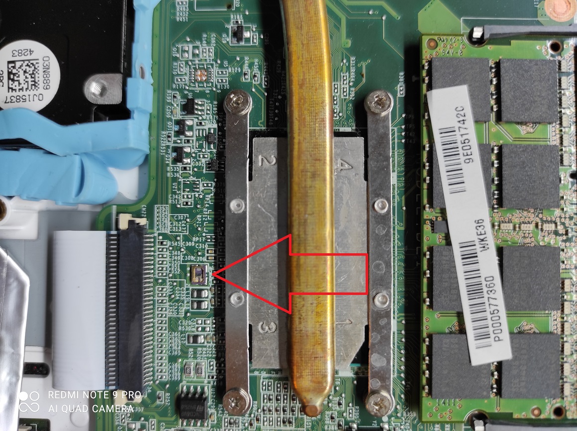

    This laptop will not boot up, I have examined the MB and found a blown component.
    Motherboard: da0blimb6f0 rev f
    Can anyone identify the blown component?
    Any assistance would be appreciated.

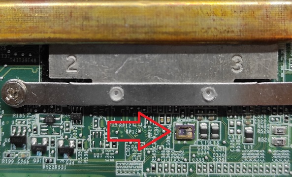

    Seems like RTC crystal for PCH. Try to post closer pic of damaged part

      Thank you for the reply, it is not going to be easy getting a closer photo, the component is tiny. I will give it a go.
      Also - would this component stop the laptop posting?

        Yes if it is confirmed crystal or oscillator
        Remove heat sink and take close snapshot
        Crystal provides frequency or clock signal to the PCH and PCH boosts the frequency according to different system device needs
        Clock is normal 32khz , you can verify by oscilloscope

            Hi Guys, I cannot get a clearer image of this component, my phone just refuses to focus on it.
            I agree, this looks like a crystal, if you guys are confident that it is 32KHz is there any reason why I could not just purchase a generic SMD replacement?
            Example: https://www.ebay.co.uk/itm/CRYSTAL-3...kAAOSw4yte6fMm
            I presume there is no schematic/Boardview for this motherboard?
            Any assistance is appreciated.

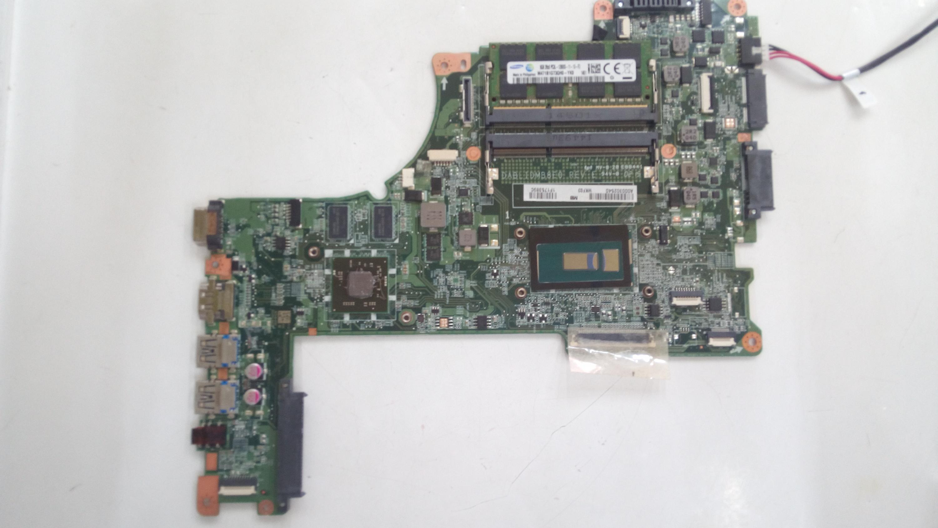

              Satellite L50-B-1NX
              What is the exact motherboard part number
              Attach big picture of your motherboard at least
              Remove heatsink and you will find below part number daxmbdfff rev e some numbers
              This crystal is xtal not shiny crystal
              Check images attached

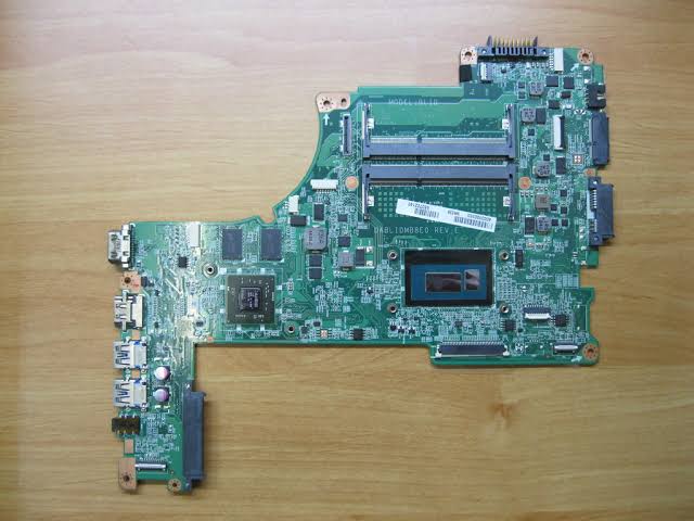

                Re: Satellite L50-B-1NX
                https://www.badcaps.net/forum/showthread.php?t=83487
                Found your motherboard and check crystal is at right side of big chip and of black colour rectangle shape Epson type body with 4 legs so it is safe and it is shown in above thread 32khz
                This one is I think 4 leg square type black colour Epson body
                14mhz , 40mhz I think

                  One is 32KHz the other is 25MHz.

                    Thank you for your input guys, the exact board is: da0blimb6f0 rev f
