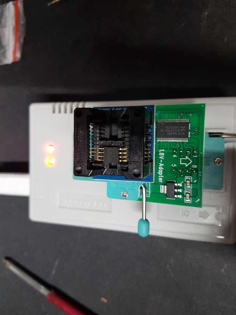

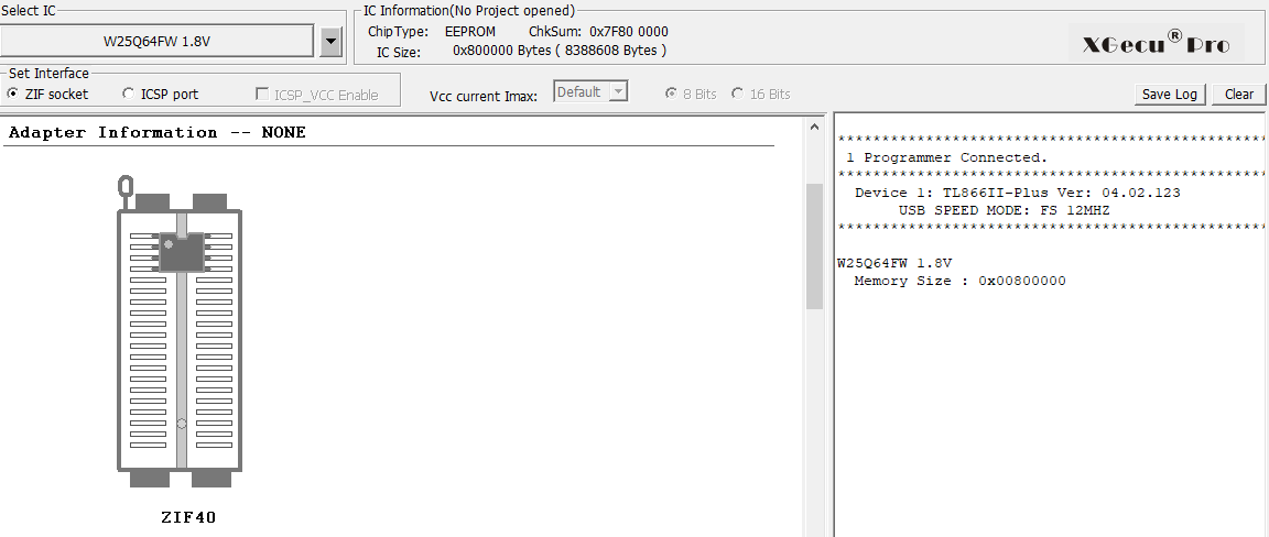

    I'm trying to reprogram a Winbond 25Q64FW, the programmer detects the chip type ok, it always gets check ID error though, if I untick check ID it reads nothing but 00 for the whole file, can't program, it's the latest software and firmware version.
    if I run the diagnostic the programmers passes all tests and is apparently working fine, I've checked I have the adapters in the right way, it wouldn't be able to detect the chip type if it wasn't correct, it can't read or program a chip because always check ID error. Same behavior with chip taken from HP mainboard and new unused chip.

    Hello
    I think the 1.8V adapter is not needed
      Re: XGecu TL866II plus Check ID error
      It works fine without the 1.8v adapter.
      Why do they even include a 1.8v adapter for, I wasn't game to try without it, was worried about frying the chip.
