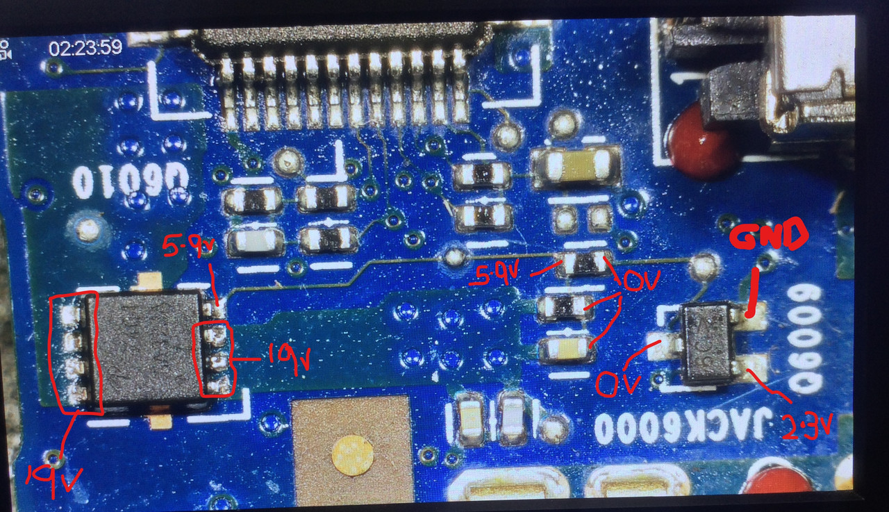

    Hi guys hope you all are fine.I have a HP Elitebook 8470P have me confused.Hoping you guys can help me figure it out.It draws 0.00 amps and does not power on at all.I notice something weird on the 19V rail tho.I have 3v and 5v on coils tho.I have no PGOOD Signal on Pin 23 of the 3V/5V TPS51123RGER IC. I have Vreg3 which is 2.4V and Vreg5 Which is 5V. I have voltage on the TRIP1 and TRIP2 lines which I was told that it should not have any voltage there.Or else the IC goes into Protection Mode.Not sure if that is true.But anyway I have attached 2 pictures.One showing the voltages in relation to the schematic.Can you guys check it for me and see if you can pick up anything wrong? I started from the first at ADP_EN to the 2nd mosfet I believe.
    And below I have attached a picture showing between Pin 4 of the mosfet and the resistor in yellow which in diode mode shows to be shorted. Please feel free to correct me if any mistakes. I am a newbie.I suspect that the Mosfet may be at fault.But am having a hard time finding an exact replacement for it.I might have to order that mosfet.But wanted to make sure that's actually the issue.Thanks

    Remove ''R6000'' and check impedance on both point to make sure which area has shorted
    once got the low impedance point inject voltage to find the short

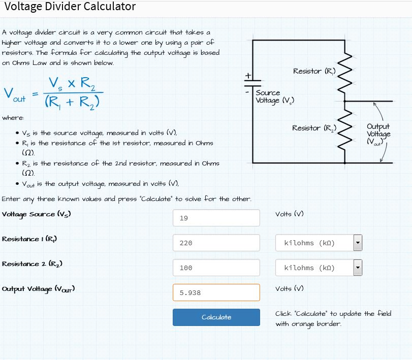

      Pin 4 is not short,you have 5.9V there which is the correct voltage,as its connected between 2 resistors which is called a voltage divider
      Vreg3 is too low.Do you have a DC power supply to inject voltage with
