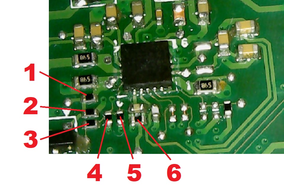

    somebody replaced the charging chip BQ25A, whilst soldering the resistors 1 to 6 became loose and he isn´t sure they are all in the right place.
    as i can´t find a schematic i am hoping somebody can measure the correct values.
    The board is a D15D REV:2.1
    Thanks for any help

    You can try to match the resistors in the typical application diagram of bq24725A datasheet.

      first of all thank you for responding.
      it might not be clear enough on the picture but the resistors 3 on the right side and resistors 4 and 5 on the top are all connected to pin 5 ACOK, the bottom of resistor 4 is connected to ground and the bottom of resistor 5 goes to pin 16 REGN.
      The left side of resistor 6 goes to pin 1 of a K72 (small signal mosfet)
      i have searched for a similar layout but found nothing near it.
      i swapped resistor 6 to get 2,6v so i don´t need the value of resistor 6 anymore.
      none of the 6 matched so i think he messed around and i´ll have to wait until somebody gets hands on the same board.

        I do have such a board which is working.
        If I don‘t have to unsolder anything I can measure. So must I unsolder?

          no you don´t have to unsolder. the values of each resistor should be enough ��

            Here are finally the measurements (raw values!):
            1. 1,981 Mega Ohm
            2. 1,033 mega Ohm
            3. 100 k Ohm
            4. 9,65 k Ohm
            5. 12,03 k Ohm
            6. 66,6 k Ohm
            I have measured a scrap board, but damage was in another area, so this values should be good.

              Re: Medion E6416/MD99540 Mainboard D15D REV:2.1
              Thank you so much
              I´ll give it a try and report how it goes
