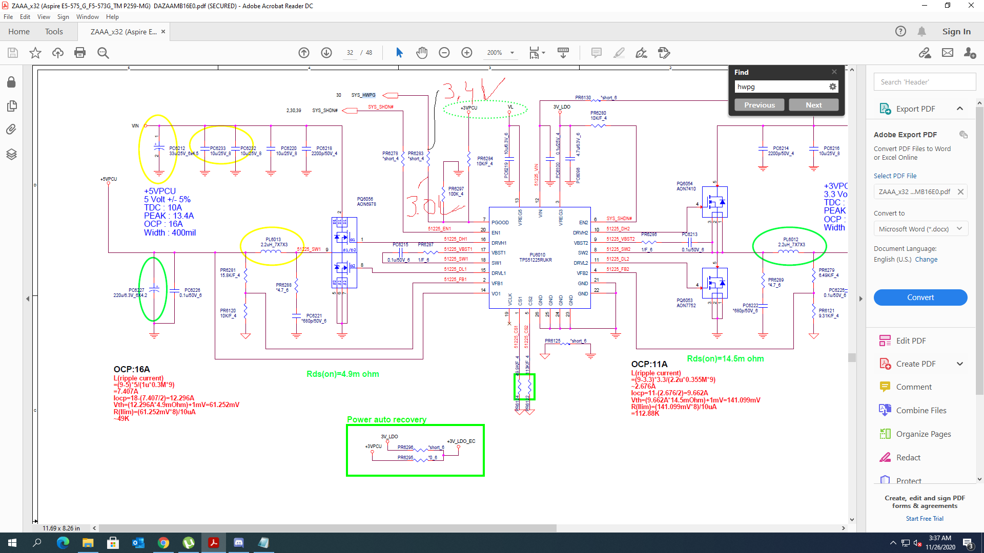

    hi . i have acer aspire E5-575 zaa2... . aptop does not turn on 19 v is ok. 3.3 v comes on the power button and the battery charge light turns on but does not turn on. I tried the bios I found on this forum but it does not work, do you have any idea what I can measure? And can i help mee .. this is shcematic

    @arber1232, make your posts more meaningful by giving as much information as possible. What have you done to solve??What measurements you did?? With no such information, you cant really expect advice from others. Start with Page 43 of schematic where a nicely laid out power sequence is given. Check what you are missing.Next check page 44 .

                coil are not 300 0hm. were somewhere at 0.17 ohm .. i have 5 v +3.3 v. nbswon # is ok i have 3.2 volts and when i press power button change voltage ie changes according to the button ... rsmrst # is present an i have 3.4 v and not change whwn i press power button. pltrst # i find in ENE but is 0 v ..and not change when i pres power button .. hwpg is present in tps51225 in pin 7 ,, 3.0 v and in ENE is zero in pin 22 .. dnbswon # is 3,4 v but not change when i press power button

                  hwpg signal En1 i have 3.2 v. En2 3.2 V

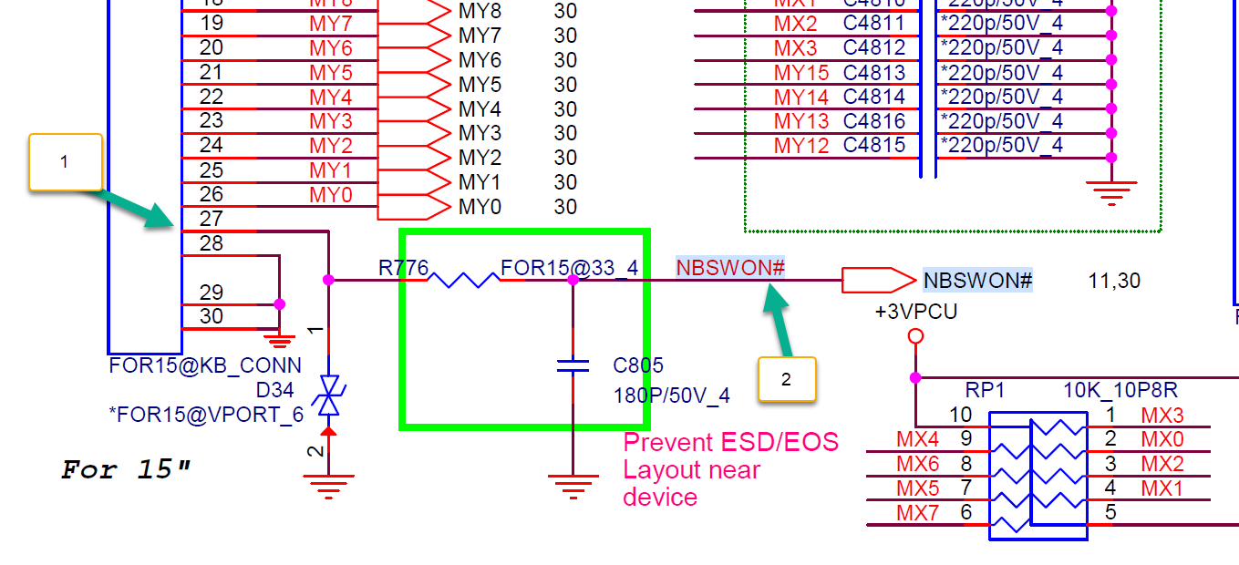

                          MY NBSWON# voltage 3.3V DNBSWON# 2.6V When Press Powerkey RSMRST# Voltage not out ...pls give me a solution
                          • mon2
                            • Dec 2019
                            • 14360
                            Re: neeed help plz aspire E5-575 zaa2
                            See attached.
                            Meter in DC volts setting.
                            Red meter probe to pin # 27. Black meter probe to ground.
                            Measure the voltage to ground @ pin #27 with the power switch open on the keyboard.
                            What is the voltage ?
                            Then press the power switch on the keyboard.
