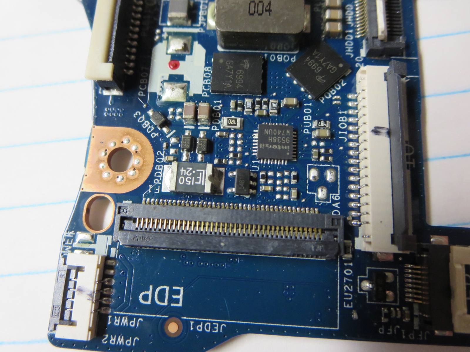

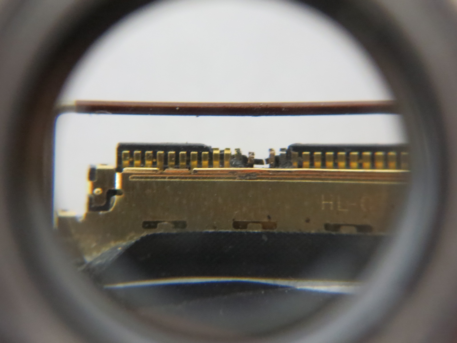

    Laptop Dell Inspiron 15, 5570, LCD panel damaged, no backlight, external monitor attached works fine… removed LCD and the 30 pin connector was burned at +BL_PWR. Replaced with new display cable and brand new (similar) LCD panel but same issue. Run the Dell diagnostic test and get the error “LCD cable not connected “. No visible burned components on MB (fuse F1 is ok). Checked the voltage at motherboard eDP connector found the +19VB rail (+DCBAT_LCD) is only 13.1V powered on charger or battery. Is that normal?

      Thanks mcplslg123 for your reply... what other voltages should I check at that eDP connector ? The +LCDVCC (at U1, pin1) is 3.1V ... beside backlight missing, also I don't notice any video signal on the panel ...the replacement is LM156LF5_Panda screen vs original AOU B156HAN01.2

        Re: Laptop Dell Inspiron 15, 5570, LCD issue
        +LCDVDD, LCD_BRIGHTNESS, BLON_OUT_C,DCBAT_LCD-These are responsible for backlit issues. Since the error message is lcd panel not connected , i doubt you have missing EDP_TX0/TX1 lines.U1,Pin4-LCDVDD_EN missing?? First confirm these measurements and be careful while measuring.
              So, the voltages at eDP connector are:
              pin7,8, +LCDVDD = 2.95V
              pin27, LCD_BRIGHTNESS =3.20V
              pin28, BLON_OUT_C =3.10V
              pin1,4 DCBAT_LCD=13.11V
              and pin4 U1=3.39V
              My guess is the recommend (Panda) screen is not compatible with original AOU !
              However I did boot up from USB Ubuntu with this new screen connected and "build in display" was listed on control panel with 1920x1080 resolution, but again no video and no backlight!
                With the measurements above,you should have got backlit on even if no data on screen. You are not even having backlit-correct?? If so, doubt goes towards the panel itself being either bad or incompatible.
