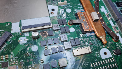

    Lenovo IdeaPad 330S-15ARR MOSFET GATE Location PQ5907
    Hi all, As seen in the picture attached, my MOSFET has blown to Mars. I can fix it if I can find out where the Gate pin connects to on MOSFET PQ5907. Thanks!
    Motherboard: nm-b681

    Re: Lenovo IdeaPad 330S-15ARR MOSFET GATE Location PQ5907
    are you sure this is 330s model ?
    • tomodachi
      • Apr 2012
      • 610
      • Turkey
      schematic says gate pin of PQ5907 connects to pin 31 of PU5901 IC
          Hey buddy, I failed miserably on this one. Thanks for the help.
