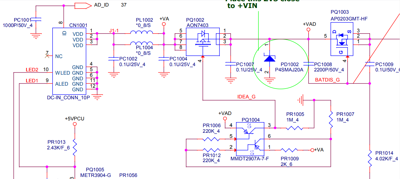

    HP OMEN AX236TX DAG35DMBAD0 rev:D NO power no light
    HP OMEN AX236TX DAG35DMBAD0 rev NO power no light.
    Hi ,
    This is another laptop with same problem in which there is no Power to the system while when checked for first two mosfet switching (19v rail area).
    I am getting 18.2 volts at the gate of first mosfet PQ1002 and it is a P-channel mosfet.
    PQ1002 first mosfet:
    pins 1,2,3=19volts , pin4=18.2 volts , pin5,6,7,8=19volts
    PQ1002 gate is controlled by PQ1004 voltage divider circuit , if we calculate for voltage at gate of PQ1002 it should be around 15volts (due resistors 220K,1M) but i am getting 18 volts.
    PQ1003 second mosfet:
    pin 1 ,2 ,3=0 volts , pin 4= 0 ,

    Re: HP OMEN AX236TX DAG35DMBAD0 rev NO power no light
    PQ1002 gate voltage is correct. 1M & 220K are not voltage divider circuit. Read the schematic carefully and try to understand it. You are not getting any voltage on PQ1003 pin 1,2,3 and thats your +PRWSRC-means 19V rail. What is the impedance on pin 1-2-3 of PQ1003?? Its likely to be shorted to gnd.
      Thanks for the input but this PNP Bjt dual array is there for some reason.
        PQ1004 datasheet - https://cdn.badcaps-static.com/pdfs/...6fb3e5c604.pdf
        One area that you can study with a P channel mosfet is the Gate Threshold Voltage ,which can be very misleading. https://cdn.badcaps-static.com/pdfs/...c59cbfa3b0.pdf
        With no power attached chek PQ1002 in Ohms ,
        red lead on drain,black lead on source. Ohms =
        Black lead on source,red lead on drain. Ohms =
          PQ1002
          with only cmos cell
          red lead on drain,black lead on source. Ohms = display OL
          Black lead on source,red lead on drain. Ohms = display OL
          PQ1003
          red lead on drain,black lead on source. Ohms = 2.2
          Black lead on source,red lead on drain. Ohms = 2.2
          red on pin5 and black on pin4 gate = 195 for 1 sec than reaches L
                Just to complete this thread
                I successfully repaired my laptop ,vccsa coil was having liquid damage via hp omen SD card slot as it is very close, two caps were shorted and vccsa is attached to CPU therefore I was not getting signal.
                Replaced two caps and pq4012 problem solved
