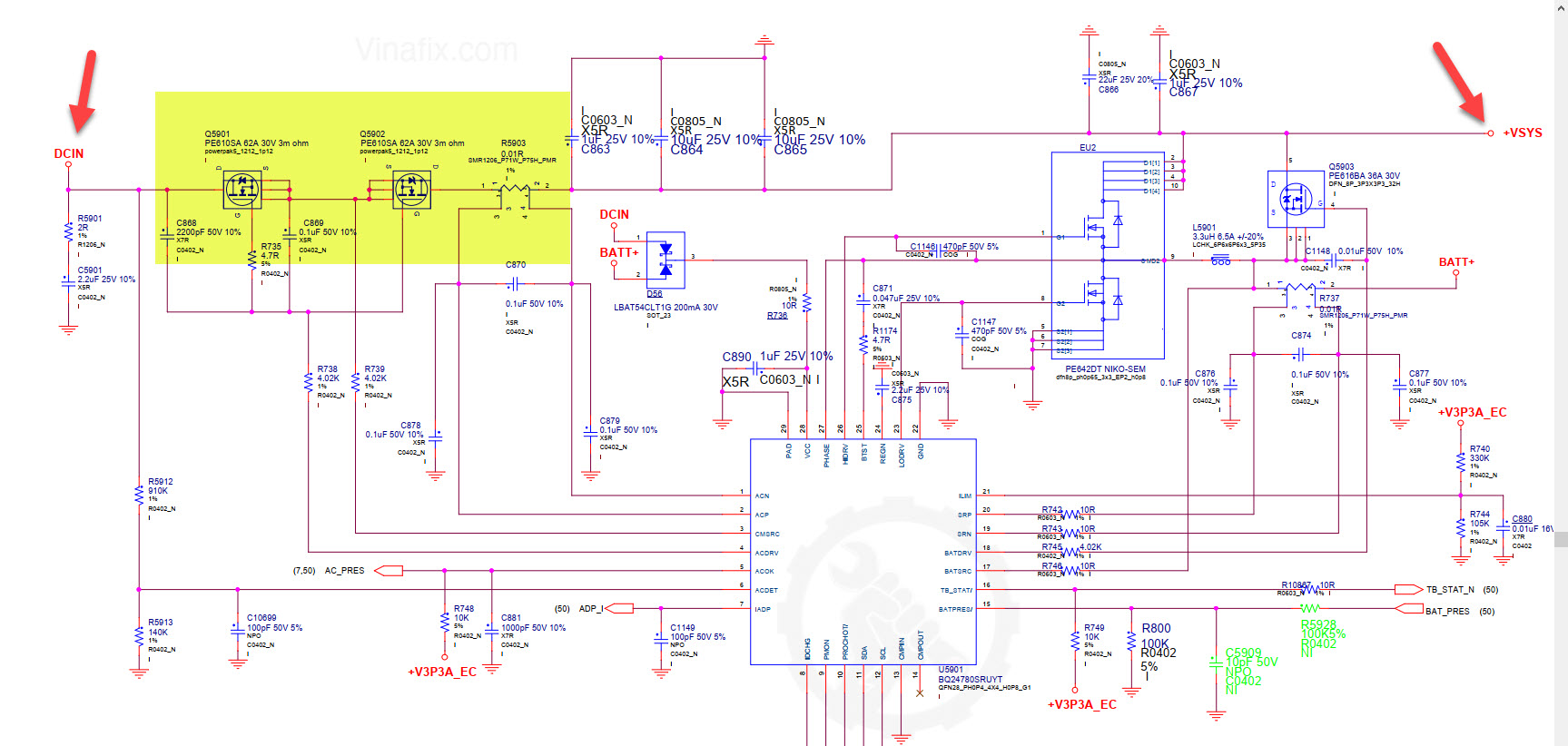

                • menshawy
                  • Aug 2013
                  • 400
                  • egypt
                  Re: Lenovo Ideapad 330S-15IKB dead
                  This schematics can be useful
                  • mon2
                    • Dec 2019
                    • 14200
                    Thanks @menshawy. Appreciated.
                    See attached. Review the highlighted mosfets and measure the voltage on each of the pins:
                    source (1-2-3)
                    gate (4)
                    drain (5-6-7-8)
                    for the 2 x DCin mosfets. Need to know if the mosfets are being enabled or not and if the voltage is reaching the main power rail of the logic board.
