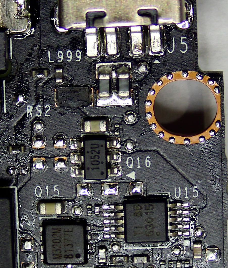

Help id sot23-6 chip with marking 1052U
  • m3g4tr0n
    • Aug 2011
    • 88
    marking on the chip 1052U
    thanks
    • 20884
    Re: Help id sot23-6 chip with marking 1052U
    What motherboard are you trying to repair ?
    • m3g4tr0n
      • Aug 2011
      • 88

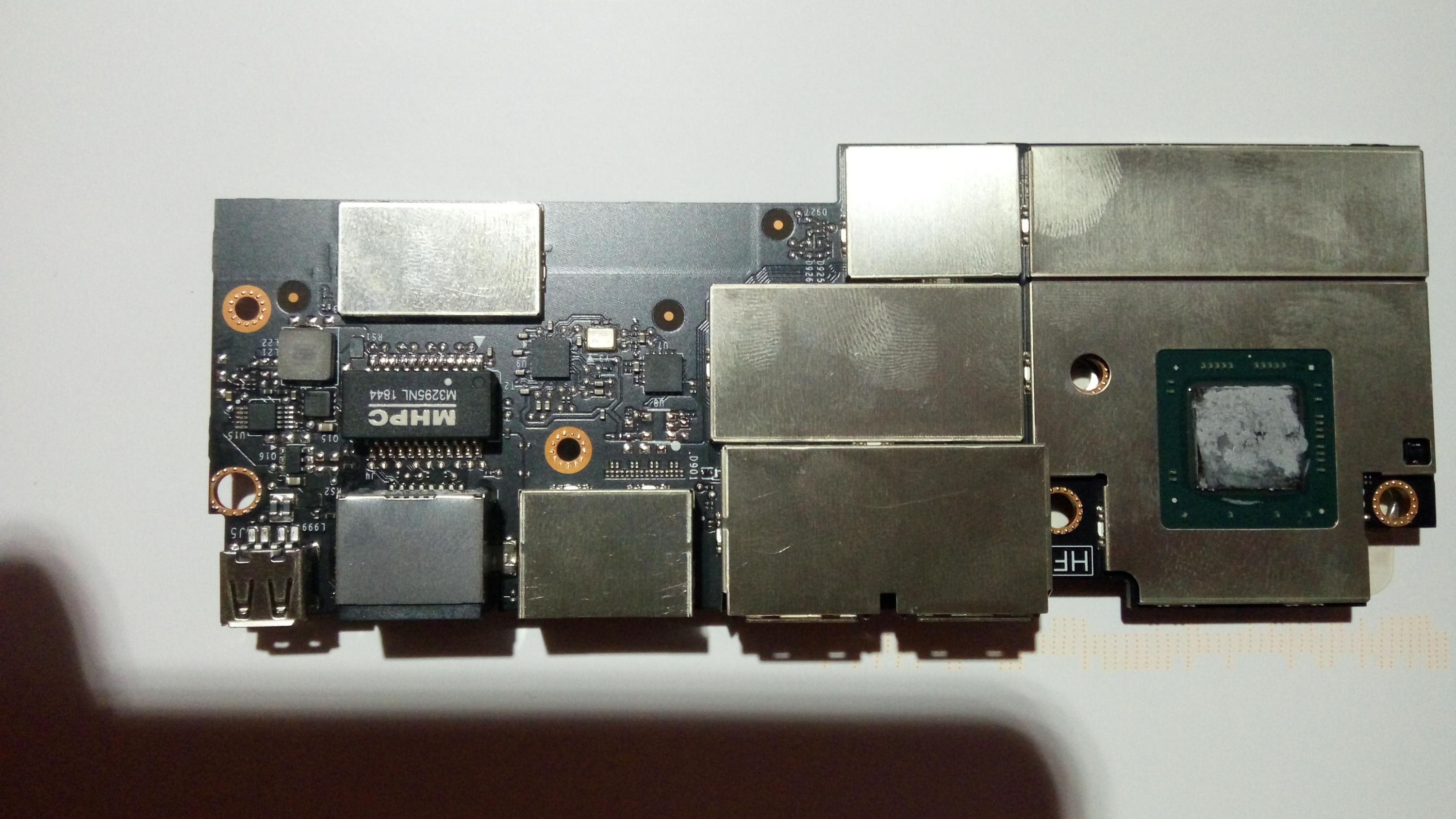

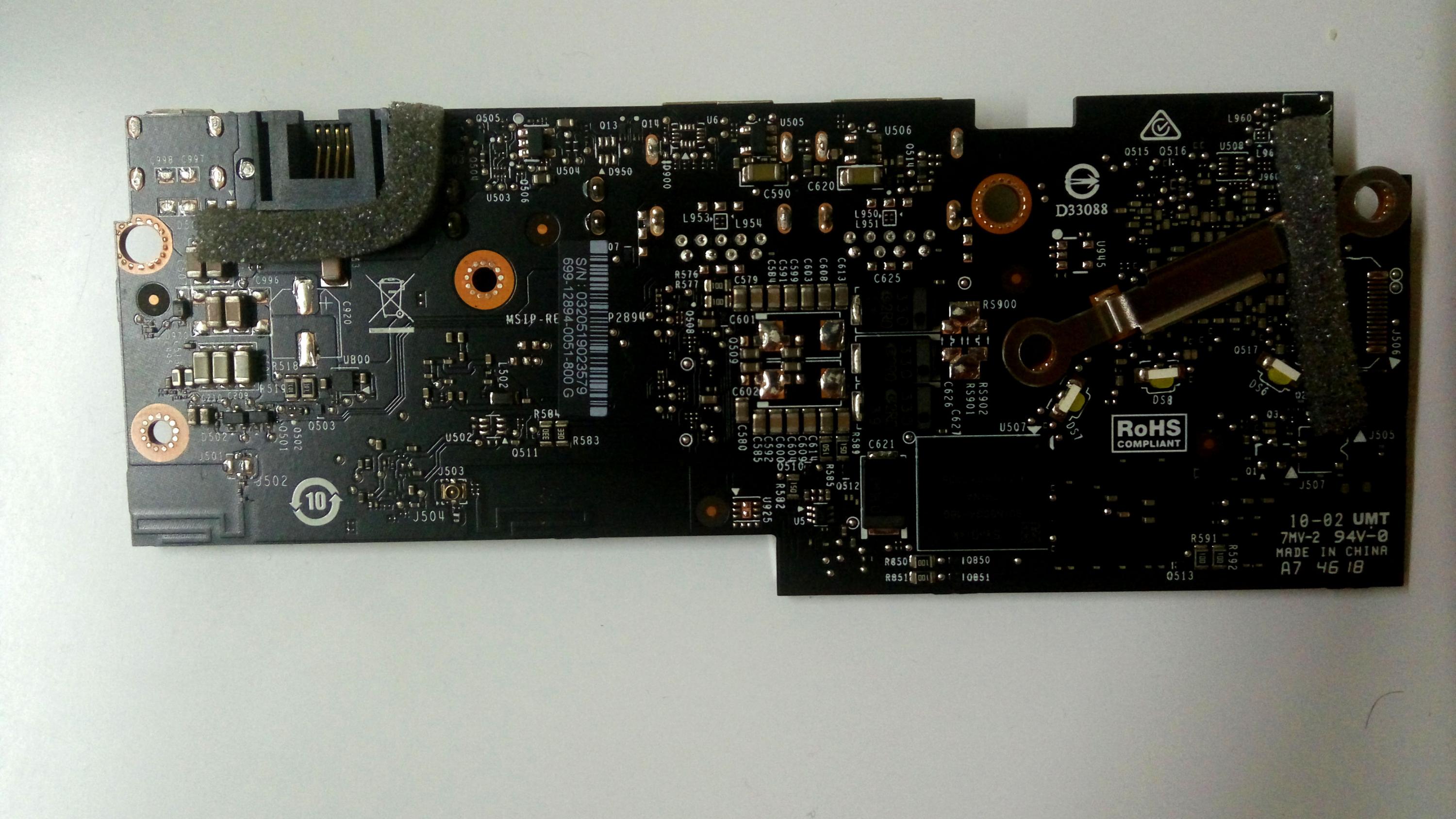

      Nvidia Shield TV 2017
      • m3g4tr0n
        • Aug 2011
        • 88
        pics of board attached. J5 is the DC connector (19V/2.1A)
          Maybe a TSM1052
