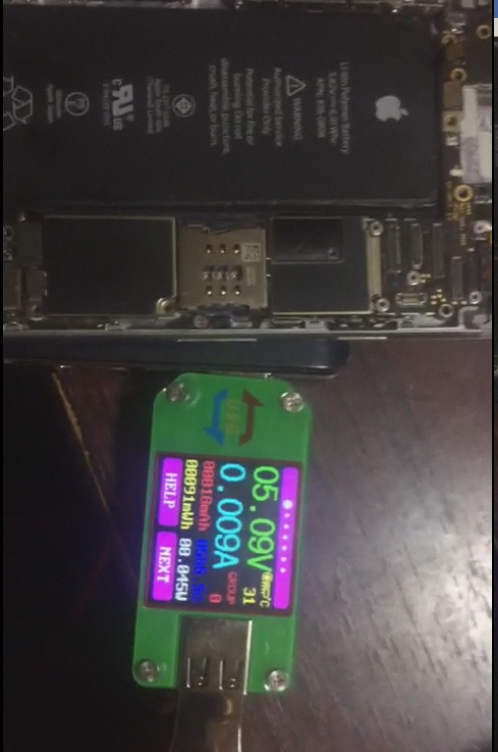

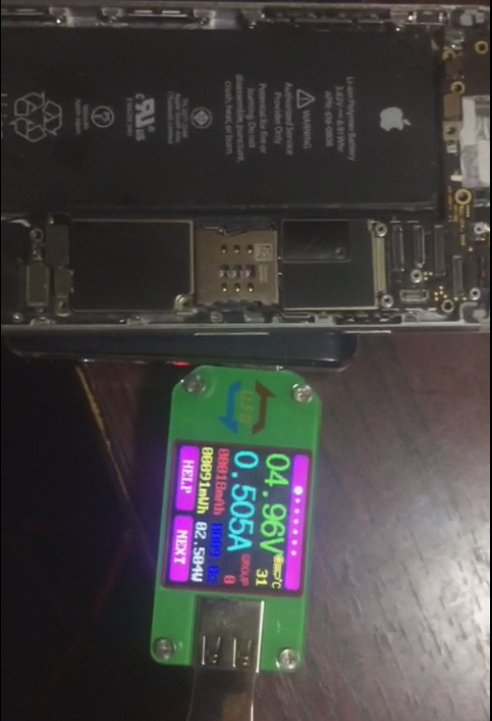

    Dear All
    My iphone 6 is dead and not charging. I never diagnose mobile phones in my life before but would like to do this time and therefore need help. At initial I found this
    1. Battery is OK
    2. Using USB power meter I found that mobile is drawing .5 amp and then went to zero and repeat this pattern. at battery terminal there is no short.
    What should be my next step?

      Re: Iphone 6 Dead - Diagnosis
      From all that I have read and watched. Charging port and tristar are the usual suspects, it's easy to check the charging port, just buy a replacement, connect it to the board and plug in the charger, you don't need to "install" it to test it.
