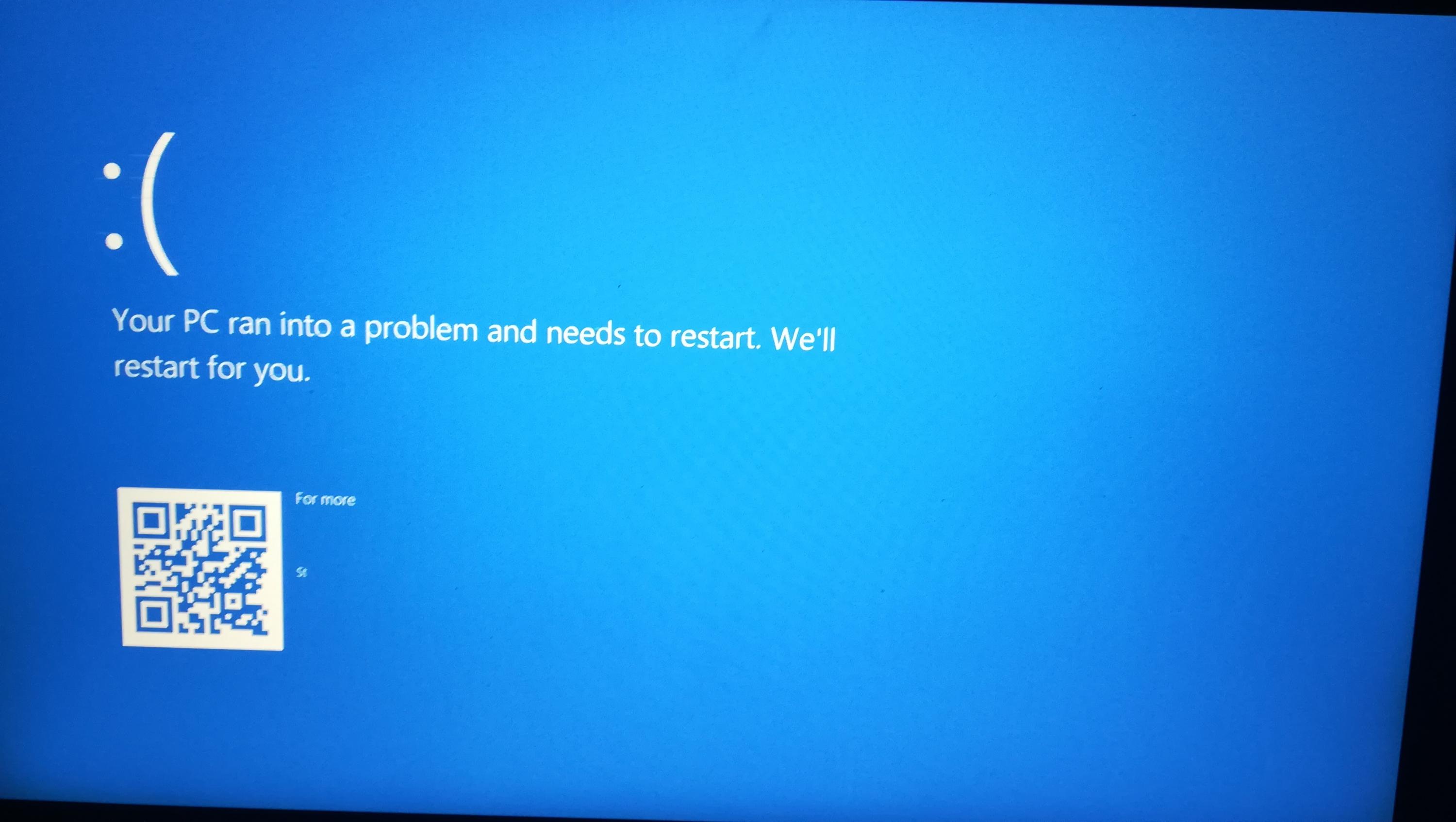

    hp envy 17 crashes on startup
    hello, as soon as this pc starts up, it crashes, I updated the bios but it doesn't change, could it be a graphics driver problem or an hrdware failure on the board?
  • peste
    • Dec 2016
    • 12973
    • ROMANIA
    Re: hp envy 17 crashes on startup
    start the laptop without keyboard, wifi, dvd, etc ... see if it still crashes ... use a HDD with WIN that you know are ok ..
    • poweron
      • May 2019
      • 371
      • italy
      I disconnected wifi, keyboard, dvd, I tried one ram bank at a time but unfortunately it still crashes
      • Duranitron
        • Jul 2014
        • 544
        • Philippines
        replace the hard drive
        Never stop LEARNING because life never stops TEACHING!
        • mcplslg123
          • Jun 2015
          • 7262
          • india
          It could be even SOC. faced similar issue with Asus X555LD rev 3.6 which has onboard ram. I disabled the onboard ram, used known good ram stick, even disabled the dedicated gpu but it always ended with similar error the way you are facing. In my cases it was rotten tracks under soc. Rebuilt the tracks, reballed the same soc and job done perfectly. May not be the case here but worth investigating.
          • poweron
            • May 2019
            • 371
            • italy
            I removed the smd hd, I tried other ram, I installed a hd with a working system, I tried with a bootable key with w10, I updated the bios from F50 to F52 from the HP site, all without obtaining results. can't disable the gpu
            • poweron
              • May 2019
              • 371
              • italy
              it is likely that a reballing of the gpu or cpu is to be done, but I do not have the necessary equipment, I believe at this point I will have to buy a new or used card
