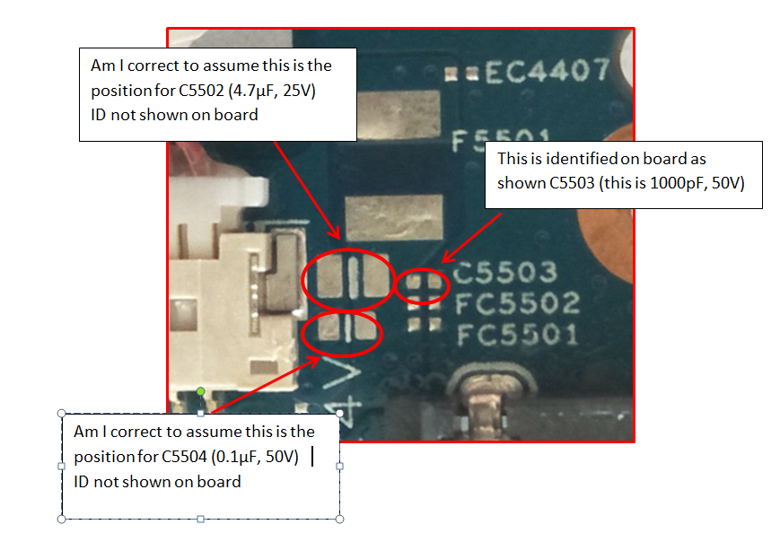

    I need to replace 3 capacitors and fuse on my motherboard but can not find where to source these.
    I have pretty much exhausted all possible avenues in Australia i.e Jaycar, Isas, leading edge, even an Acer authorized parts reseller.
    Looks like I need to source from abroad.
    The laptop is an Aspire Acer V Nitro
    Motherboard: Uranus_KLS 16858-1
    Laptop model VN7-593G_-73CP

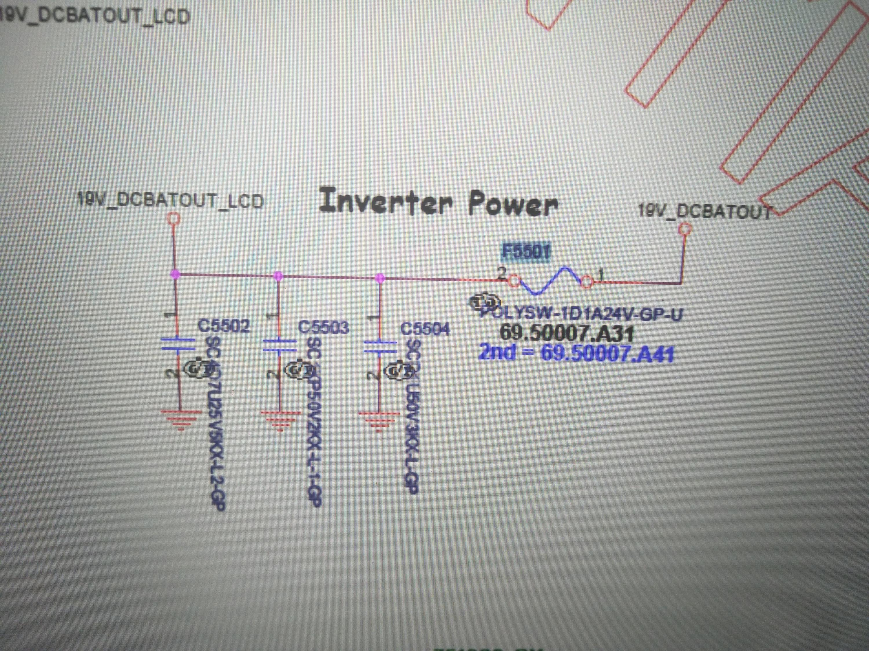

    Parts required are:
    Capacitor C5502, SC4D7U25V5KX-L2-GP
    Capacitor C5503, SC1KP50V2KX-L-1-GP
    Capacitor C5504, SCD1U50V3KX-L-GP
    Fuse F5501, POLYSW-1D1A24V-GP-U
    The above components are identified from area of schematic as shown attached:
    Hope someone can point me in right direction
    Cheers

    Re: Acer Nitro V motherboard caps and fuse required
    u can get them on digikey ofcourse.
    c5502 sc 4 dot 7 u 25volt 5kx 5kx maybe tollerance, but package ? 4.7uf 25 volt
    c5503 1000pf 50 volt 2kx
    c5504 .1uf 50volt 3kx
    fuse 1.1 A 24 volt

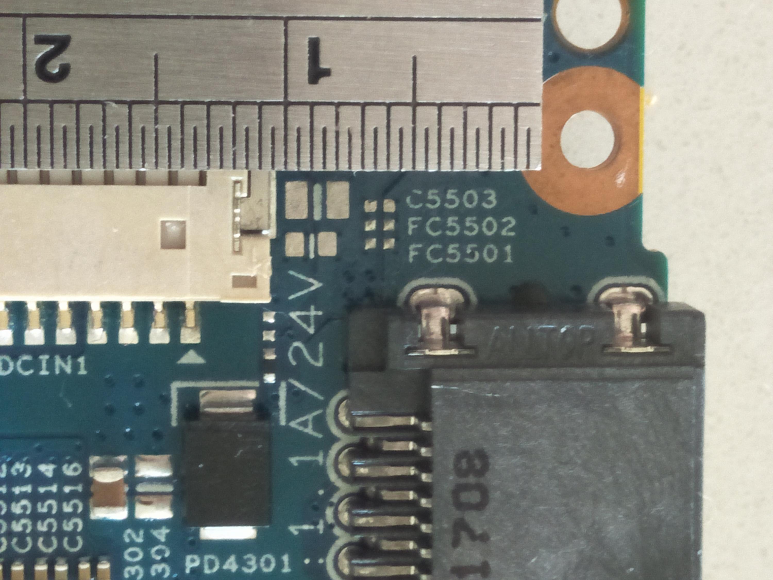

                Just a question before I try to order capacitors.
                The repair shop i used couldnt give me back the capacitors they took off, so I had to measure the soldering area on the board to try and get the correct size capacitor.
                Am i correct to assume the larger the soldering area on the board the larger the capacitor?
                The reason I ask this is only one of the capacitors is identified on the board.
                So assuming the larger 4.7uF goes on the larger solder area on the board the capacitor size would be 2.0x1.2mm (package 2012) solder area 2.5x1.5mm
                0.1uF capacitor size 1.6x0.8mm (package 1608) solder area 2.0 x 1.0mm
                1000pF capacitor size 1.0x0.5mm (package 1005) solder area 1.2 x 0.5mm
                The above is so I can get the correct package size,
                Is my assumption correct?
                Cheers
                • dellxps15
                  • Feb 2014
                  • 1588
                  • italy
                  c5503 is 0402 package
                  c5504 is 0603
                  c5502 is 0805
                  for my opinion

                    On my first post..
                    Can someone tell me what the purpose is for these three capacitors and whether I can run the laptop without them
