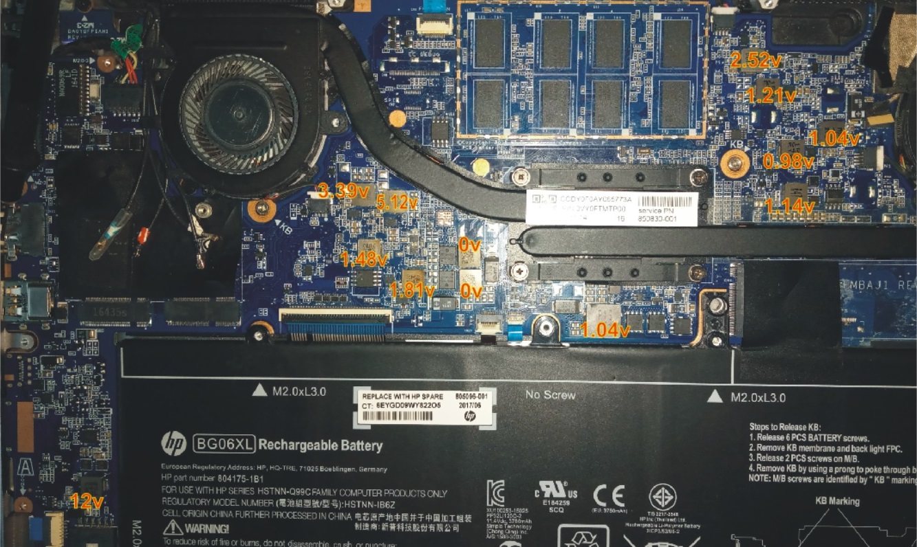

    Hi everyone....
    please i need help; I have an HP Elitebook Folio 1040 g3 which was damaged by water.... I've replaced the 5VPCU regulator IC [Power IC] which shorted out due to the water damage.
    Now, it turns on, blinks the capslock/numlock light 5 times then restarts and repeats the blink process again and does that continuously.
    According to HP site, the 5 blinks is a System Board Failure.
    Who has any idea on how it can be fixed should PLEASE help out... No component on the board has labels, so it is hard to trace using Schematics

    What are the missing voltage on the coils ? Is your +3/5/1.8VPCU are fine? Follow the page 67 power block & update what are the missing voltage

      Okay, thanks for the prompt reply, +3/5/1.8VPCU are okay...
      only 2 coils have missing voltages

            Coils PL36 and PL38 have NO volts (0v).
            Which makes +VCC_GT absent

              check the Resistence to GND on PL38/36 , remove PL12 & power the MB to see if it's power up , check PQ16/17 check PU16/17 for any short & voltage of all pins PU16/17 ?

                Resistance to ground on PL36/38 = 4.6 ohms
                Without PL12, the problem is still the same, 5 blinks .....

                  No shorts found so far.......
                  PQ16/17 ....... okay
                  PU16
                  Pin 1 = 10.70 [Vin]
                  Pin 2 = 0v [GND]
                  Pin 3 = 1.3v [suspicious]
                  Pin 4 = 0v [NC]
                  Pin 5 = 5.12v
                  Pin 6 = 5.12v
                  Pin 7 = 5.12v
                  Pin 8 = 8.53v
                  Pin 9 = 3.53v
                  Pin 10 = 0v
                  Pin 11 = 2.43v
                  Pin 12 = 4.5v

                    check DRVON on EN on PU22 than live is ok for me ! pin 2 is not GND PWM1_2ph so test again Ohms , PIN 6 is GND so check again

                              Yep PG is your problem how did miss it find out PR302 PR297 PR67 PR180 for any short or leak if ok remove PR302 & see if PG is coming back

                                PR302 & PR297 are short pads
                                PR67 = 2.58k ohms (3.3k ohms stated in schematics)
                                After removing PR302, PG is still 1.3v. But after comparing it with another working board (1040 g1), the 1.3v seems to be okay......

                                  what is the voltage on PG PU14 pin3 ? on your mob & 1040 G1 ? check what are rest PG missing

                                    PU14 Pin 3 [PG] = 3.06v [1040 g3]
                                    I haven't seen a schematic for 1040 g1. I want to try and search for a schematic of another motherboard using same power IC (3v_5v Regulator) as 1040 g1
