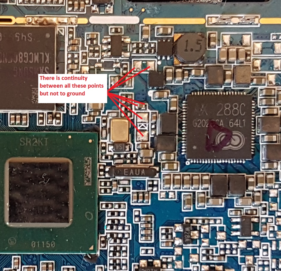

    Hi guys,
    I have an issue with Lenovo Ideapad MIIX 310-10ICR 80SG (M1029CWP) that won't turn on. The problem happened after I removed the battery and shorted its connection on the motherboard in order to drain residual voltage.
    Now, when I plug the charger the LED starts "red" and goes to "solid amber" after 3 or 5 seconds even though the battery is not charged yet.
    I opened it and checked the voltage. I have 1.8v on the BIOS pin after pressing the power button.
    I checked for short to ground but nothing.
    I flashed a new version of the bios using a programmer, but still nothing.
    the odd thing is that there is continuity between the two sides of a tiny capacitor near the PMIC but no short to ground. I desoldered and tested the Capacitor and found it good. Please refer to attached photo.
    Could you please help me?
    Thank you.

    Re: Lenovo Ideapad MIIX 310-10ICR won't turn on !
    hi naonao,
    continuity you're measuring is maybe due to pcb traces return. You may have to take a look to schematic or to pmic datasheets at least.
      continuity of 0 ohm? maybe there's a shorted cap.
        Originally posted by Moustique
        hi naonao,
        Thank you.
        I am considering replacing the PMIC and see what it will give when I get one AXP288C.
          Did you already solved the problem?
          I measured the path resistance on those pads( from your picture) and there is NOT any continuity to ground ( on my tablet)
