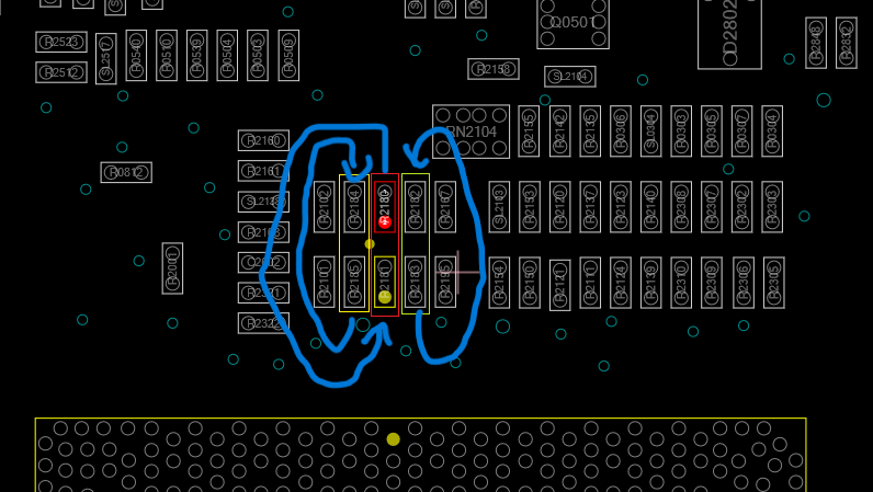

                Change these tree resistor marked by color

                  Re: ASUS X555UJ REV 2.0 onboard ram disable help me pls
                  thank you test ok ...

                      I'm interested. I've shifted those resistors how explained in the pic. But i must desolder the ram modules too? Now, doesn't work.
                      Thank you.
                            is this correct? i tried this i switched the 3 resistors in that position and it dioesn't work.
                            i shifted from line to arrow.
                            and do i still need to remove the onboard ram?
