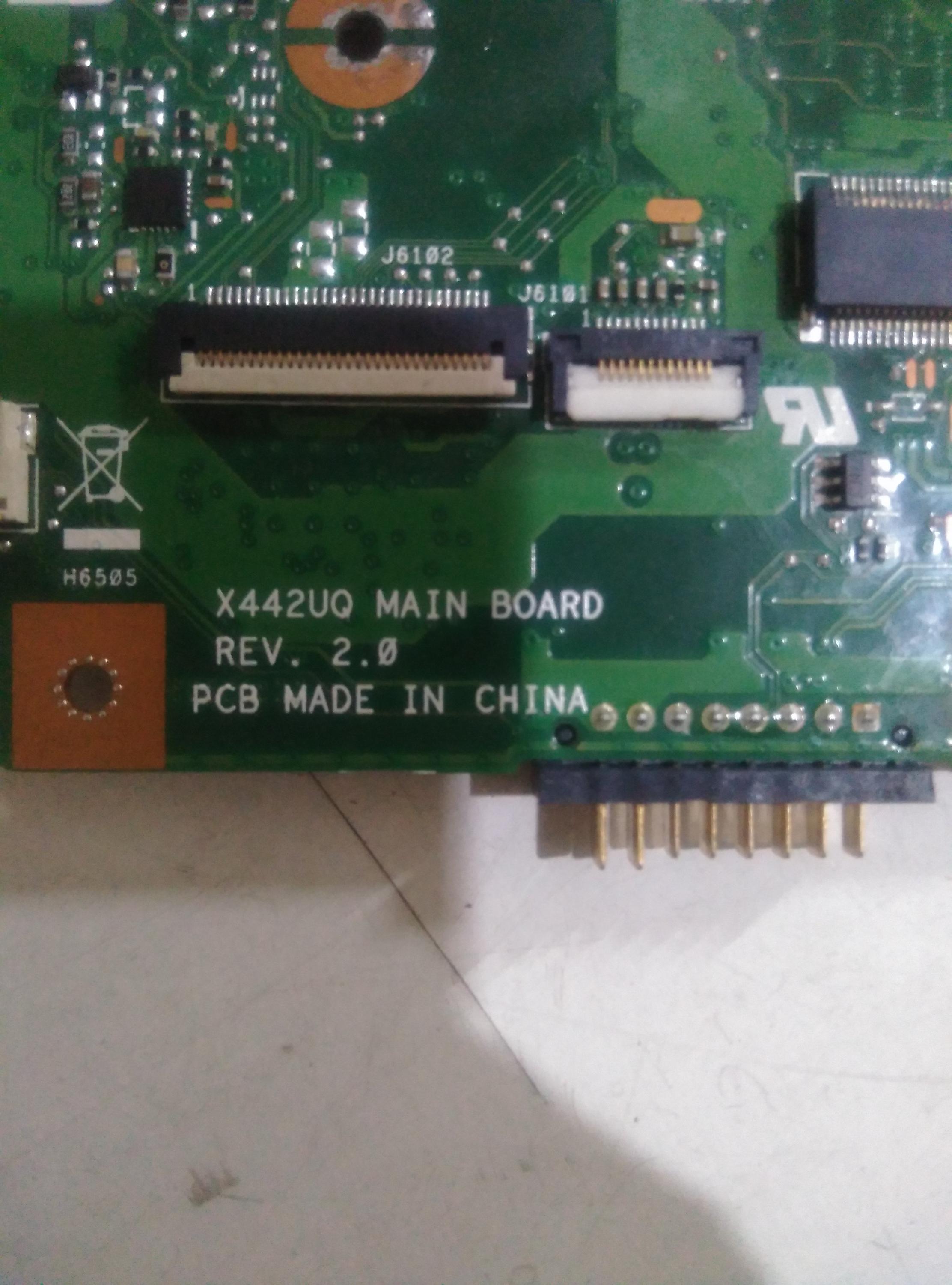

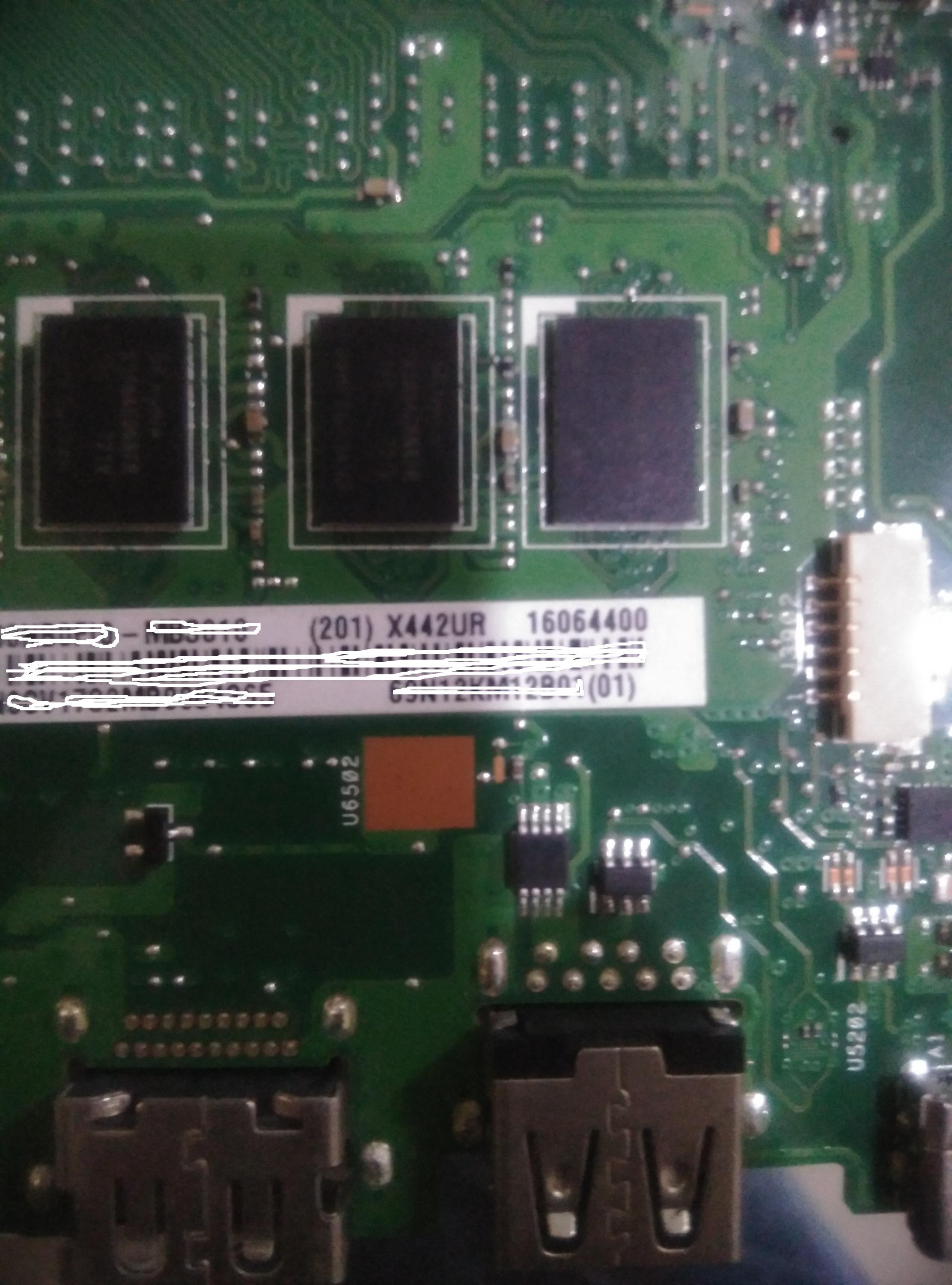

                Yes, but is it silkscreened on the board or on the sticker. Post the part number on the sticker if it has one,and a picture
                • kodox
                  • Jul 2017
                  • 327
                  • Indonesia
                  Re: ASUS A442UR No CPU VCORE
                  i've just noticed, the sticker and the silkscreen is different
                    • 21100
                    Yes thats what i wanted to know.If you look at the bios downloads on the asus support site it offers 2 different ones for the X442UR and X442URR ,we got the bios "X442UR" name from your bios backup anyway.Its always worth checking as its easy to get different bios mixed up with asus boards.
