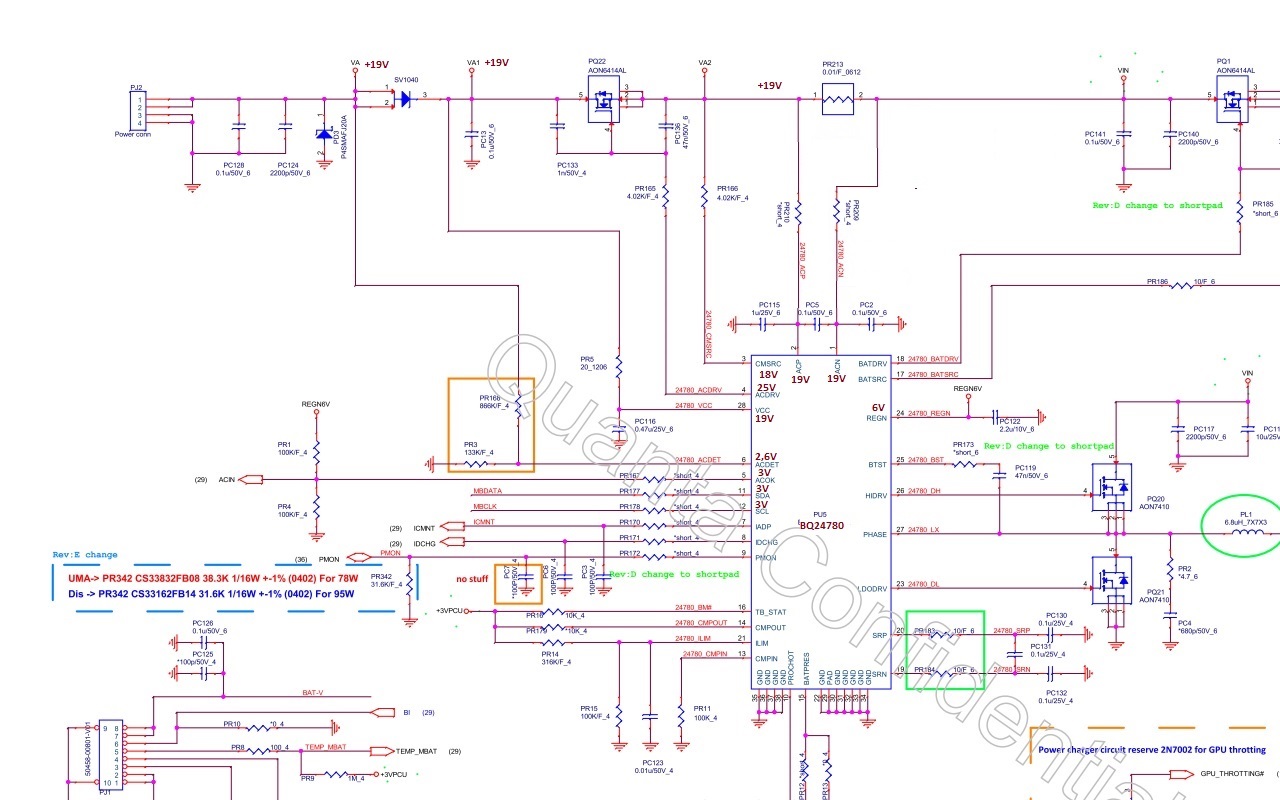

    Hi good day to all the problem of this board is shorted I already remove the "PD8, PQ22, PR213" and I just make a jumper from pj2 connector Vin to PR213 pad, now the battery is not working
    Battery connected Checking voltage on pr169 reading is 800mill volt
    PC118- 19V
    PU5
    PIN 18- 800MILI VOLT
    PIN3 -18V
    PIN4- 18V
    PIN 28- 18V
    PIN 6- 2.5V
    PIN5-2.5V
    PIN 11- 2.7V
    PIN12- 3.2V
    PIN 7 -600MILIVOLT
    PIN 8 -3.3V
    PIN 9 - 3V
    PIN27- 0V
    PIN17- 800MV
    DA0ZRWMB6G0 REV G
    Idont know whats wrong on this unit
    schematic and boardview pdf is attached

    It wont work. Why you have not replaced those components?? Dont you see PQ22,pin4 is your ACDRV. Without the gate opening of this fet, charging will be disabled.Replace all those removed components first and then observe.

        I arlredy tried to change the PQ22 but it work around 5 mins then it got broken Again there is no shorted on board but why the msofet get damage?

          it will just work for a while the nturn off i already tried 3 pq22 a0n6414al but it just work for a minute then dead

            iss it the charger ic is faulty?

              Yes, charging ic can be faulty.

                  I tried to cahnge the charger ic but its giving me 3v at PR213

                    If there is no short circuit after PR213 and the BQ24780 chip is properly soldered, the operating voltages should be as in the diagram. PR5 resistance 20oHm is important.
