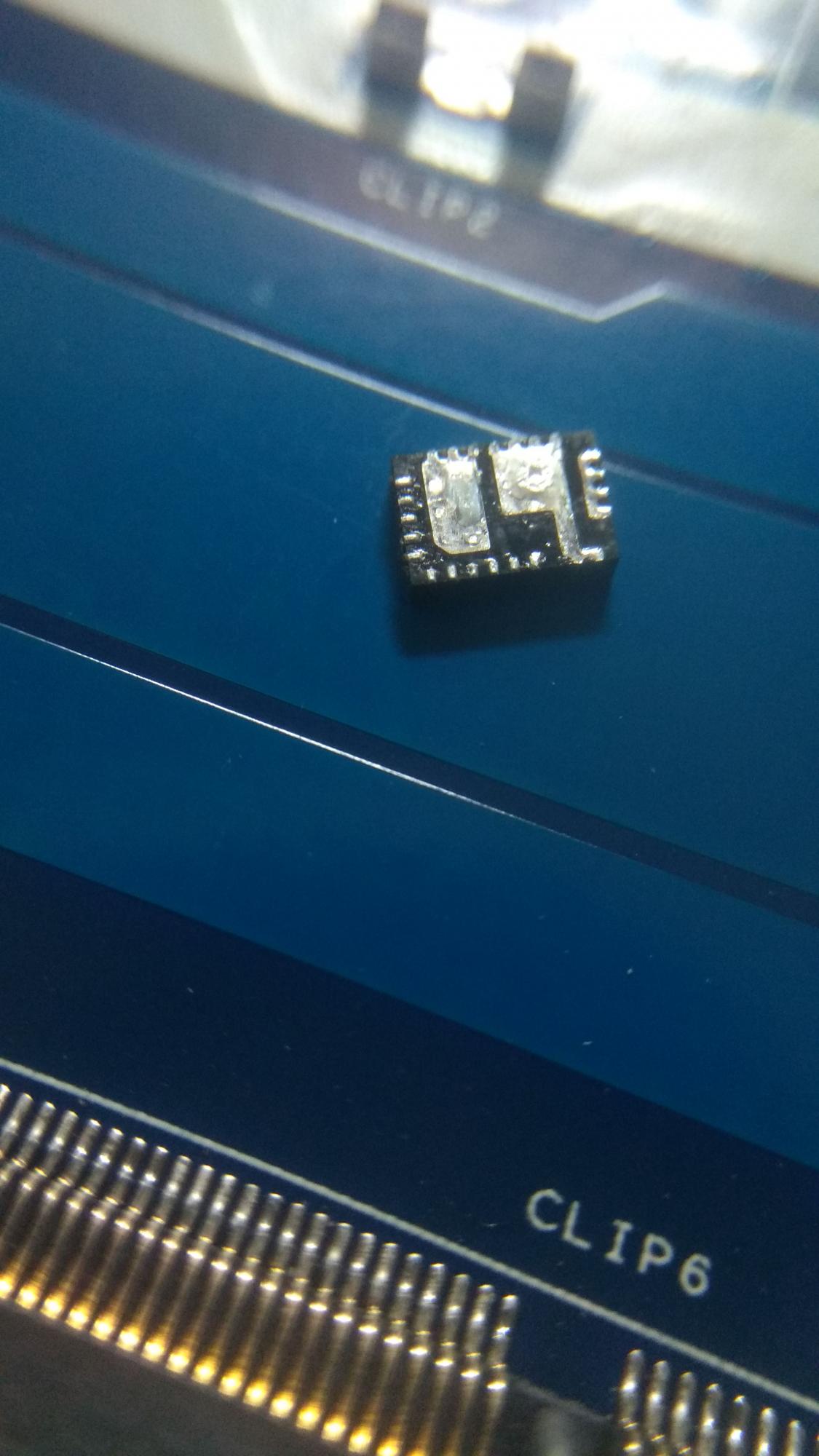

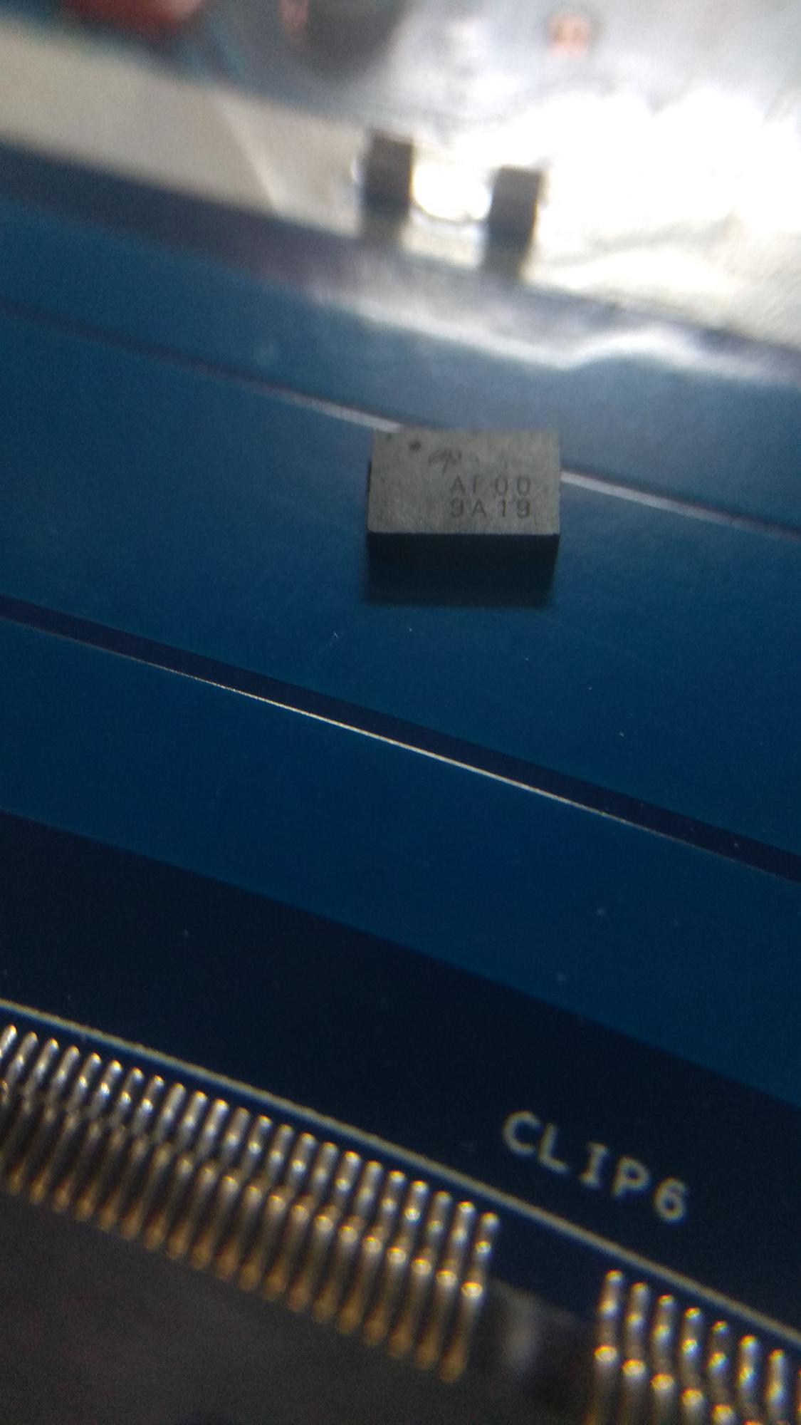

    Hello friends
    I have hp laptop
    Mb part no. Chewbacca 14 kbl r Uma
    17879- 1b
    In this motherboard 19v rail are short I have found one MOSFET that is responsible for shorting 19v to ground
    But I am unable to identify this number
    Any master can help to provide its datasheet
    I appreciate ur help

    Re: Help to identified this component
    Could be this ic:
    https://cdn.badcaps-static.com/pdfs/...5a62996cca.pdf
    • mitu_sharma
      • Jul 2015
      • 182
      • india
      i already mach this ic but both are not same
      anyway thank u so much mcplslg123
        • 21885
        Could be a AOZ5547QI .Marking code is the same AF00
        https://cdn.badcaps-static.com/pdfs/...eae197fc79.pdf
        https://cdn.badcaps-static.com/pdfs/...d6ddf9124a.pdf
        • mitu_sharma
          • Jul 2015
          • 182
          • india
          i am so happy thank u sooooo much SMDFlea
