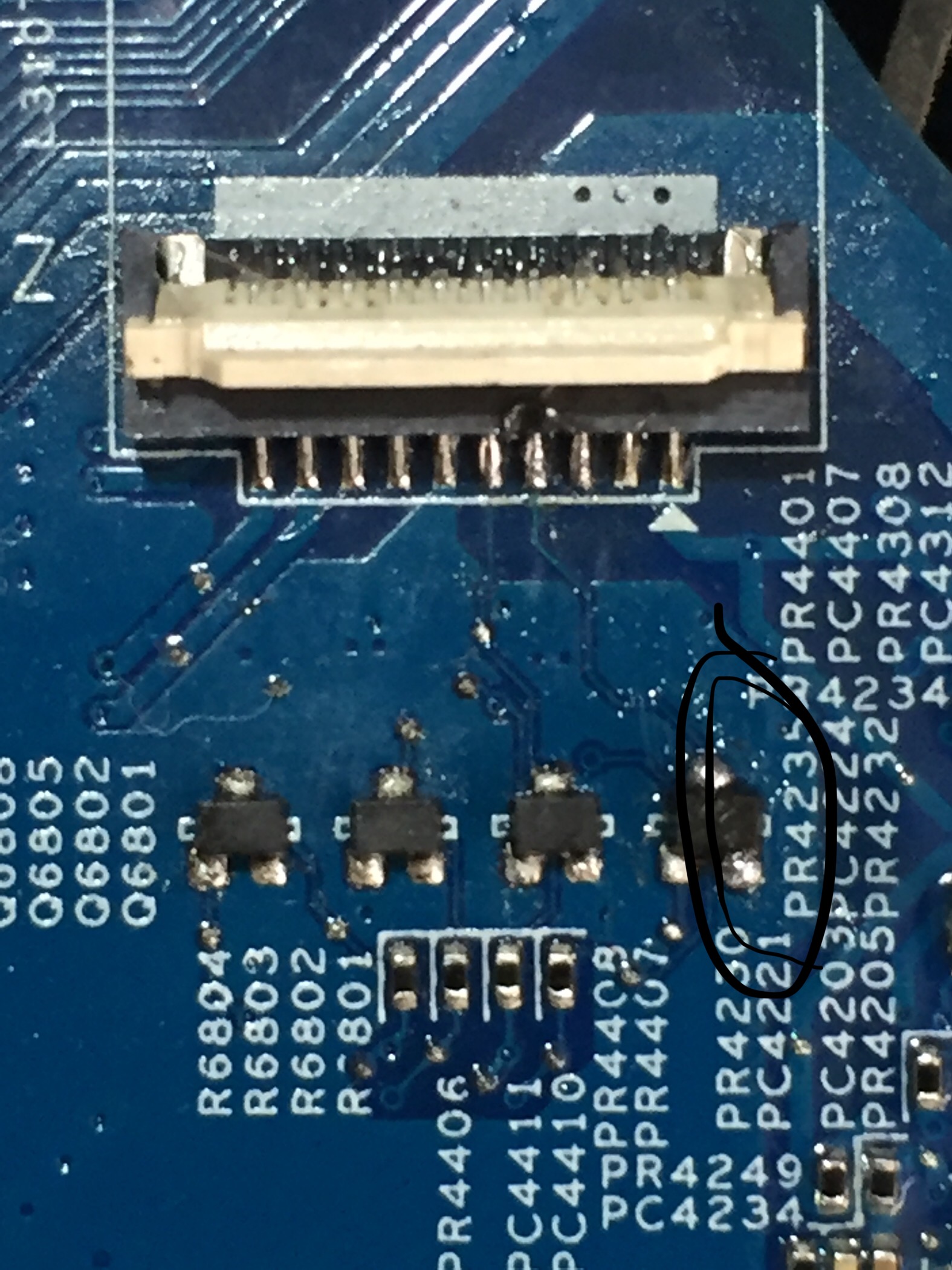

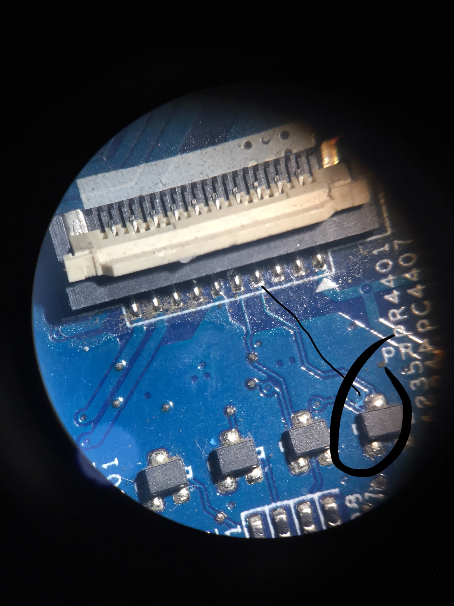

    Anyone can help me on this acer aspire 4752 JE40 HR MB 10267-4. the problem is all voltages are present but cannot power on, i notice that if i touch the pin 4
    ON PWRCN1 3.3v bluelight comes if i remove blue light gone, and also notice the mosfet connected to same with pin 4, pin 4 have 3.3v pin3 have 3.3v

            already did resolder same results I noticed once it cannot turn when you touch the 3pin mosfet 1 and 3 turn on lights blue comes up but when release lights gone

                            is the fet pu3802 ? when you touch BLUE light comes on

                              @techtiger the mosfet is Q6801 Which touching it bluelight comes but fan is not spinning

                                  Remove the ribbon cable from PWRCN1, short pin 3 to GND, see if the board powers up.

                                    @smdflea already tried that nothing happens but if i short this 3pin mosfet blue light comes up fan not spinning but release it blue light gone

                                      Its only for the LED if you think its a problem remove or replace the mosfet. With no power check theres no continuity between PWRCN1 pins 3 and 4.

                                        I tried replacing that mosfet still the same issue
