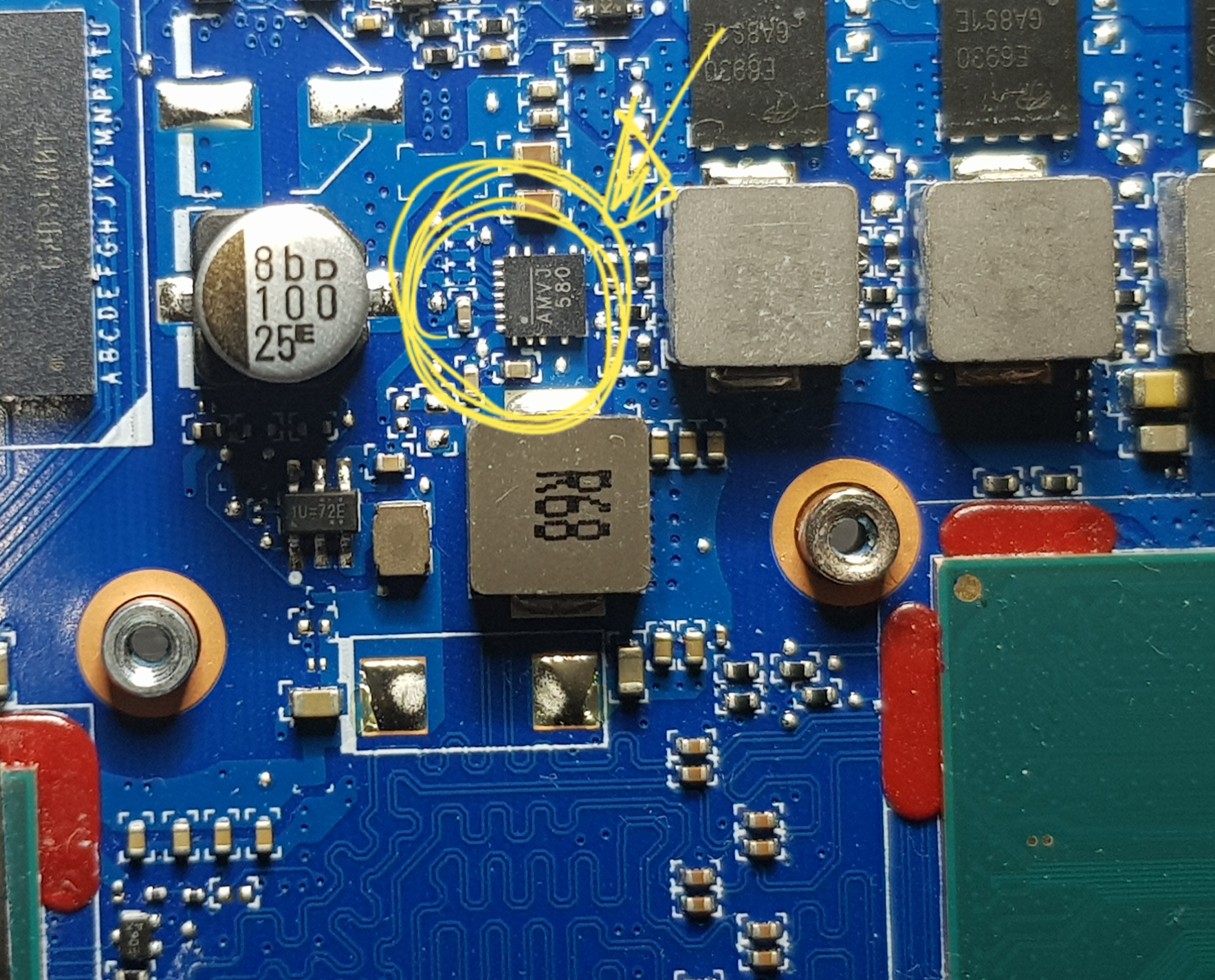

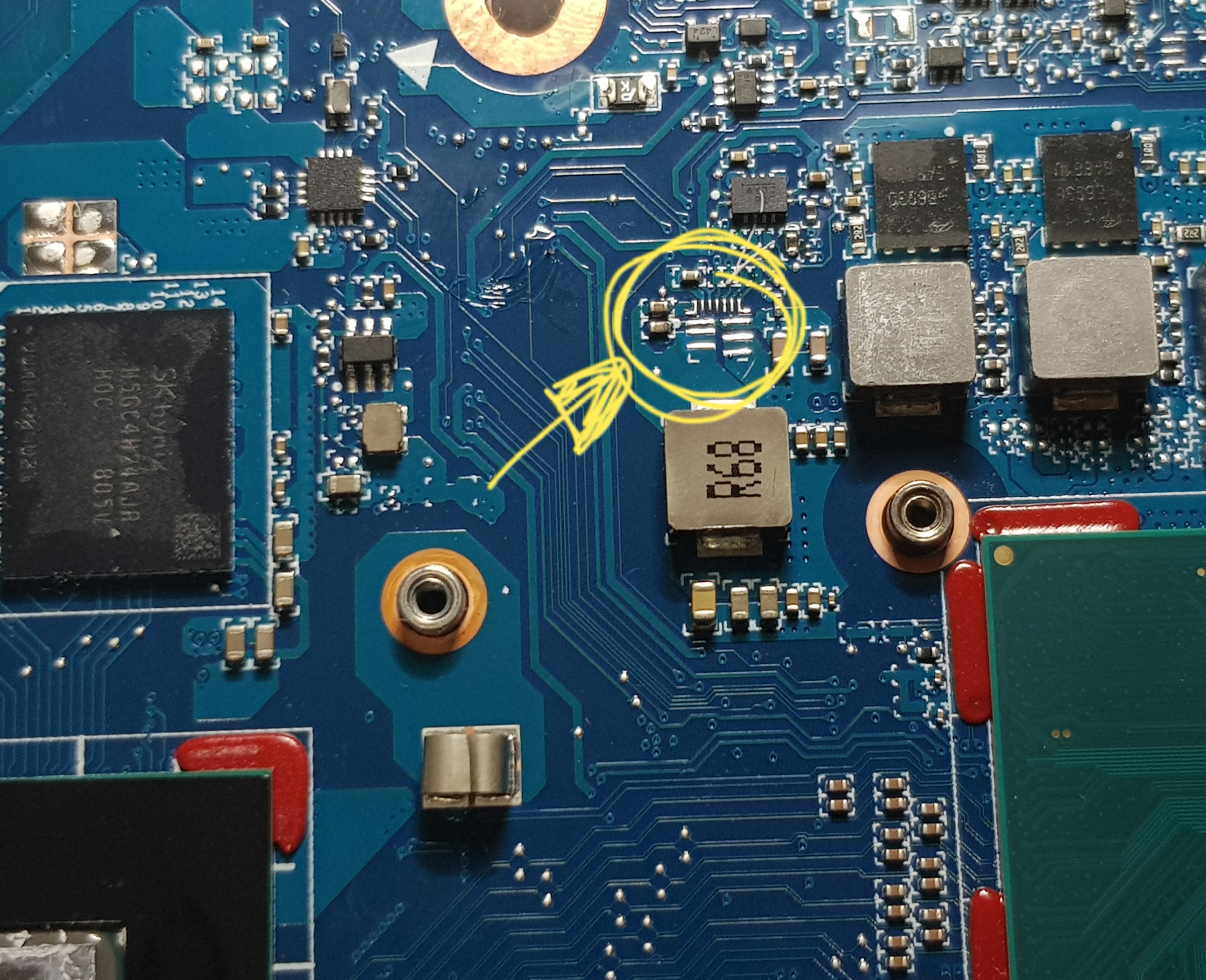

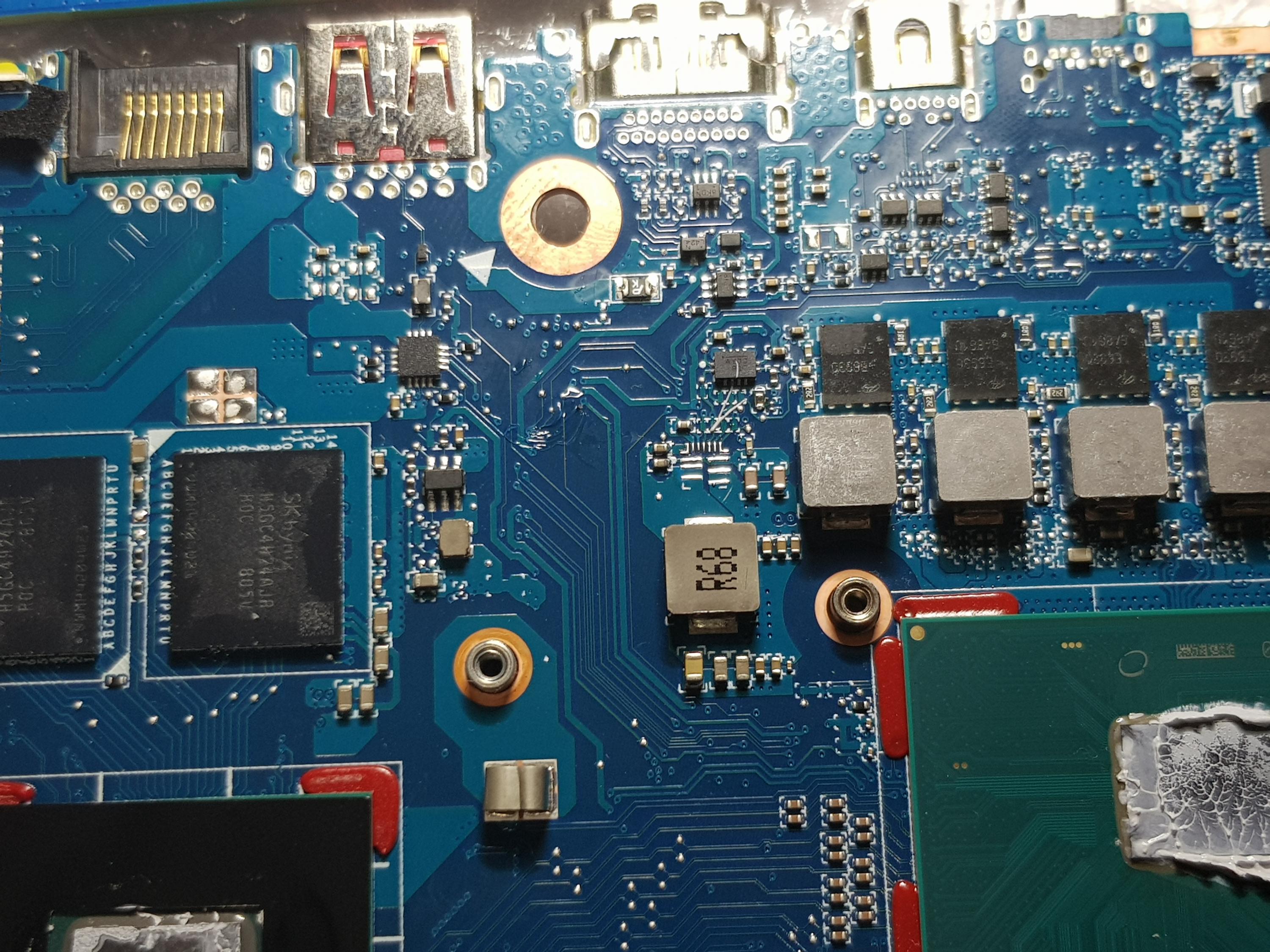

    Hi
    I have an Omen 15-dc motherboard which is missing one of its ICs as in the photos.

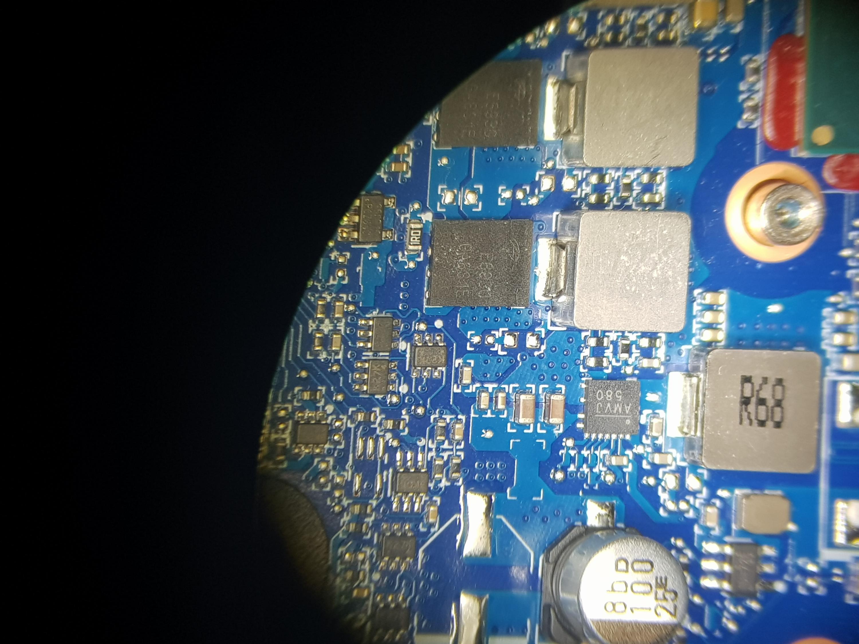

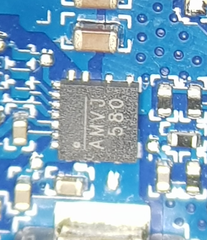

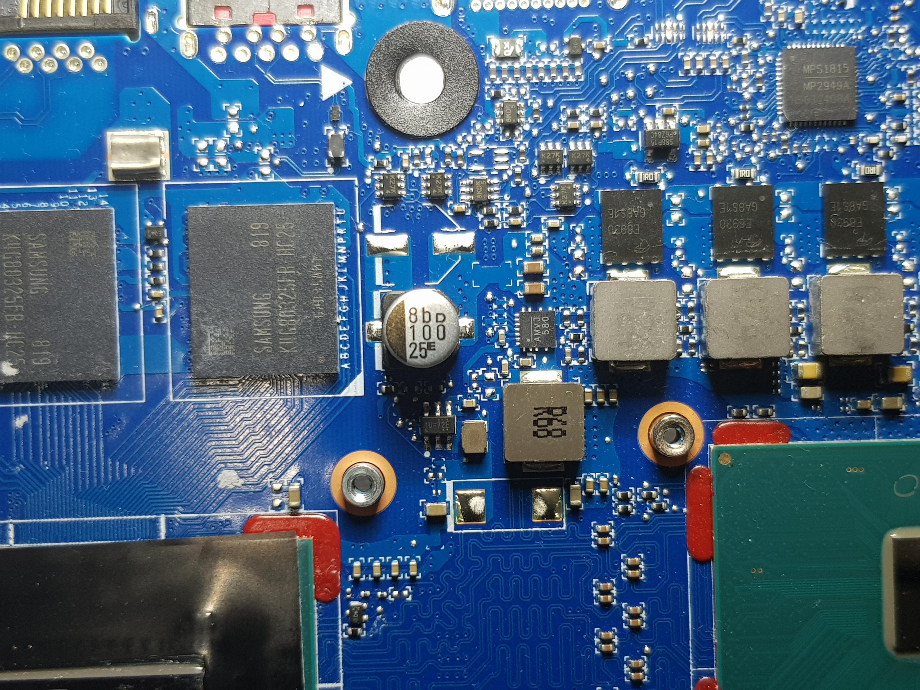

    I compared it to another Omen motherboard for the same model 15-dc and seems to have the marking code AMVJ but i was not able to identify this IC to order one.
    So any help would be very appropriated...
  • Weelcup
    TopTech
    • Oct 2017
    • 302
    Re: Help identifying this IC on OMEN 15-DC motherboard??
    Sorry. These are marked photos
      So far I have found this https://www.aliexpress.com/item/32829954274.html
      I also came up with this number MP86901-AGQTZ
      AMV = part number
      J = Year
      580 = Lot Number
        AMV = part number
        J = Year
        580 = Lot Number
        Wow! That was perfect. I spent the more that 24h to identify it and i could not!
        This was a big help and i do much appreciate it..
        Million thanks... i will ordered just now...
        Top man
