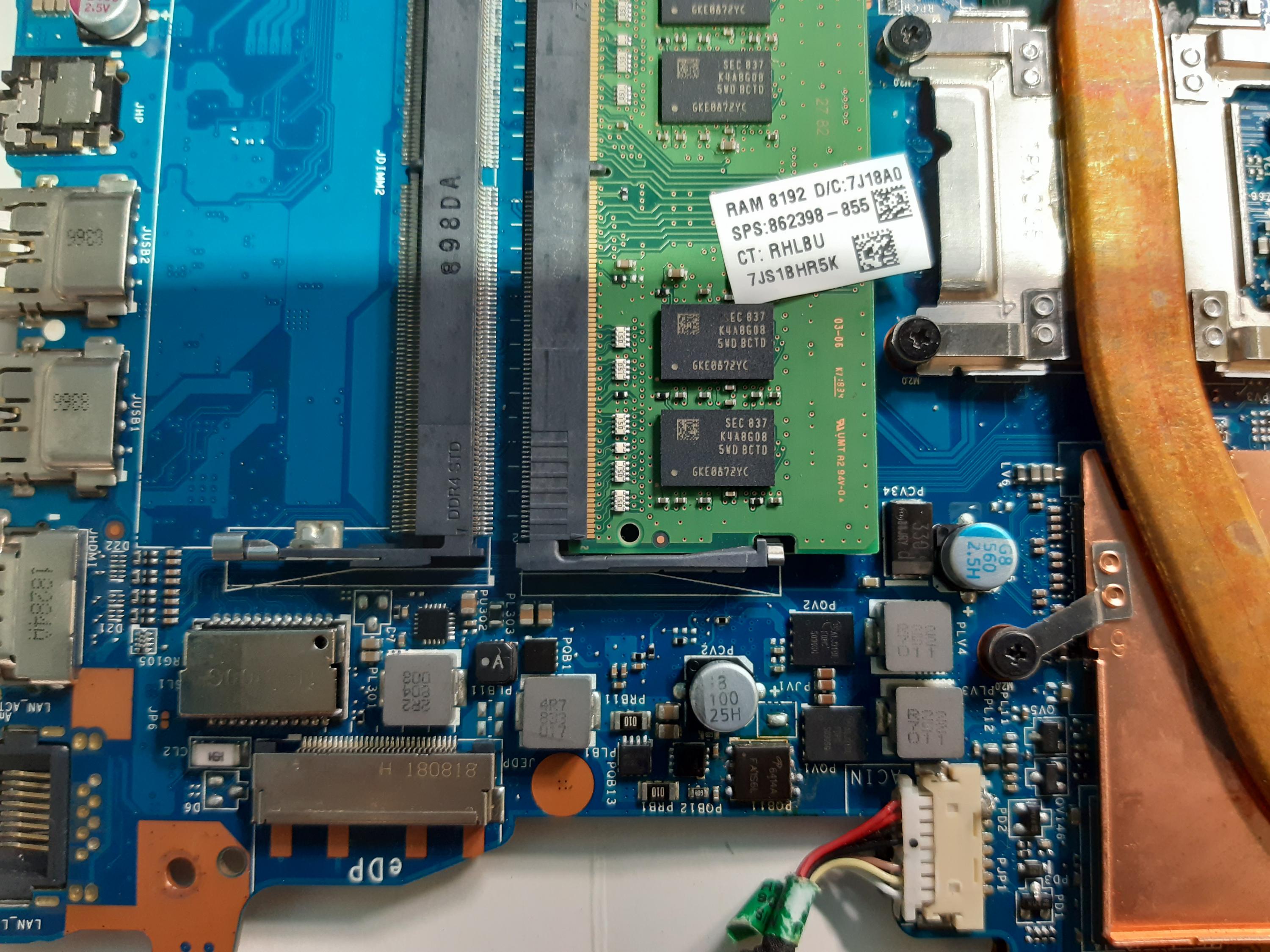

Having no power issue, check motherboard and found no voltage at pqb11 pin 1,2,3,4, replace it but now having 17.46 v at same pin. 3.3v present at at bios chip when power button press with 3 orange blinks at power led. Helps please

 Working on a board HP EPK50 LA-G07EP. Owner tried to replace LCD display without disconnecting battery. Afterwards, the notebook turns on for a few seconds and shuts off.
 Mainrail looks fine, battery charges. I have +5VALWP, but that's it.
 I measure short to ground (0.03Ohms) on +3VALWP and +1.0V_PRIMP.
 Injecting 1v at 3A on PL1001 and PL302 only slightly warms up the cpu after several minutes.
