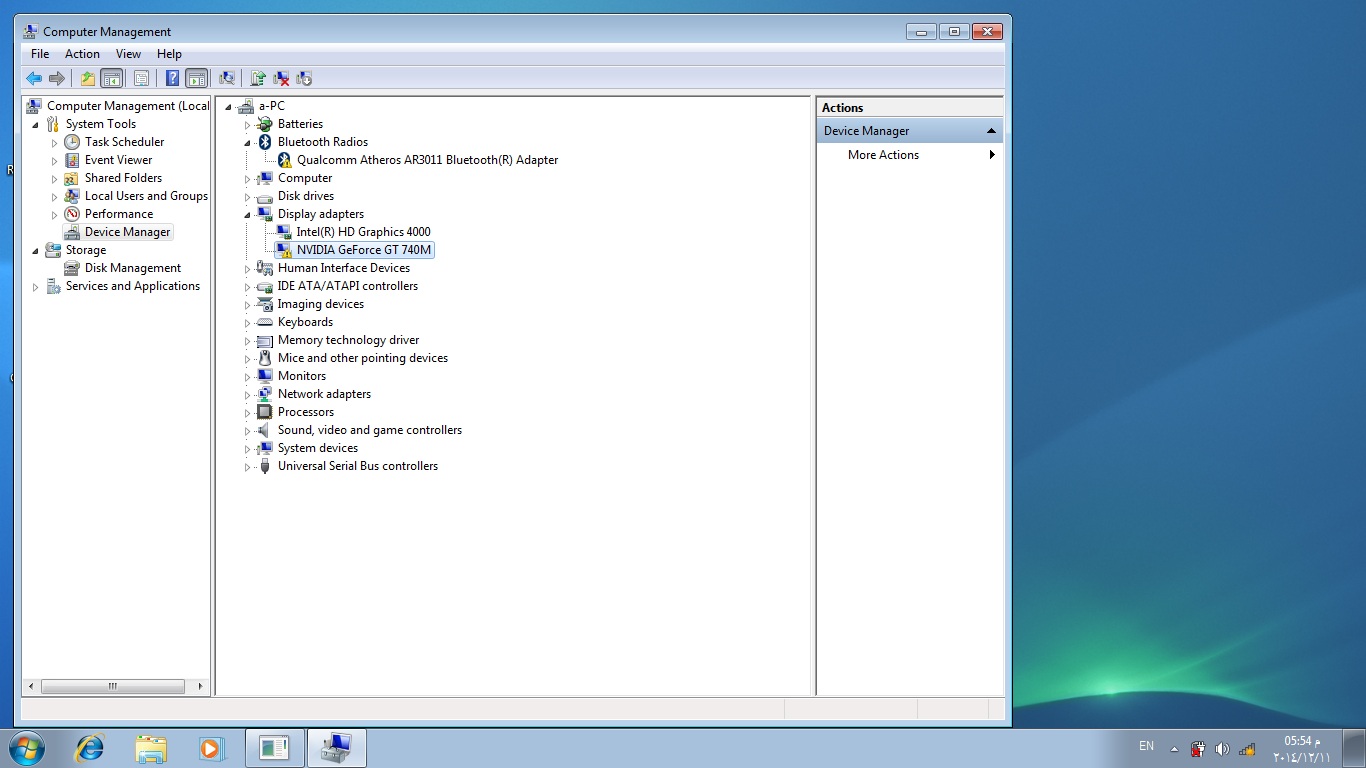

    hi all friends
    Sony Vaio
    model.SVF152A29W
    PRODUCT NAME .SVF1521JCGP
    MB. DA0HK9MB6D0 REV: D
    its problem is i cant install nvidia driver
    its appear with yellow mark
    the bios was flashed by another one and i tried to flash it by more than 3 files and use the update bios file under windows from this link
    https://www.sony.com/electronics/sup...jcxb/downloads
    with any result
    and use driver files from nvidia and intel web site
    is this bios problem or nvidia chipset problem
    can any one help my
    thanks for all

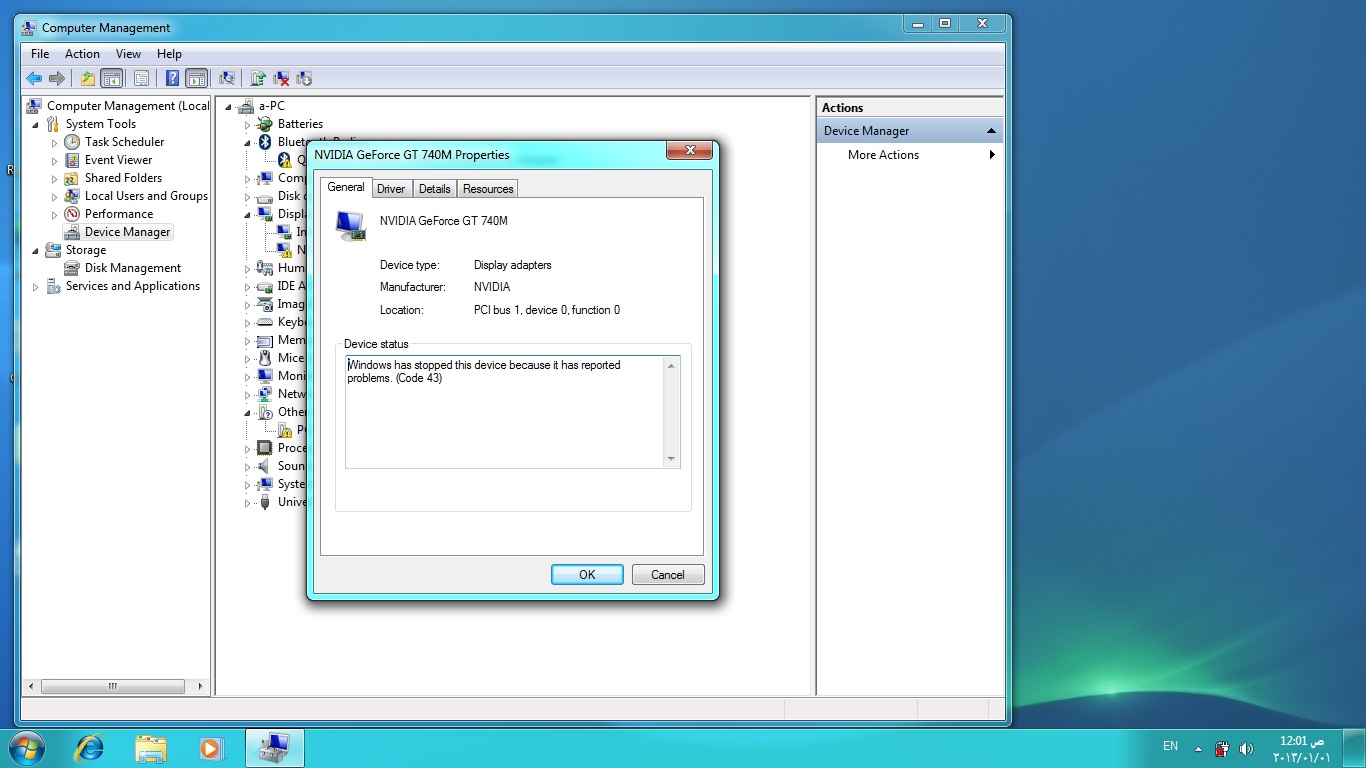

        Try install the driver from sony website. Also do you have a hardware switch for dedicated or integrated graphics ?
        On your picture click right and select "propertis". What error code do you have?

          heat up gpu ic to 130c, let it cool a little and than try

            i am tried with no success

              seen many of them, but allways it was bad balls under gpu. tried few reball but because of substance on the edges if ic it was very dangerous to not pull traces, so i stop reballing them. better work on internal gpu than not work
