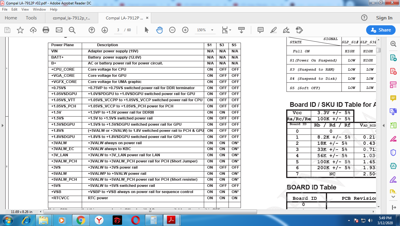

    good day, I have this unit dead set and missing 5v and 3v alw after solved, it turns on but missing supply on +VGFX core supply and shut off after 2 seconds if ram is inserted. the boardcode is LA-7912P and an UMA version.
    I have already done reflash both ec and bios and replace the bios chips and already checked the power sequence

    +VGFX appears when much and more things have successfully passed tests on this mobo. The conclusion could be drawn from your problem description is: 1) MB starts to POST and sees the difference b/w RAM installed or not. If you can share LPC bus state - would be nice. Try another CPU/RAM? Is memory voltage rails available/stable with RAM installed?

        I have the same issu with Lenovo laptop and finally i changed KBC and it's work fine with ram . try to change it
