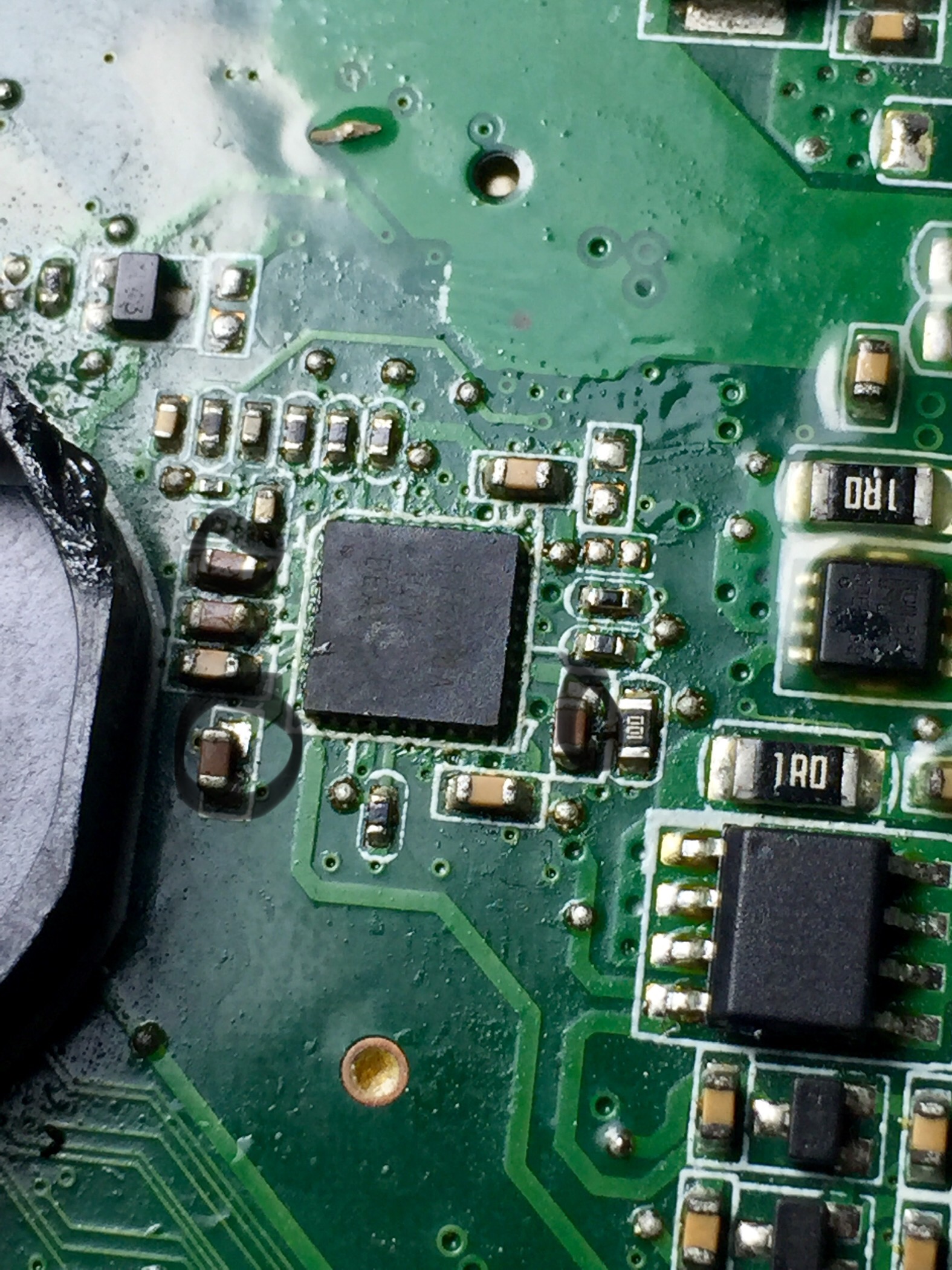

    I have a asus k43sv rev 3.0, when plugged in the charger 19v rail is present but there is no 3v and 5v on coil, i noticed that RT8206A chip is getting very hot.anyone can help on this please

    Whats your usual plan for dealing with a hot IC like this ? Measure voltage and resistance to GND.

            Re: asus k43s laptop no 3v and 5v
            I have attached the photo of caps around the ic the two caps on the left measured 0.00kohms and on the right cap shows OL .
                datasheet is available for RT8206A. You need to measure voltage on certain pins like VIN/LDO/EN1/EN2/ENLDO/VOUT/PGOOD. Measure resistance on suspect pins.Usually replacing a hot ic wont solve the issue. The IC is getting hot as some voltage rail is shorted. You need to findout which is the culprit rail. Else, it"ll be sheer wastage of time. Succesful repair can be carried out only if you have a clear & well understood strategy.

                  here is measurement of the RT8206a
                  PIN6 VIN=19V
                  PIN7 LDO=0.27V
                  PIN4 ENLDO=6.27V
                  PIN 14 EN1=0V
                  PIN 27 EN2=0V
                  PIN10 VOUT=0V
                  PIN13 PGOOD1=0V
                  PIN28 PGOOD2=0V
                  does this ic is bad?
                    IC is probably not bad, but one of the outputs is shorted
                    Could be Super I/O, had this before
                      but why is the ic is burning hot? i check the caps connected to the ic no short
                        Check +3V EC is shorted or not. What is the resistance on Vout pin??
