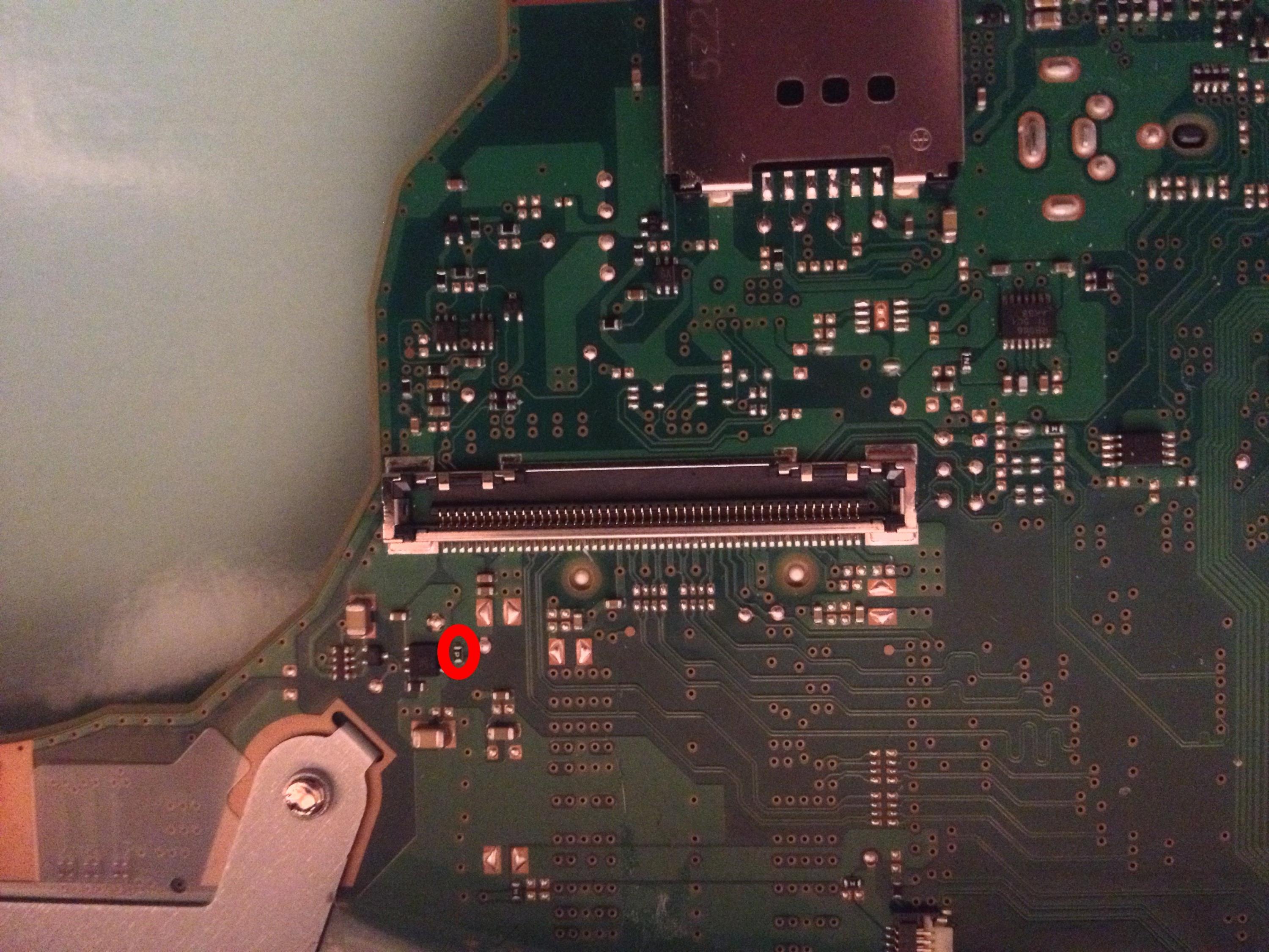

    Is anyone know where the backlight fuse on the motherboard of Fujitsu Lifebook E744 is located? I tried to find service manual for this model but with no luck.

    This is the area around display connector on the motherboard:

      This is the same area from the other side of main board:

        cannot find schematic and BV?

          Re: Fujitsu Lifebook E744 backlight fuse location
          This maybe? Find motherboard model number.
            Yes, was this. Thanks.
              I confirm that this works for Fujitsu Lifebook E754 too. Thank you for this.
