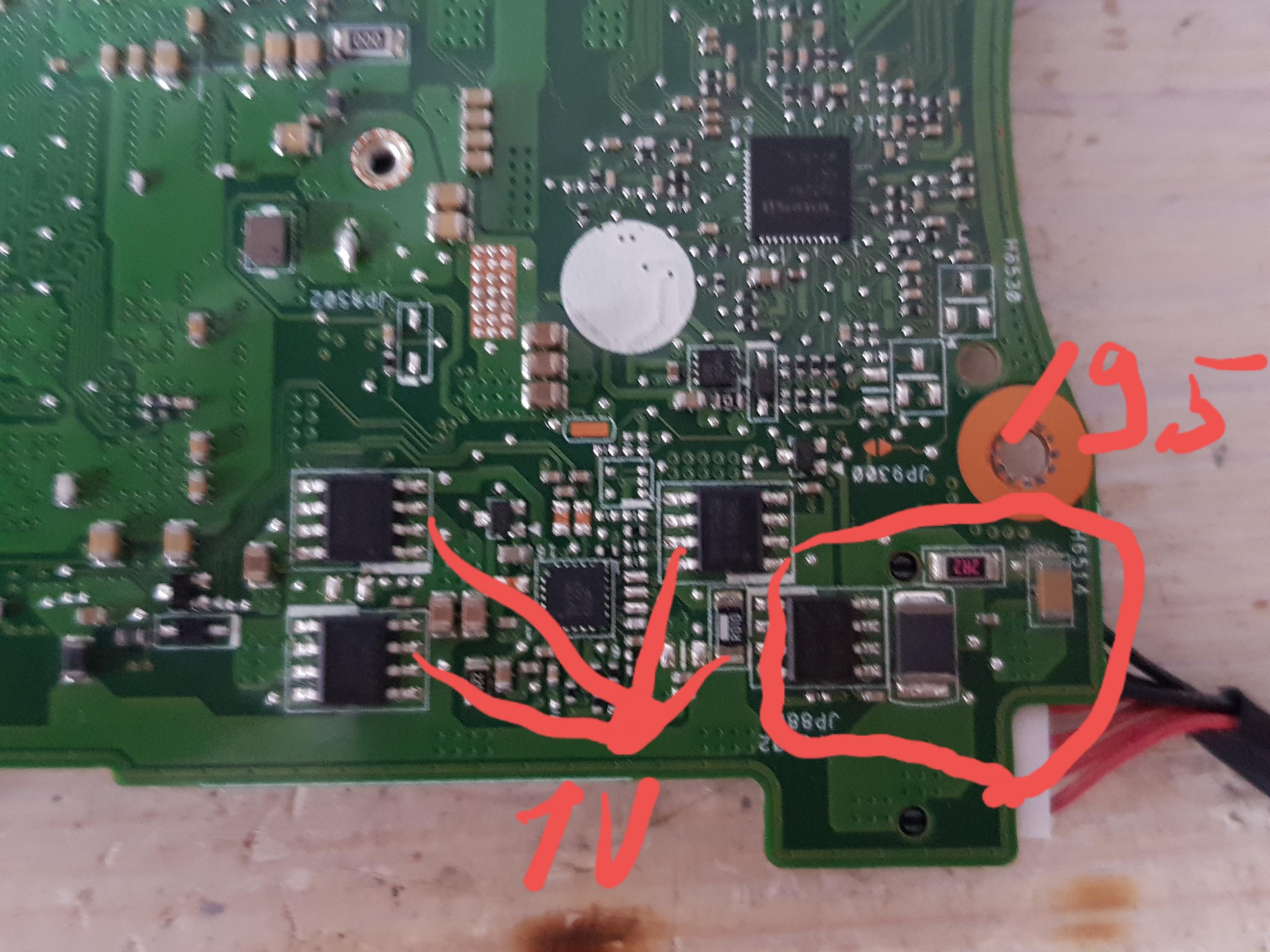

    Hello, i recive an Gl553vd, in a bad condition the motherboard seems to be ok( no damage)
    Laptop is turning on i can enter in bios and after a few seconds it shutdown, i can turn on again and same shutdown (strange is that the battery led is orange like is charging the battery but battery is not connected)
    After 3,4 times is not turning on, and the battery led is off
    I measure after first mossfet i have only 1V.
    I replace the first mossfet same thing.

    Do you try different charger and without battery

      yes, is not a charger issue

        most likelz its KBC failure, did it gethot?

          No

            After shutting down, i have only 1v after first mossfet, i need to disconnect the charger to power on

              At battery port on + i have 3, 4, 1 ,8v oscilating

                check chip bq power menagment

                  I fixit, the problem was second mossfet, wass half broken, i replace it and now is working

                          Re: Asus gl553vd shutting down after 5-20 seconds
                          You can replace the damaged one (it is usually shorted) but it is important that it has the same or better characteristics
