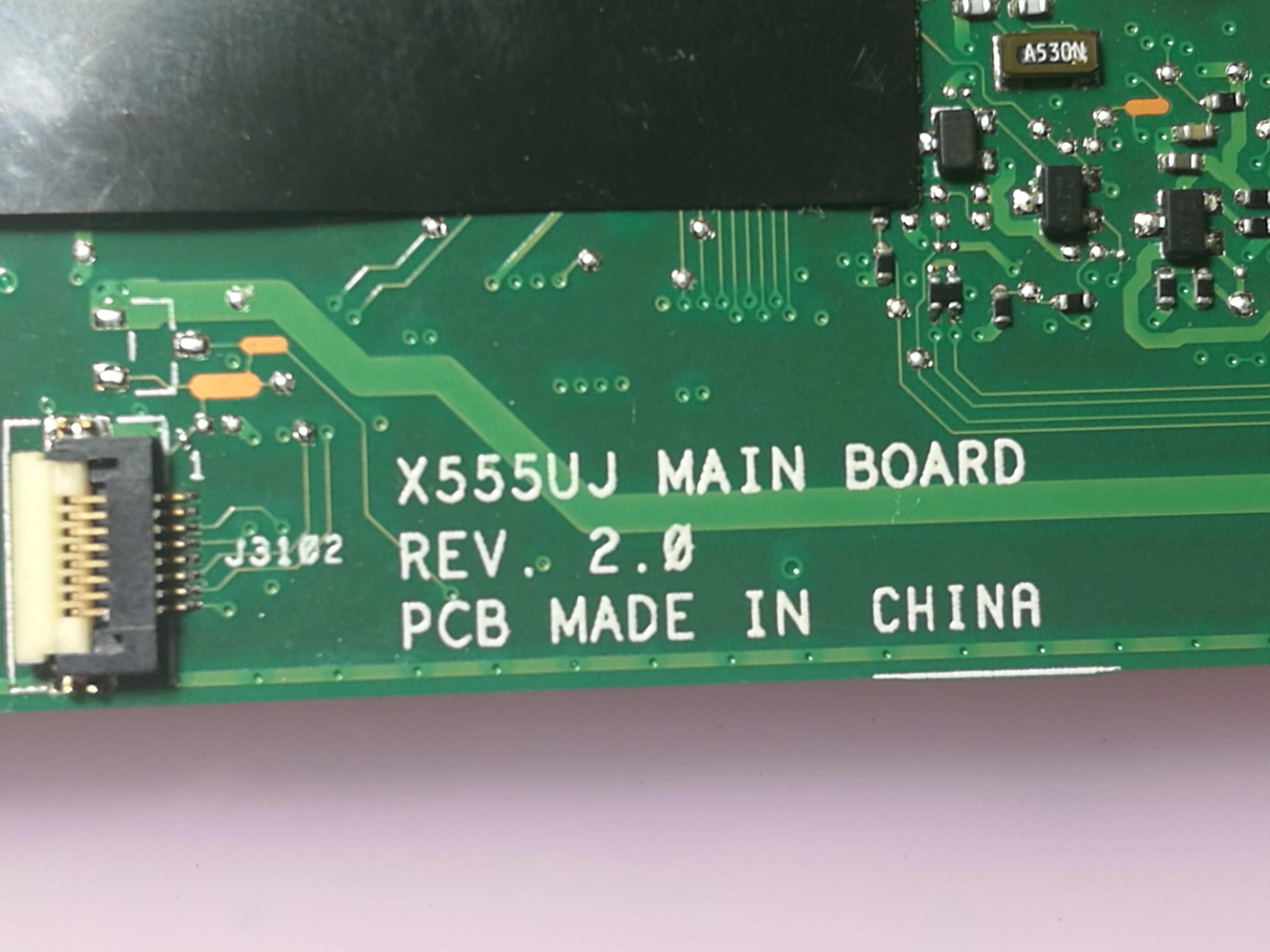

    Motherboard: asus x555uj rev 2.0

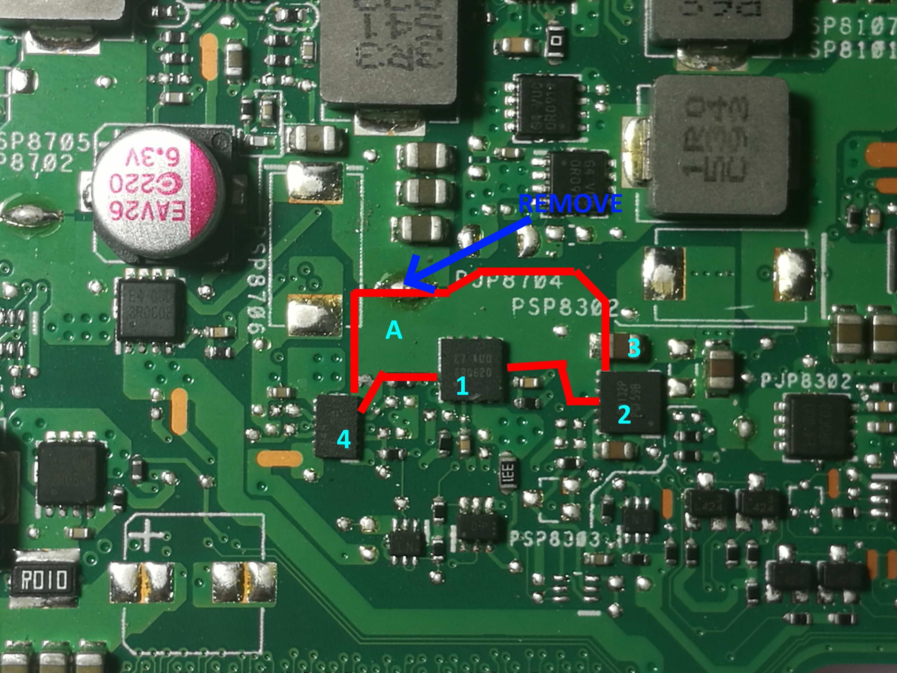

                        +3VA_DSW->+3VSUS , it takes the voltage from the pu8803 chip If you open PJP8704, that the area A (see it on the pic) is completely isolated unless there is a problem on a chip (1-2-3). Your motherboard is the same as the pictures I sended
                          Re: Asus F555U dead
                          1,2,3,4, PJP8704 removed but nothing changed shorts here.. it's going inside motherboard and on components on both sides of the board..

                                    Hello, I also have x555uj. It doesn't hurt. 19 volts but no other voltage
                                    can you help me

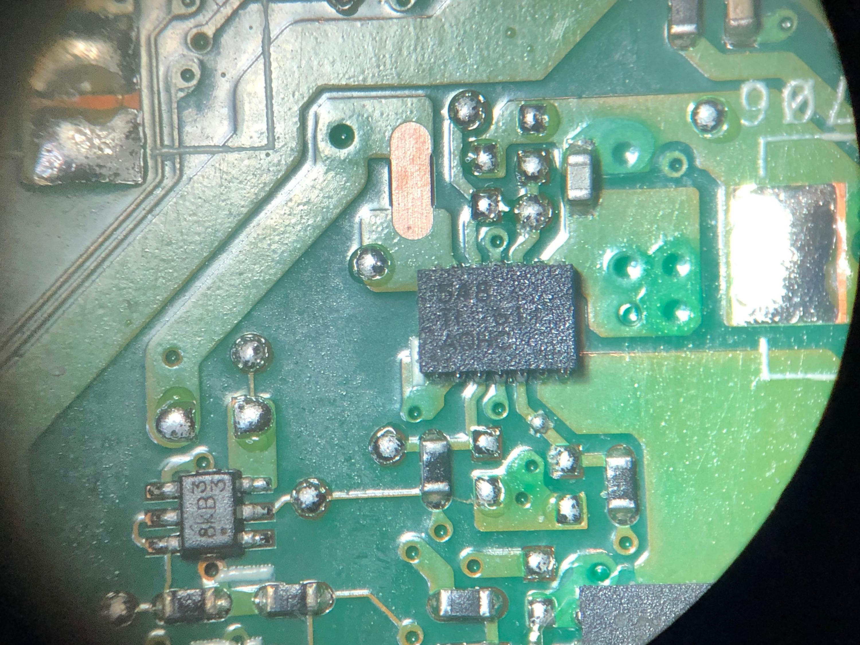

                                      Sorry, a question someone know what are the mosfets that have top of the image? in boardview appears like PQ8302 &PQ8301I have in short this mosfets but in lens show me 6R0B06 and not appear neither replace.

                                        Hi, have dead X555UJ board. Short on +3VSUS line. When injecting voltage here all board is dead cold (monitored with thermal cam). Removed PJP8704, short is still there, but when connecting charger CPU starts to heat and there is a heat spot around PQ8811. Does that mean the CPU is dead?
