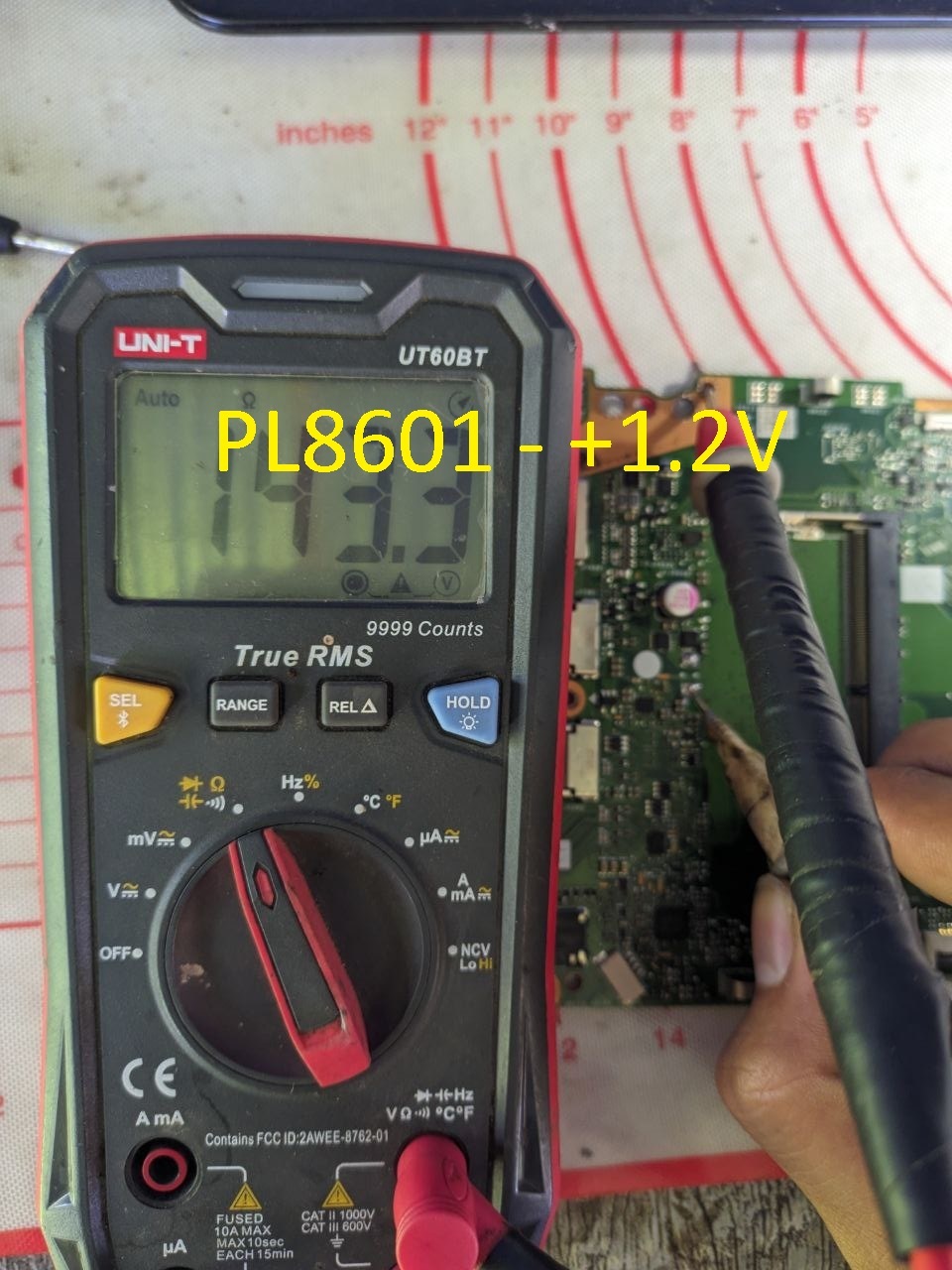

    Ive isulated everthing and 2 thing is getting hot the pcb board and the cpu mildly
    +3VSUS resistance to gnd is 1.6ohms
    also i remove the PL8601 to isulate the low resistance side from the +1.2V Im getting 148 ohms resistance
    hope someone can help me how to determine and find the issue oif this low resistance

    Would you have the schematics or only the boardview file? I see only R2.1 bv in my database.
    Which side of PL8601 is with the low side? The producer / upstream (regulator) side or the downstream / consumer side of this removed inductor?

      I only have the board view file it's r2.1 bv line that goes to the 1.2v line

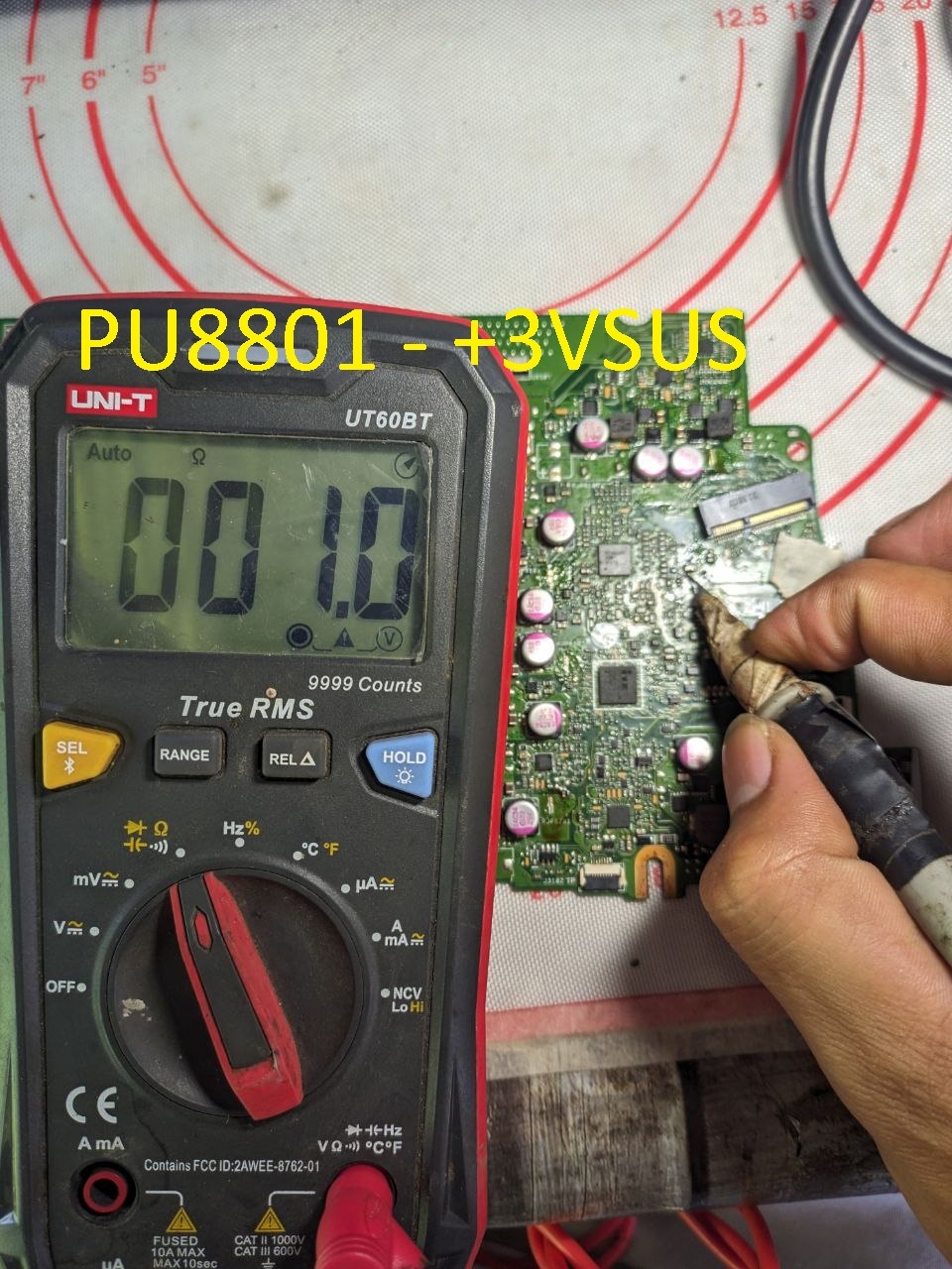

          I also remove the PU8801And pump voltage in pin 9-8 its taking around 3v 2.5a

            Which side is now @ 148R ohms? Is it pin #1 or #2 of the removed inductor? Which pin is with 1R6 ohms to ground?
            • kalilinux25
              • Mar 2018
              • 2089
              • ZAMBOANGA SIBUGAY
              Remove the PL8601 and the pin 1 has 148R , and PU8801 pin 9,8 has 1R6 resistance to ground

                Consider to flux and carefully remove PU8801 off the board. If there are any parts between the PL8601 and PU8801 (pin 8&9) - remove them first. After each part removal, measure the resistance to ground again of the same PCB trace. Take pics before any reworking.

                  I also remove the L5301 and PU8801 pin 98 has low resistance to ground

                    What about 1.8V rail? Is that also shorted?
                    • kalilinux25
                      • Mar 2018
                      • 2089
                      • ZAMBOANGA SIBUGAY
                      +1.8VSUS - has 0.06 ohms
                      I remove the two resistor and the +VCCPRIM_1P8 was the shorted line but after removing this the +3VSUS still has 1.0 ohms to ground, +VCCPRIM_1P8 has 0hms to gnd is this already a cpu or pch issue? its in one package
