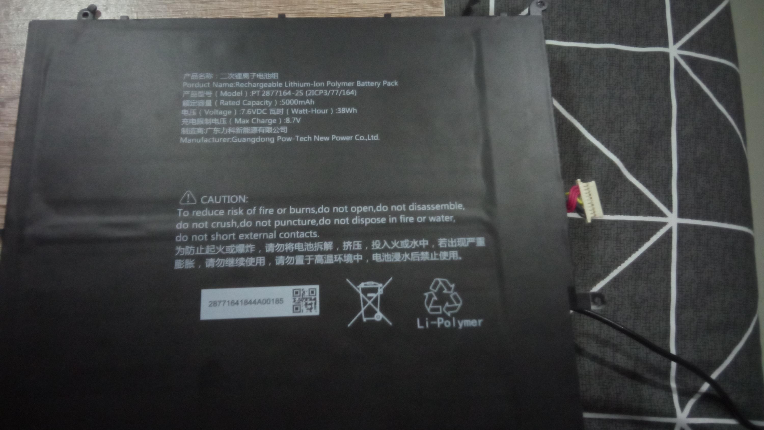

    Decided to check the batteries from both of the laptops. 2 batteries tied together to create a higher voltage battery pack.
    Designated voltage: 7.6V
    Max power: 8.7V

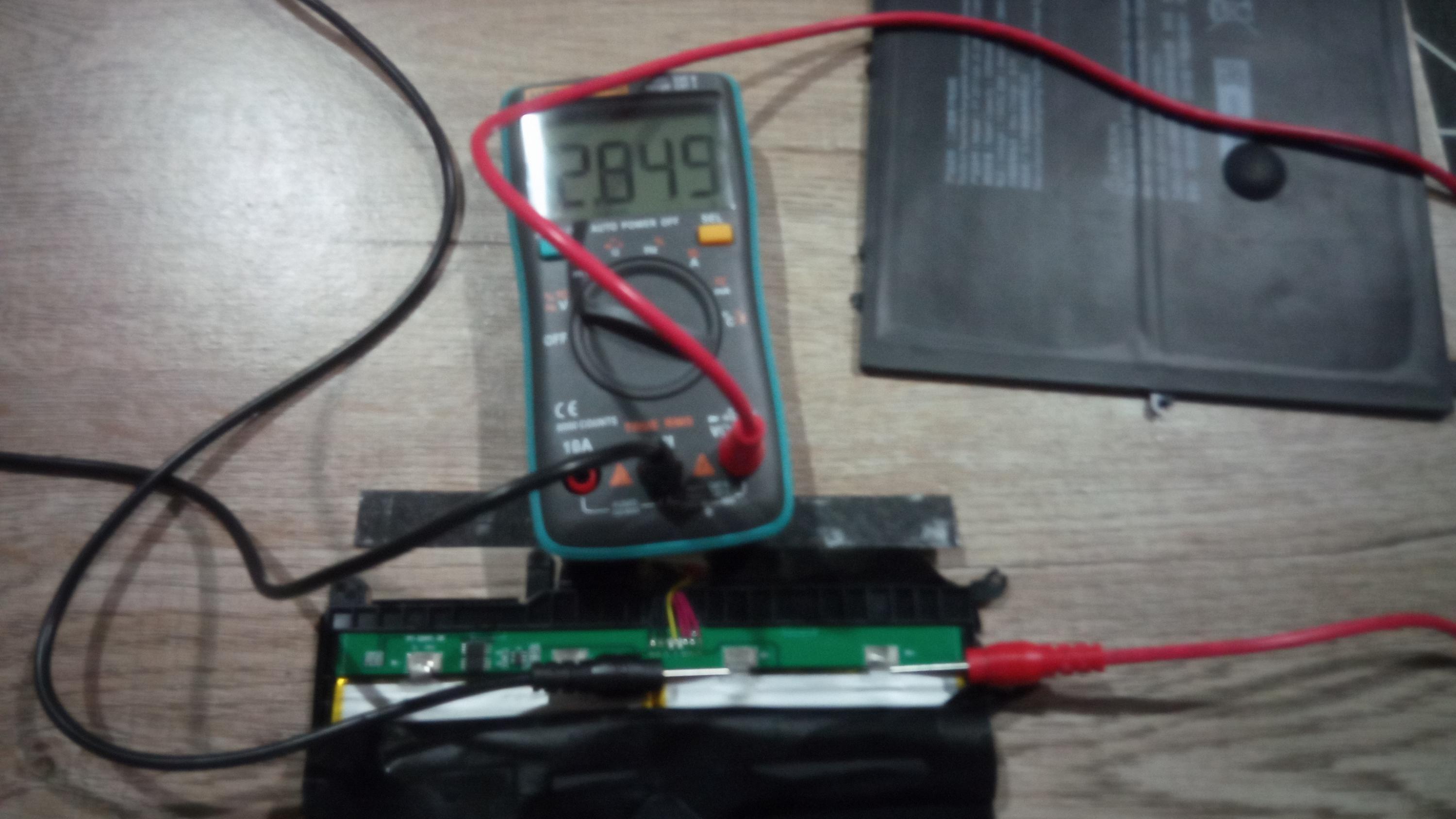

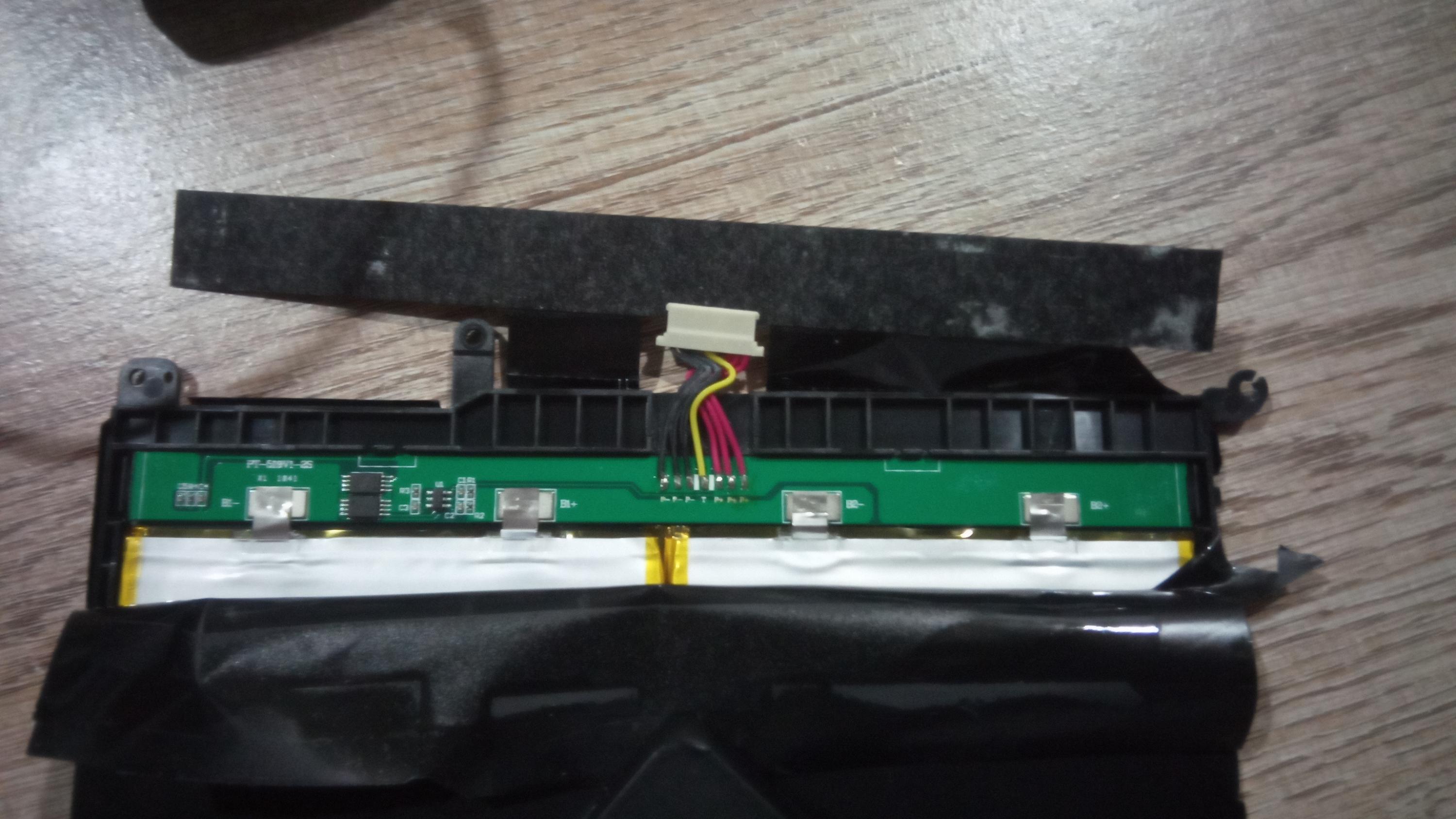

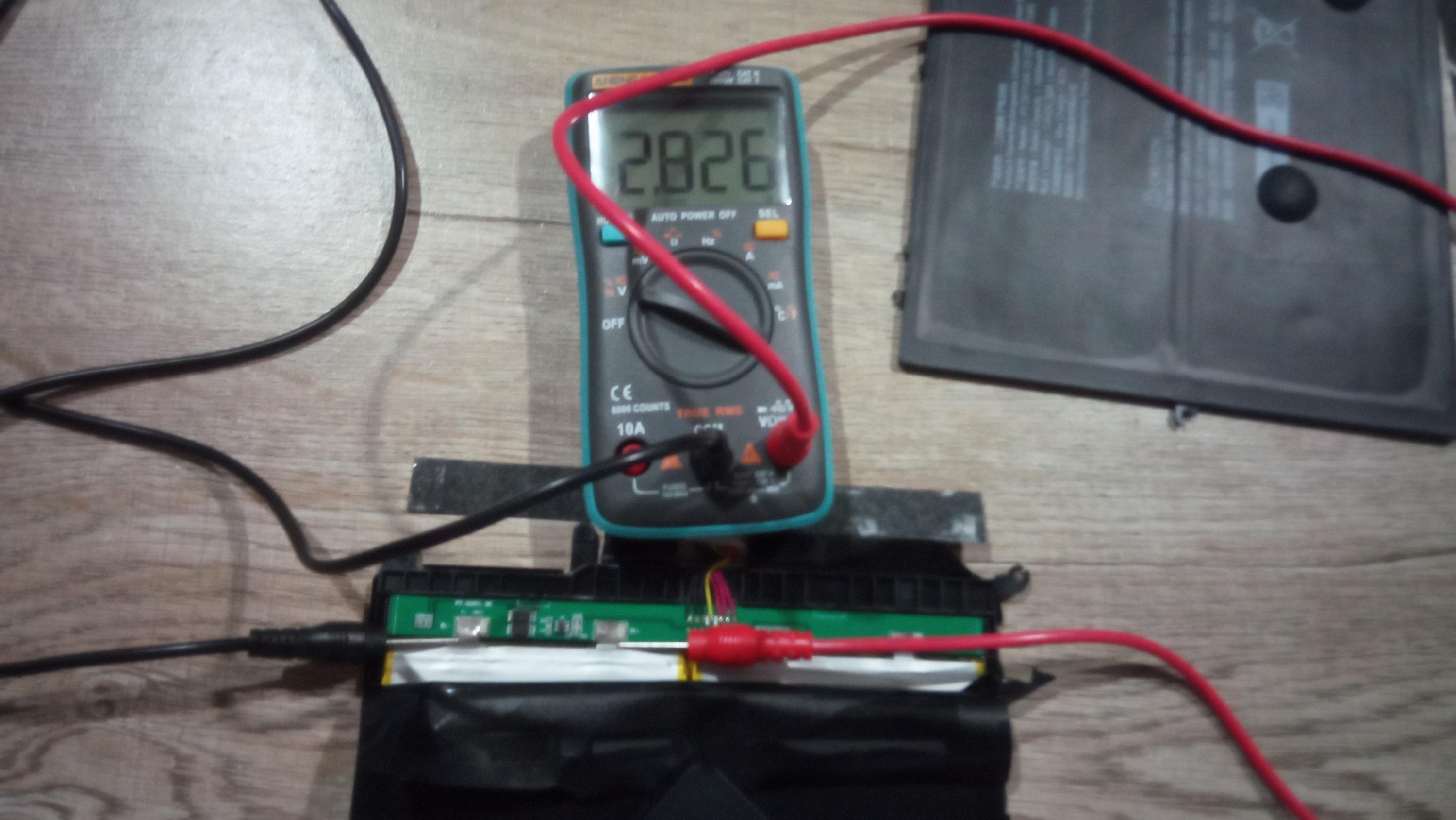

    Teared off the tape a bit to get to the battery pack control board and the contact points. EXPECTED to measure 3.8V off each battery cell (Thus 3.8+3.8=7.6V), but multimeter only showing 2.8V off each cell.
    Measuring off the contact points from the battery pack to the motherboard, not really getting any values... From any of the black wires to any of the red wires - 0V.
    Only value I can get is when the charger is connected, I am getting 3V from the yellow wire to the red.

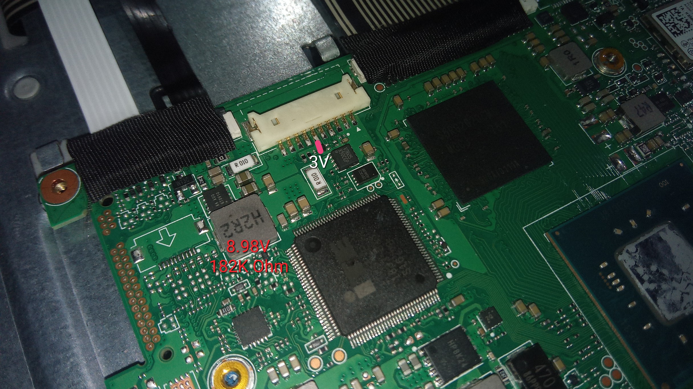

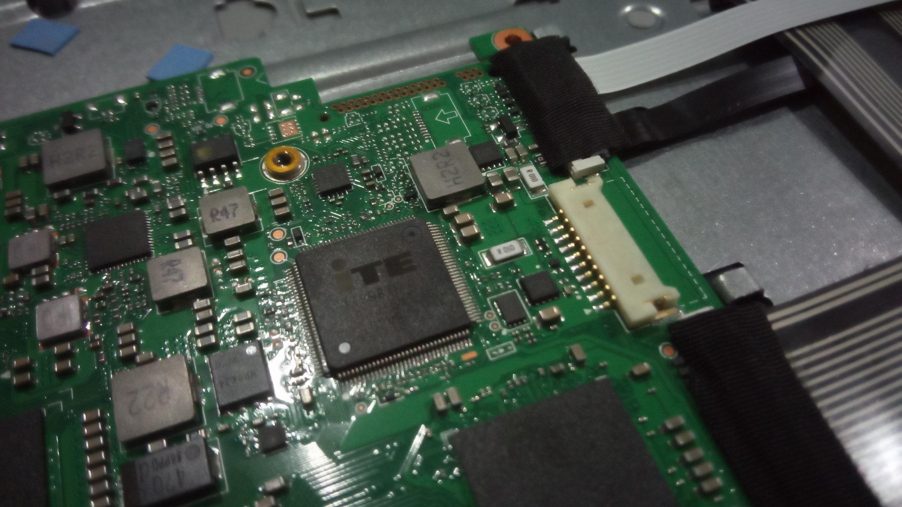

    Also one chip (power regulator I think?) gets hot very quickly as soon as the charger is connected.

    That's a dead battery or at least deeply discharged. Be careful with LiPo batteries as they can be very dangerous, better not mess with those.
    Which chip getting hot are you talking about?

      Would definitely be good if the only problem is the battery. I can order a replacement, but it is quarter the price of the whole laptop, so want to know 100% if that is the issue, or is it something in the charging circuit.
      Is it so that these ultrabooks do not turn on without a battery? Used to those older types, that you can run with the charger plugged in. These cannot do it?
      This is the hot chip in the attachment picture.
      Markings:
      iTE
      IT8987E
      1833-BXS
      S162VB

          IT8987E is the EC (Embedded Controller). Usually EC getting hot = dead EC.

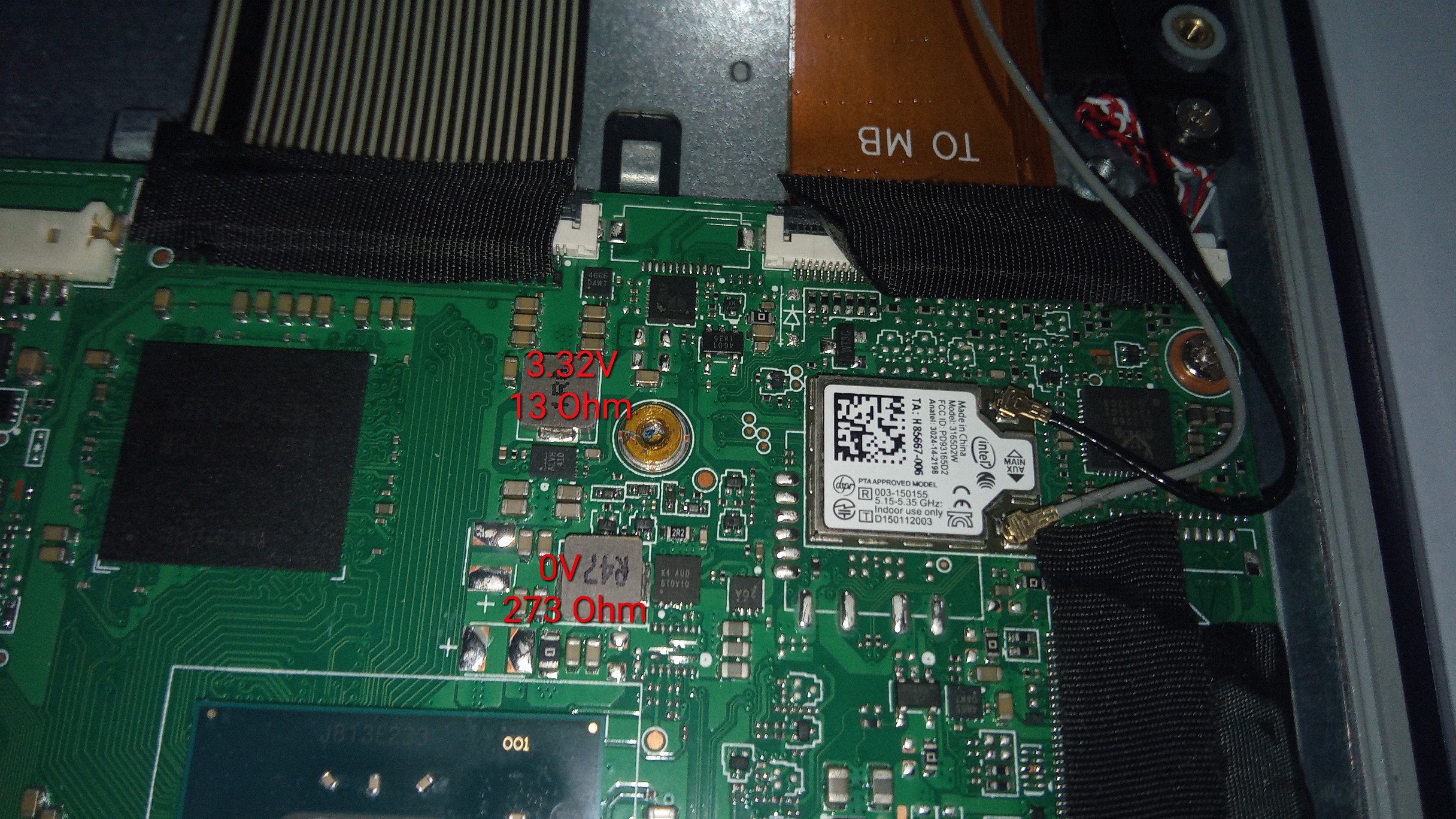

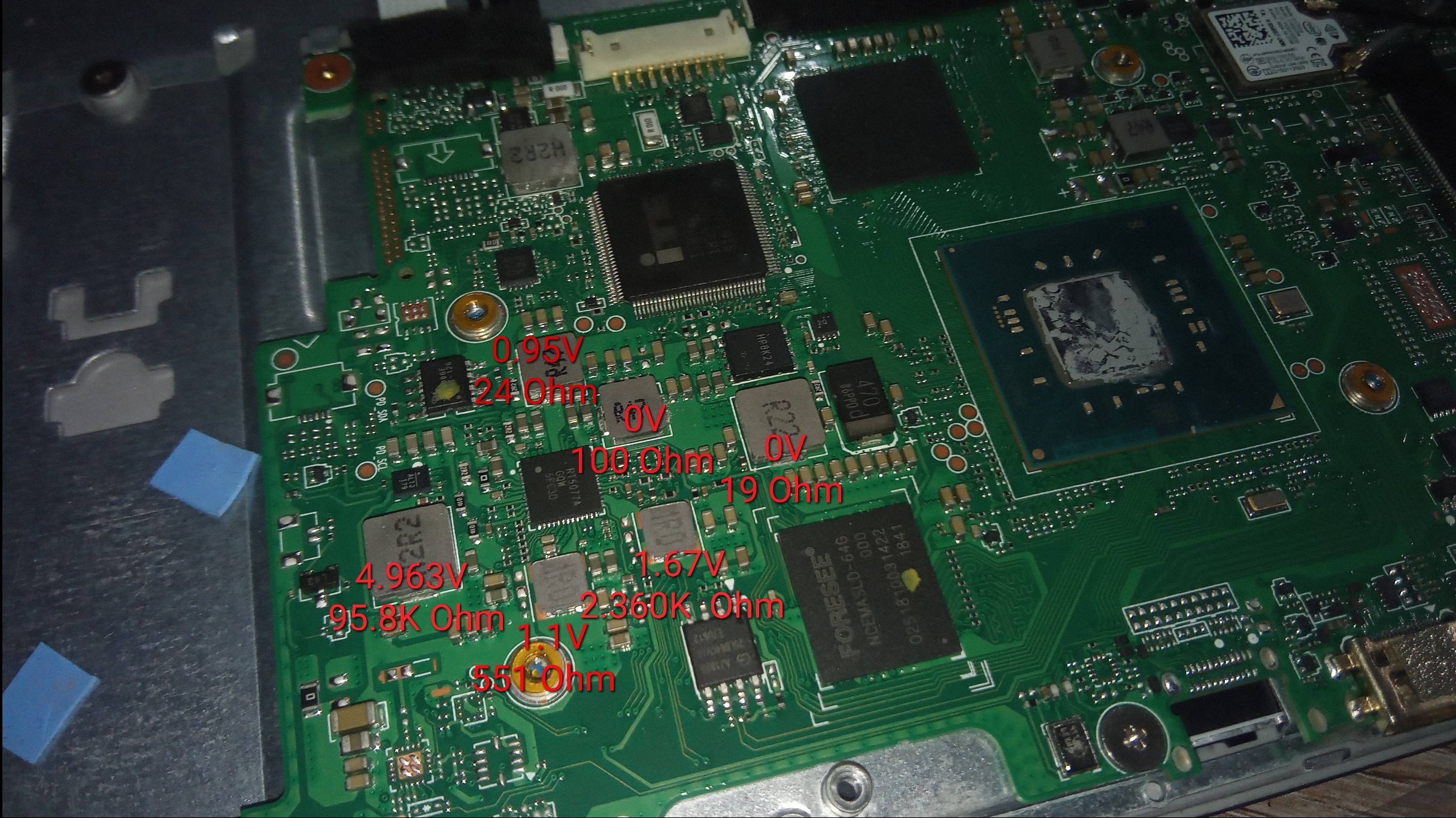

            Found a few coils with 0V power. Any ideas how to troubleshoot further? Clearly something with the power delivery?
              Re: Chuwi Lapbook SE not starting (x2)
              Those coils with 0 volts are most likely vcore coils for cpu. I think you should forst replace the EC and then proceed further. Remember, this ec is programmable.
