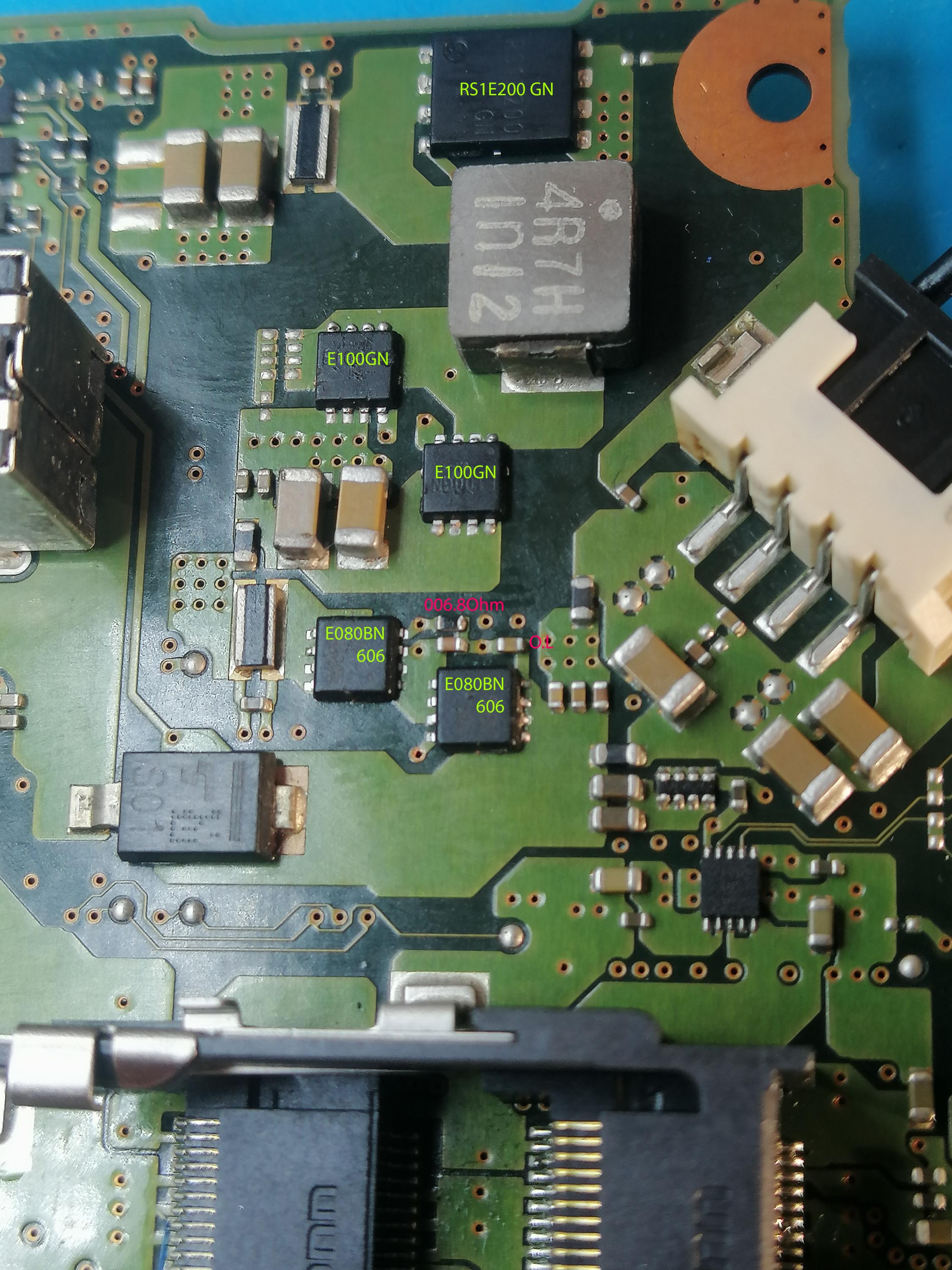

                    Can you post some clear pictures of the mosfets and DC in areas .
                    • nrcslim89
                      • Nov 2019
                      • 129
                      • Portugal
                      Re: Fujitsu Lifebook E546 - No Power
                      Sure give me 5 min
                      • nrcslim89
                        • Nov 2019
                        • 129
                        • Portugal

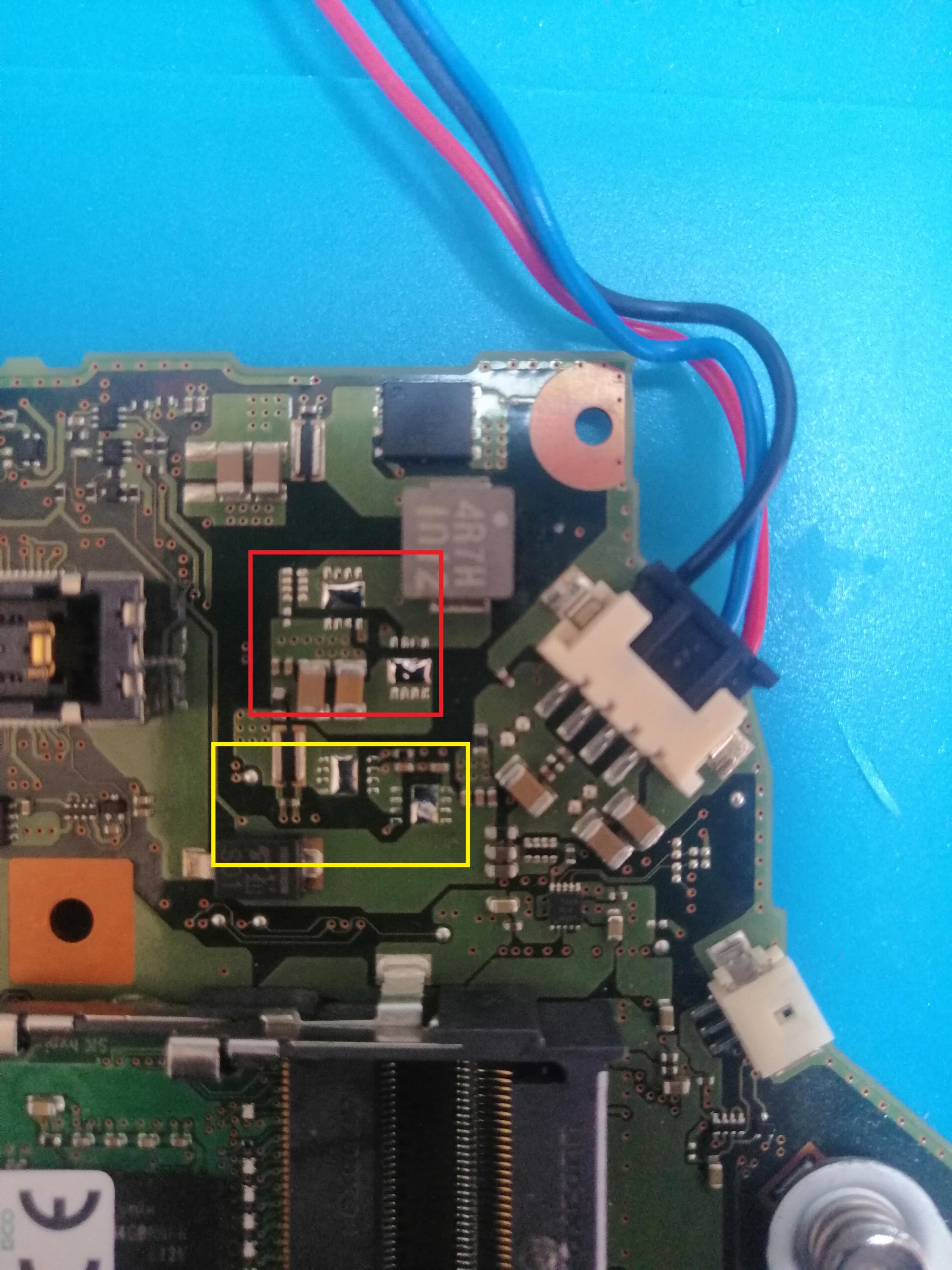

                        Ok here you have, the yellow case are E080BN MOSFETS
                        The Red Case are E100GN MOSFETS
                        Hope it helps
                              Originally posted by digitalpc
                              why you remove 4 mosfet-s.
                              HI there, well, because the first one like I said before, gets hot and drop smoke when i put battery and charger simultaneous.
                              With charger only won't turn on, and only turn on with battery charged...
                              Battery won't charge so I start removing the Mosfets because I think the issue comes from this circuit...
                              If could help me I appreciate

                                after dc jack u have 2 mosfets and current resistor so try this method
                                remove this current sensor and supply power from dc jack see if any of this 2 mosfets are getting hot or not. With this method u can know if problem is mosfets or something else after this resistor.
                                If nothing is getting hot before this resistor, now in output of resistor put power(19v and around 1.5amp)with power supply and see how much current is taking or anything is getting hot..
                                feedback after this
                                p.s put back all mosfets
                                • nrcslim89
                                  • Nov 2019
                                  • 129
                                  • Portugal
                                  Ok, i replaced all original MOSFETS.
                                  I try to Power Up motherboard again, no signal of life.
                                  You can see on picture, i put some values on it.
                                  Resistor have continuity, and i check resistance and have only 006.8 Ohm value.
                                  The capacitor before resistor have O.L value and no continuity. (Pink Color on photo).
                                  The second tiny capacitor have 051.1 Ohm and no continuity.
                                  So... I measure voltage and i get 19.35V aprox. only on the 4 pins of 1st MOSFET (DRAIN).
                                  After that i start to don't have any good value of voltage even on SOURCE pad and GATE pads...
                                  Unfortunatley i dont buy yet a Power Supply i will provide one fast.
