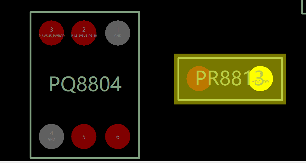

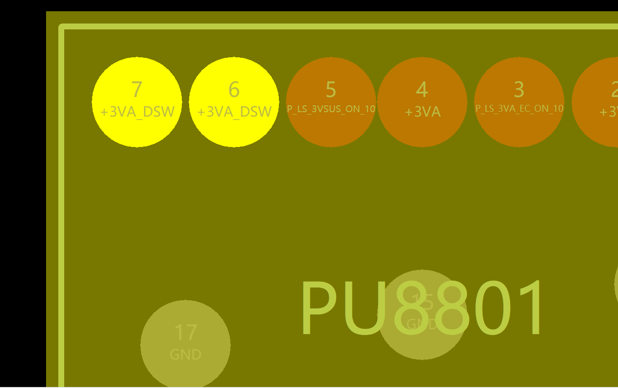

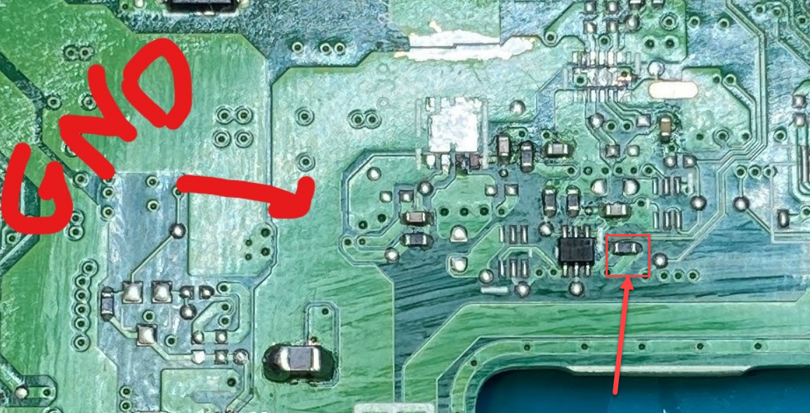

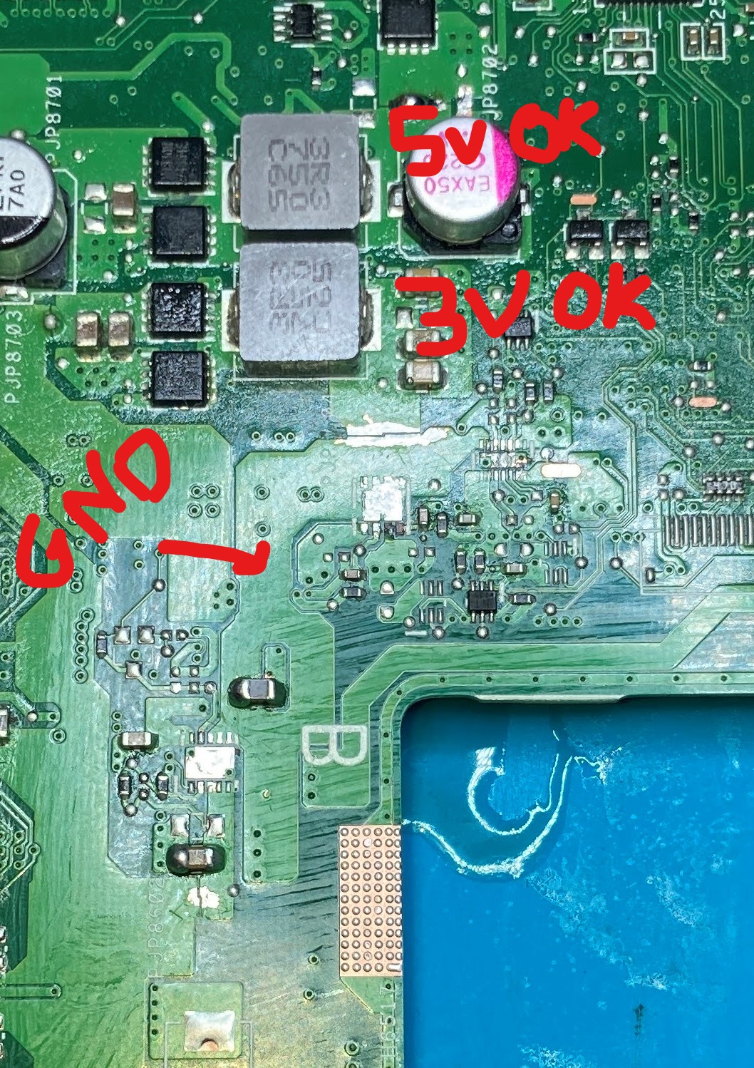

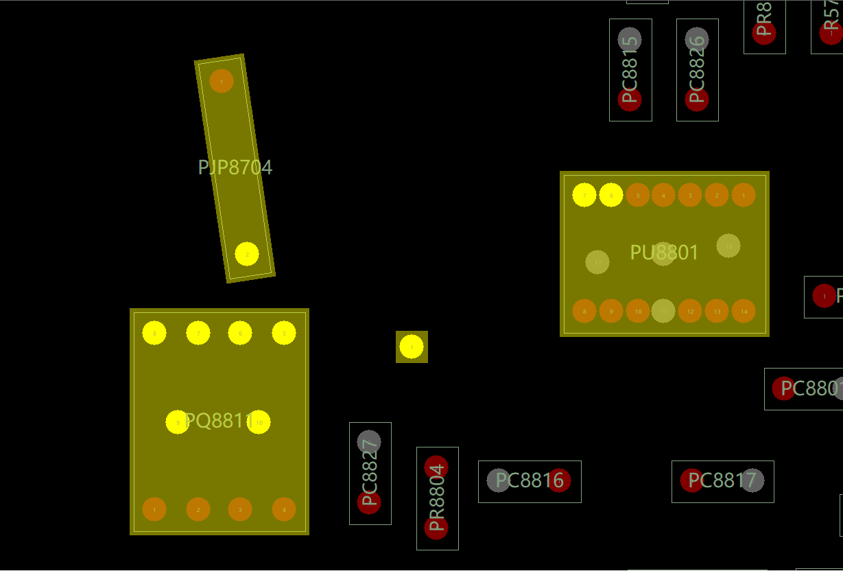

                Hello all, first at all sorry for my english... I´m fighting with one of these... X541uvk r.2...
                If I cut the jumpers PJP8704 and PJP8702 I have 3VA and 5VA... I put the jumper again and I have 0V in both... If I only put PJP8702 I have 5VA stable ... So my conclusion was that I have a shortcircuit after 3VA... well... I attach picture...
                As you can see I have Removed all the component
                PQ881
                PU8601
                PU8801
                leaving the circuit pad alone, and it is shorted to GND.
                How can I continue in order to open this complete pad out of GND

                  Re: X541uvk rev 2.0 no display

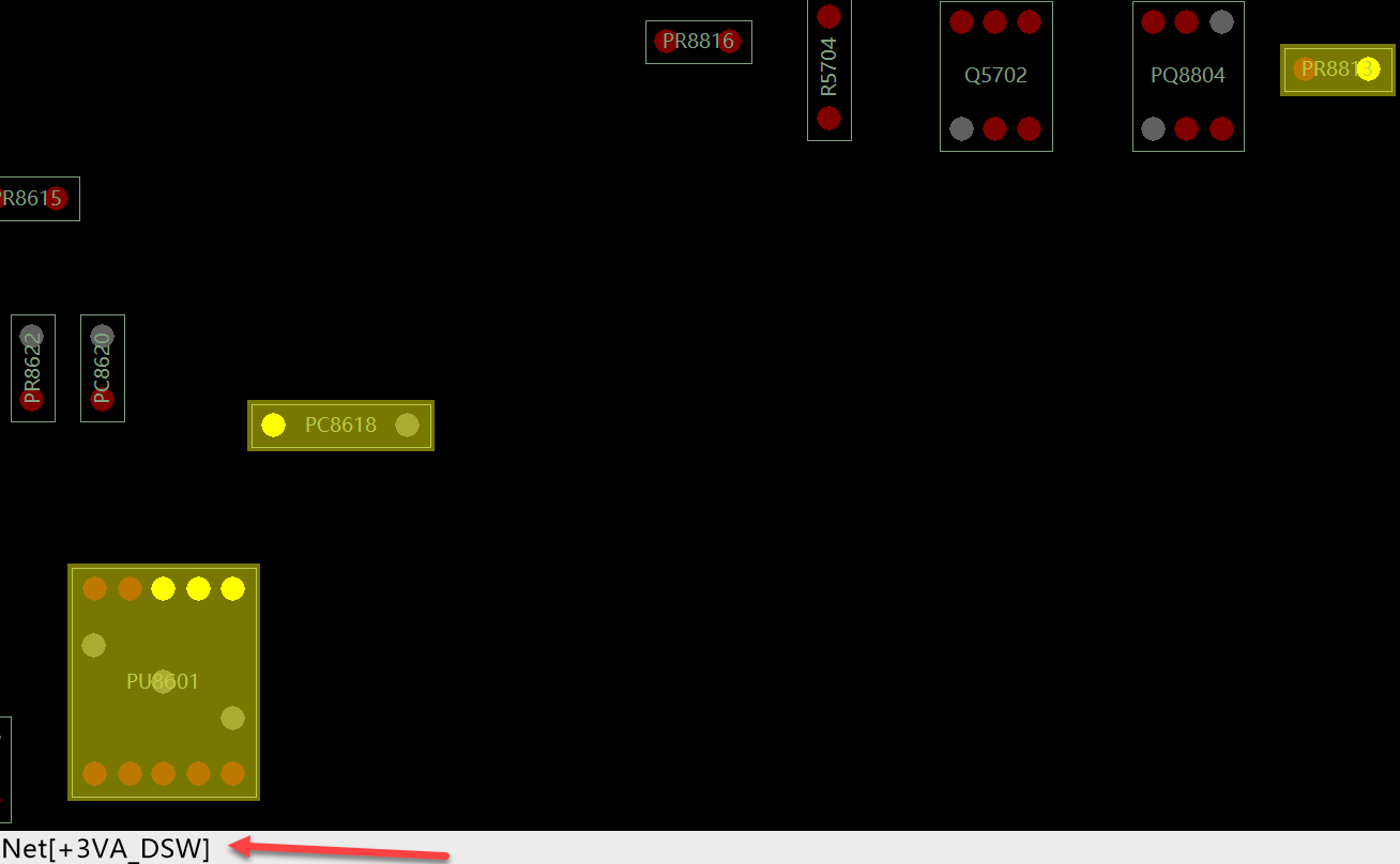

                  You can benefit by downloading the boarwiev file in this topic. You can search for a short circuit in the smd components used after the jumper. After the jumper, you can detect the heated part by injecting a voltage of 3v starting from 1v.
                    Thank you, I will do that, but... what more could I do if I have removed all the components (also removed the cap shown in this picture)?... and the entire trace seems to be shorted to GND... could be a multilayer issue?

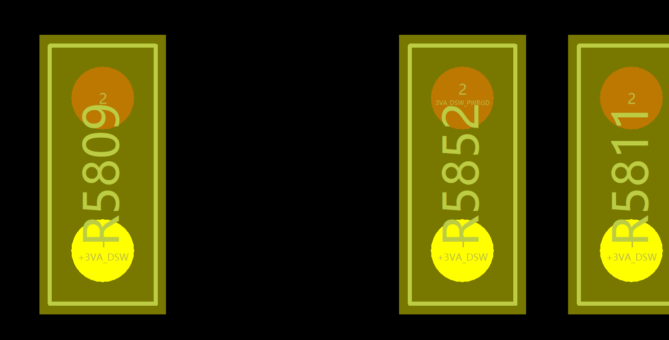

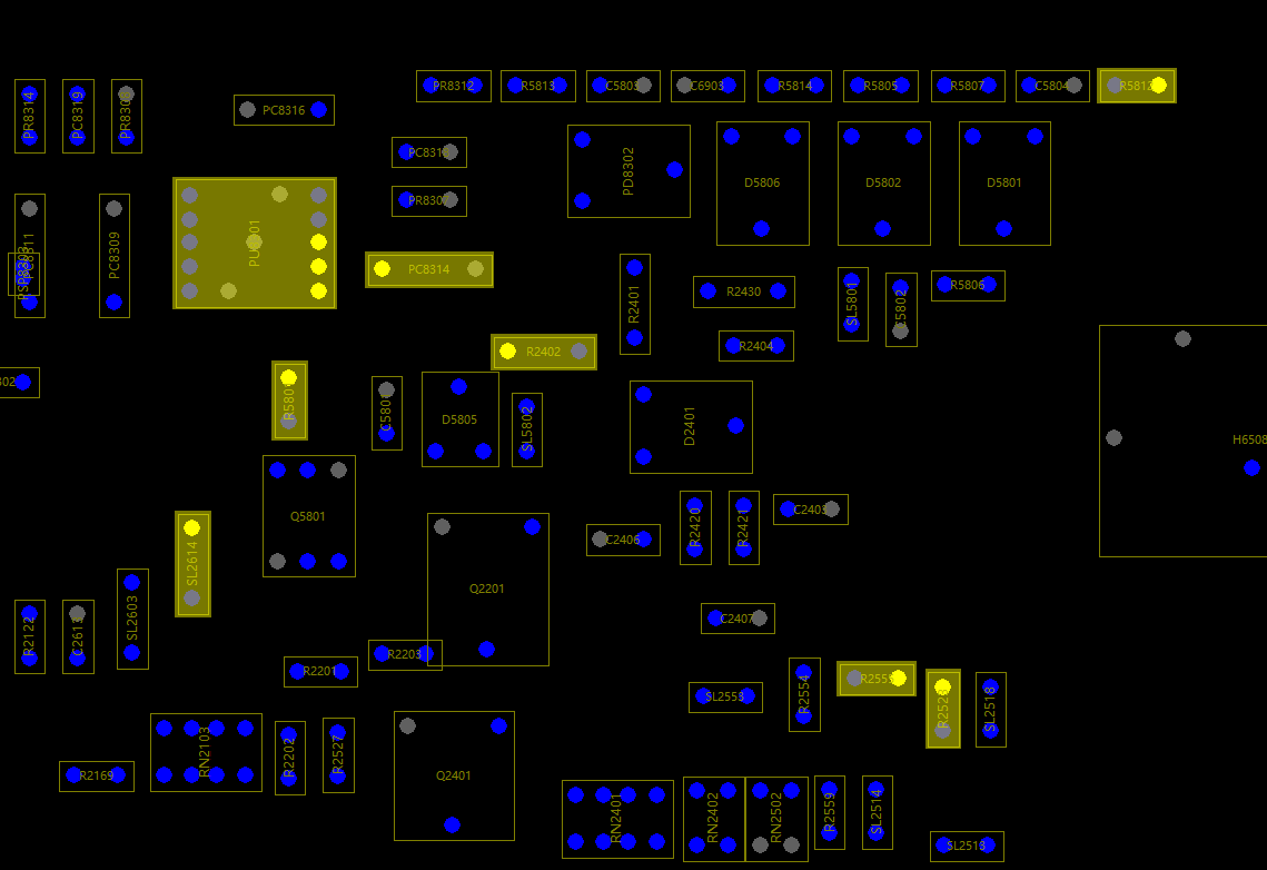

                      The trace you are reporting that goes to ground = Net Name +3VA_DSW.
                      Use the boardview file "Search Net" button -> "+3VA_DSW" to locate all parts that interface with this rail.
                      There are numerous parts on both side of the logic board that mate with +3VA_DSW. Perhaps you have a short on one of these components. Inspect each for liquid damage / corrosion, etc.
                      We recently fixed an A1466 where the +3v42 rail was around +2v88. The client was stating the logic board has never seen any liquid. After removing the logic board -> bottom side (the side facing the keyboard) - we found neon green corrosion across 4 or so 0201 parts. After some alcohol cleaning and rebuilding one of these tiny parts, the +3v42 was restored and the logic board is working fine. The corrosion was near the Lattice FPGA device that is used on the board.
                      Check PR8813 that is still on the board.

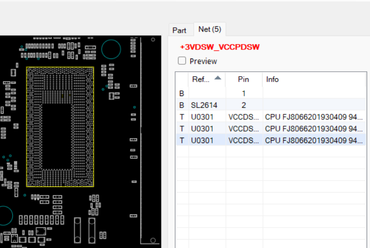

                          Well I have checked all components--- and GND is still in all the trace, I've removed all regulators and power switches, etc. And still in GND... I noticed that +3VA_DSW derives in +3VDSW_VCCPDSW... and this net, also in GND only reach to CPU... so, my conclusion was, CPU shorted. So, bye bye,
