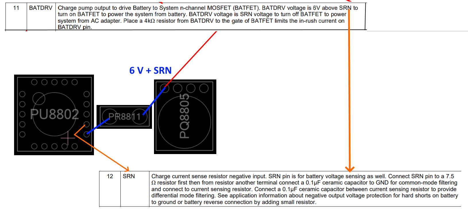

            I suspect this mosfet in the last pic.
            This pic, I'm getting 1.053 volts.. and it should be 18.37 volts.
            This pic I'm getting 3.24 volts and it should be 1.86 volts
            This pic I'm getting 1.053 volts.. and it should be 18.37 volts.
            So I'll be replacing this mosfet and reporting back shortly.. After 4th of december lol.

              Mosfet PQ8805 -> Gate ?

                  Please measure the Gate, Drain & Source voltage on the fet. @jasko_jacker already asked about the gate voltage.
                  • u666sa
                    • Jan 2014
                    • 87
                    Re: X101ch asus, battcon
                    My bad,,
                    D 19.0V
                    S 1.053V
                    G 1.053V

                        Gate voltage is way too low. It is not "turned on". Your fet is most likely fine. Things to try:
                        Take the fet off and measure gate pad on the board again.
                        Trace back which component drives the gate and start troubleshooting there.
                        I can't open fz files on openboardview so I can't tell you what controls the fet.

                          the voltage to charge the battery comes from
                          two mosfets PQ8802 and PQ8803 (to check)
                          as you can see from the diagram the main component is the BQ24725.
                          When ACDET pin voltage falls below 3.15V and above 2.4V,
                          ACOK -> HIGHT
                          BATFET -> OFF
                          ACFET -> ON
                          RBFET -> ON
                          CONDITION TO CHARGE:
                          1 - Charge is enabled via SMBus -> IT INVOLVE FIRMWARE
                          2 - ILIM pin voltage higher than 105mV -> PU8802 P_CHG_ILIM_10 ->?
                          3 - ACOK is valid -> HIGHT -> ?
