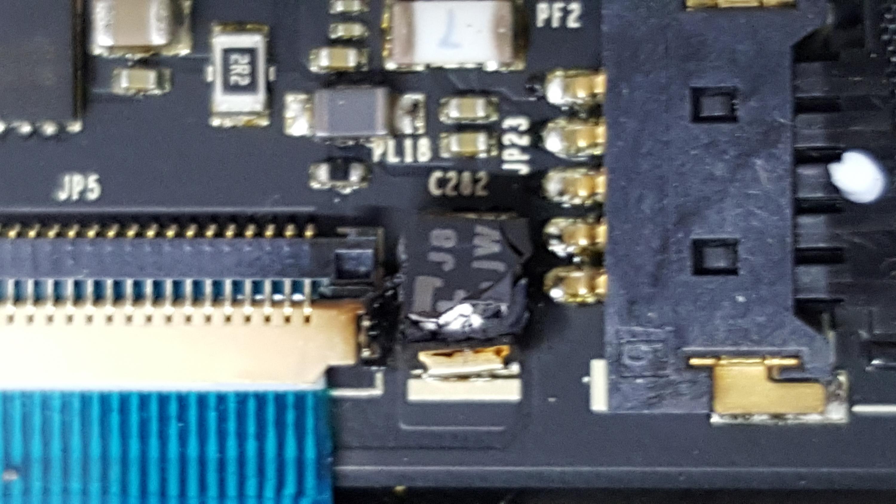

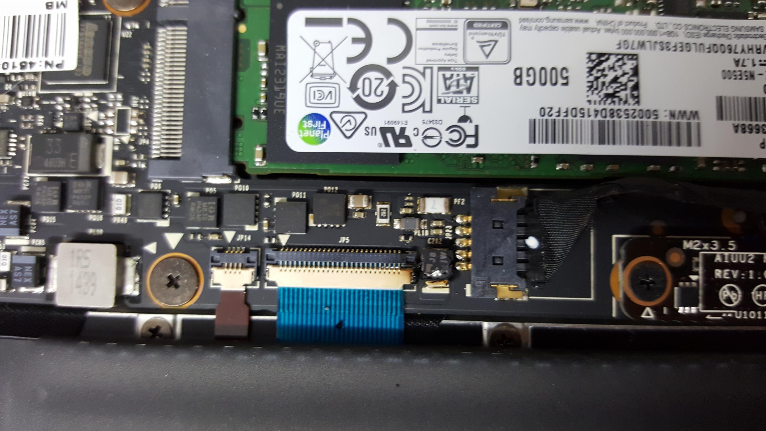

    Lenovo Yoga Pro 3 1370 80HE No USB
    Is that burned SMD a tantalum cap? Anyone know what the proper value is? I looked at some data sheets and J8 should be 220uf but I can find nothing about the JW marking or the proper voltage.
  • mielta
    • Apr 2015
    • 368
    Re: Lenovo Yoga Pro 3 1370 80HE No USB
    Hi
    Desolder it an than messure voltage on Board
    • m4a2t0t
      • Mar 2013
      • 279
      it's 19V.
      Is that a Tantalum or Tantalum Polymer cap? These things are really expensive
      • mferna14
        • Jun 2018
        • 1046
        It's a Tantalum Polymer cap if you really require this info till this day....
