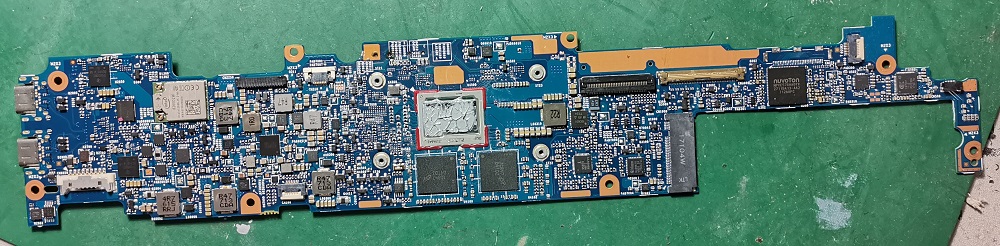

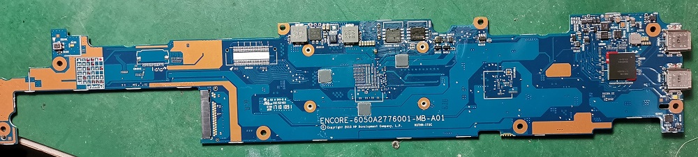

      • KvnTM
        • May 2018
        • 434
        Re: hp elitebook folio g1 no display & beep
        Originally posted by techtiger
        Indicates potential memory failure try with a another working RAM
        Memory seems to be soldered to the board but I agree with you.
        OP: Please upload good photos of top & bottom.
            yes..on board ram..hehehe..but solved..reflow ram

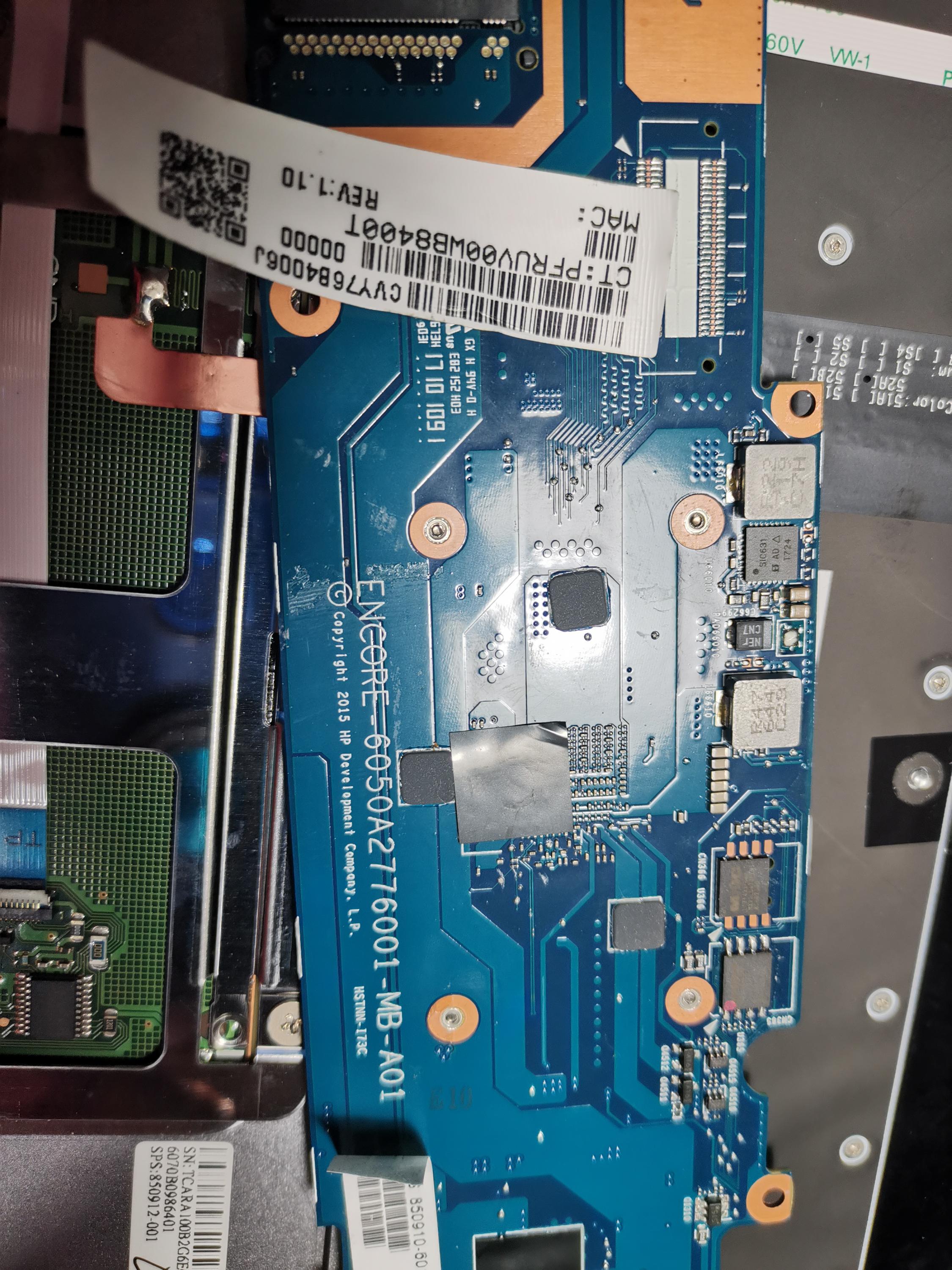

              Might not last long. The problem may recurr within 10-15 days,if the balls are cracked under ram chips which might got connected with heat.
