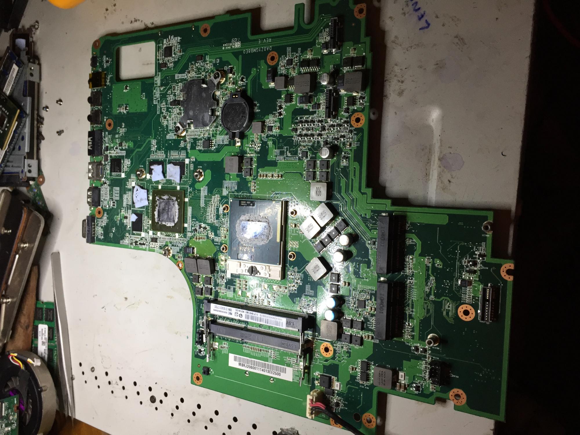

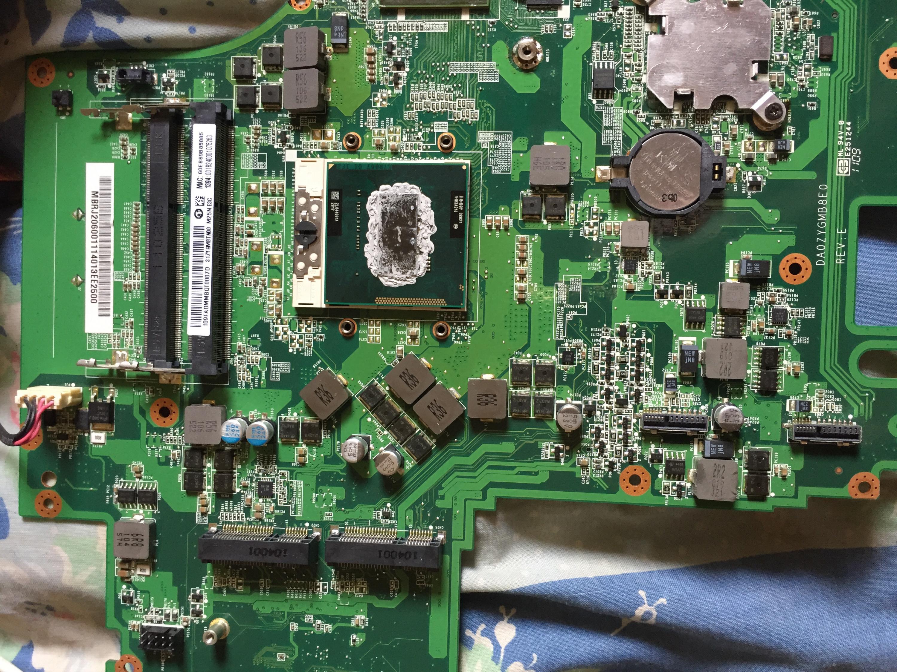

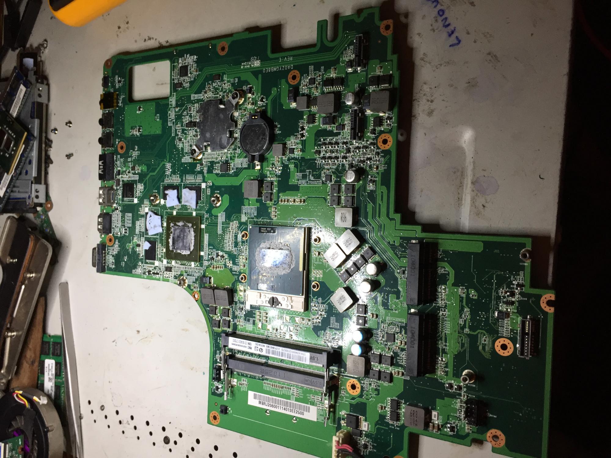

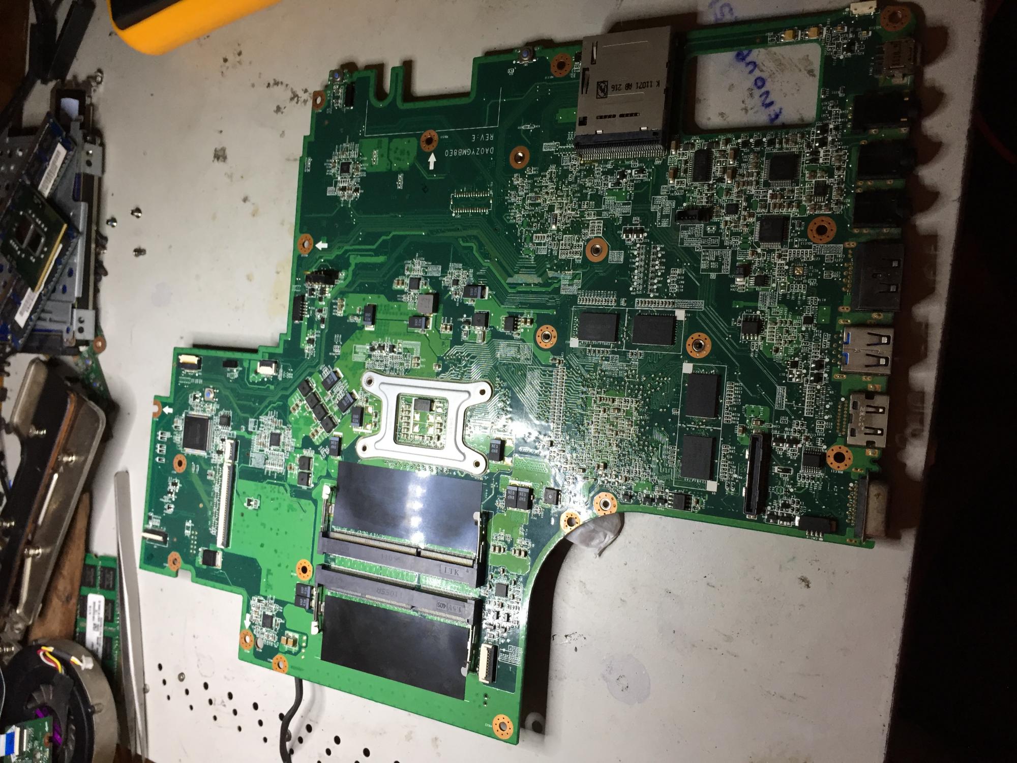

    Hello my lovely brother
    I'm facing a serious problem here:

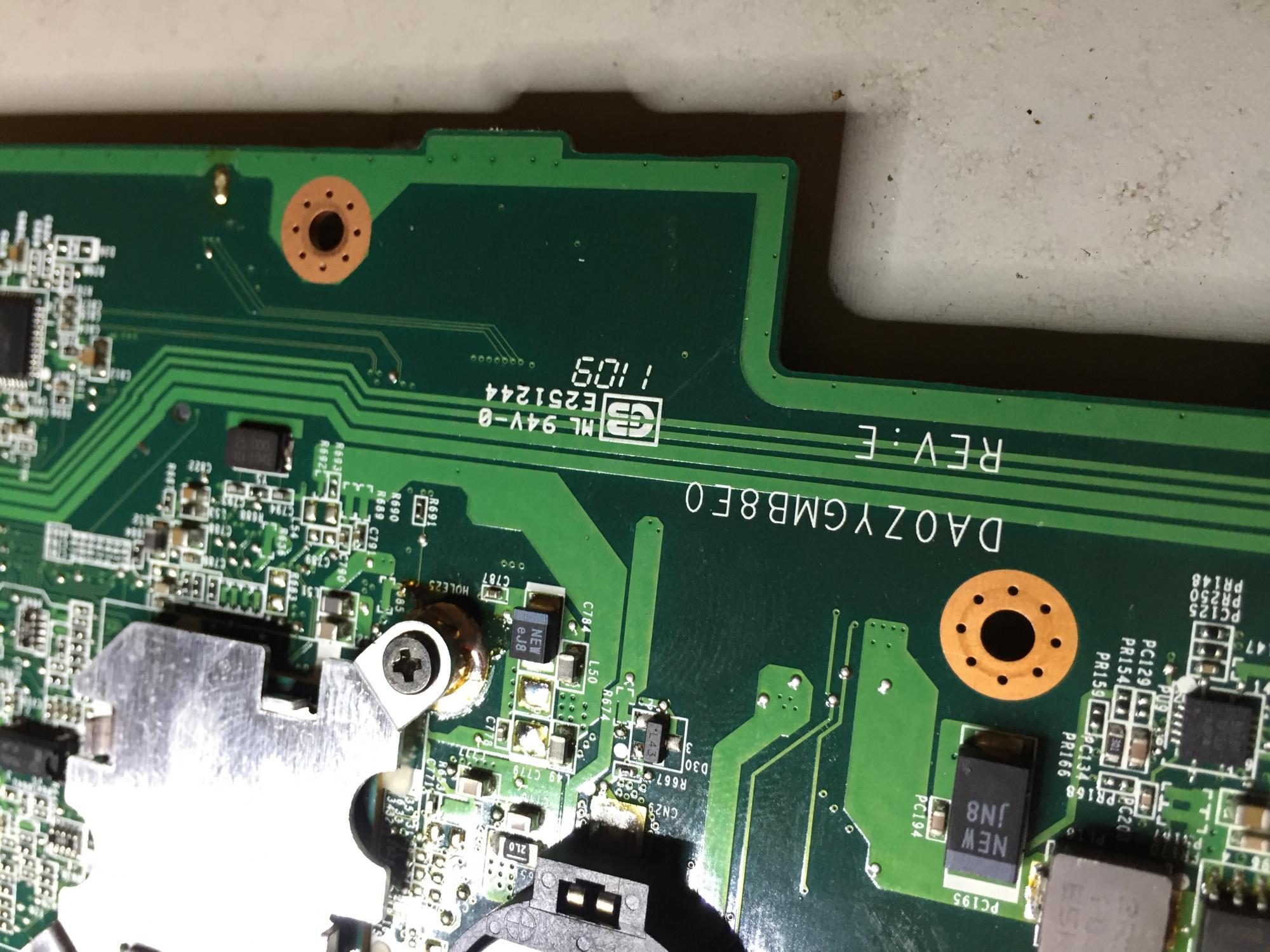

    Acer aspire 8951G with no schematic
    DA0ZYGMB8E0
    REV E
    Press the power button, lights up for a second and shut down
    I checked the power button, it got 3.3v which is okay, and when i press the power button, it goes straight to 0v and go back to 3.3v of which it okay. I have no short in any power rail.
    I have no water damage marks or physical damages on the board, i get all required volts even 5v it available, vcore appears as well when power button pressed and shut down
    Guys please help what should i check now??
    I attached photos as well

    Re: Acer Aspire 8951G not turning On
    hello,
    not sure but this could be bios fault ? as all lines ok and SIO seems to works too
      Find out SIO pin ECRST RSMRST# if no RSMRST BIOS or SIO issue check all pin of EC bios IC for Voltage

            Laptop comes on and quickly shuts down
            My dearest brothers please clue me up here
            DA0ZYGMB8E0
            REV E
            I don’t have a schematic
            Turns on when i press the power button show green light and quickly shuts down. I have 3.3v obvious, 5v appears as well and quickly goes away after pressing the power button.
            But something is confusing me, i checked MAXIM 17511 which is a CPU power Supply controller, the vcc pin is getting 5v as soon as press the power button, again i checked ISL88731A which is a charging controller chip, the VCC pin or VIN pin is getting 5v as well as i press the power button... again there is another chip/controller next to ram, when i check it vcc pin it receiving 5v right after pressing power button and quickly shut down
            Vin/Vcc pins for these chips shouldn’t be 19v?
            Can anyone send a schematic please for this machine, and please guys help me please, what might be causing this?
              Most of the PWM regulators has 5V as vin/vcc.
