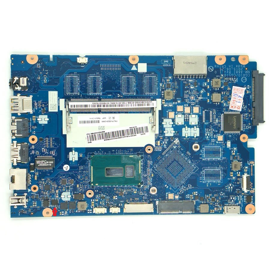

Lenovo IdeaPad 100 board is dead

        Hello
        Same motherboard here. when connect motherboard to original charger,on jack say that is 0.5V. but when conect to bench psu, motherboard immediately has volatage drop on psu and ampere is rising.
        find out that PQ302 on shematic had short. then i remove mosfet from motherboard. now voltage on psu is steady and ampere is 0. solder another mosfet and problem came back. now i stuck.
        Do you have any advice?
          Re: Lenovo IdeaPad 100 board is dead
          @crozoki, you have short in B+ Line. Remove the mosfet again and measure resistance on drain(pin5-6-7-8) of mosfet.
            For so low resstance on PJ304 (near PU200) - check resistance of UA1 pin 24 to ground. If 5 ohm, then cut 24V line (make a jumper with a scalpel). If laptop diode will start or laptop will work, then replace UA1.
