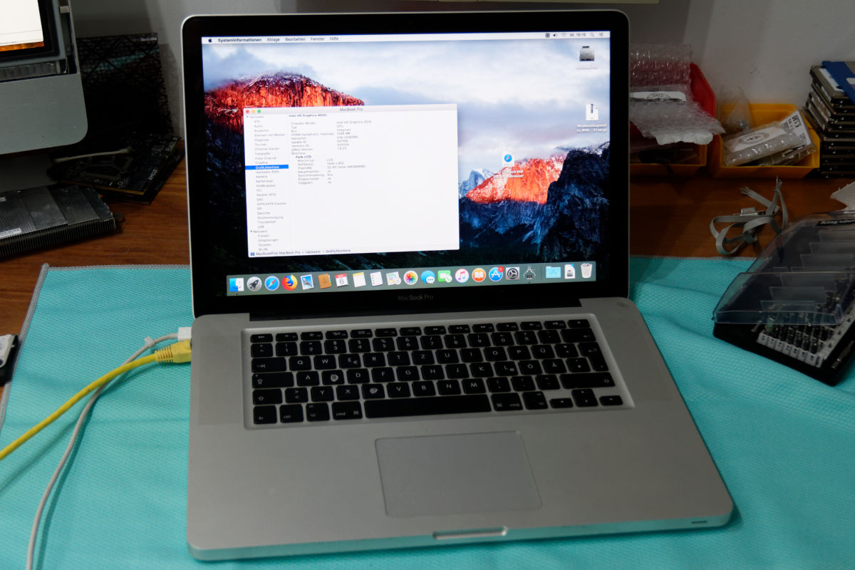

    i got a MBP 2012 from a friend of mine with some Video problems. It just don't show anything internal nor external. The MacBook self is working and can be reached from the Network using Screen Sharing.

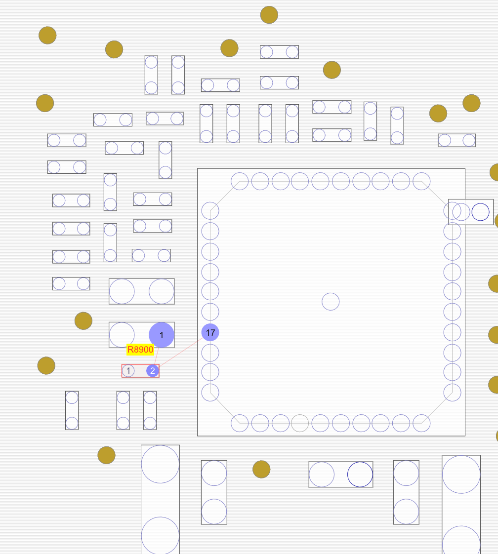

    So here is what i discovered till now and i hope someone can help me a little bit. I am not that experienced in repairing such small hardware. So i got my self the schematic and the boardview of this model. It is the 820-3330A by the way and i watched some Rossmann Videos.
    I measured the GPU Voltages and i discovered that PPGPUFB_S0 is a little bit to low....well it has to be 1.5 and it is 0.025V
    These is what i measured:
    PP3V3_S0GPU_FET 3.3V = 3.334V
    PP3V3_S0GPU 3.3V = 3.331V
    PP1V8_S0GPU 1.8V = 1.790V
    PPGPUFB_S0 1.5V = 0.025V
    PP1V05_S0GPU 1.05V = 1.048V
    PPVCORE_GPU 1.0V = 0.902V
    In the screen dump from the circuit board these are all PPGPUFB_S0 points purple. So the Memory just don't get any power. The other Picture, somehow is smaller than i tried to upload, is the are of the board.

              So finally i had some time, but no success.
              I booted the machine using a USB GPU and that worked fine. I tried to edit the NVram values, but the internal screen stays blank. Also i noticed the white standby LED flashes some times before the chime.
              I still could try to remove the resistor to cut down the power. But at this moment i don't now which one.
              /edit: I just experiment a little and figured out when removing resistor R8900 the dedicated GPU will disappear from the Hardware System information. But still no internal screen.

                Re: MacBook Pro 2012 Non Retina no Video output
                Its working...
                Had to add one more nvram entry to get it working.
