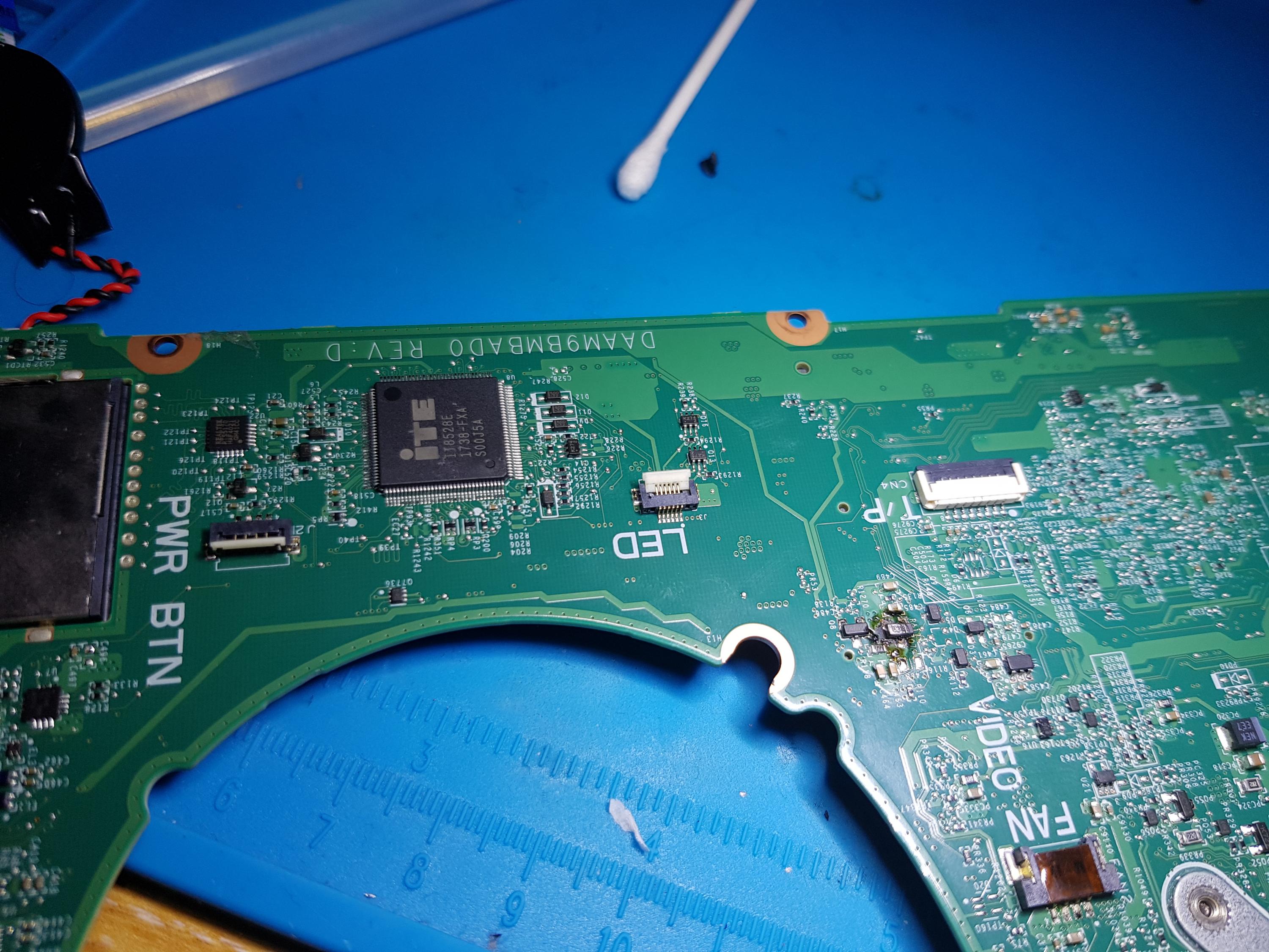

    Hi

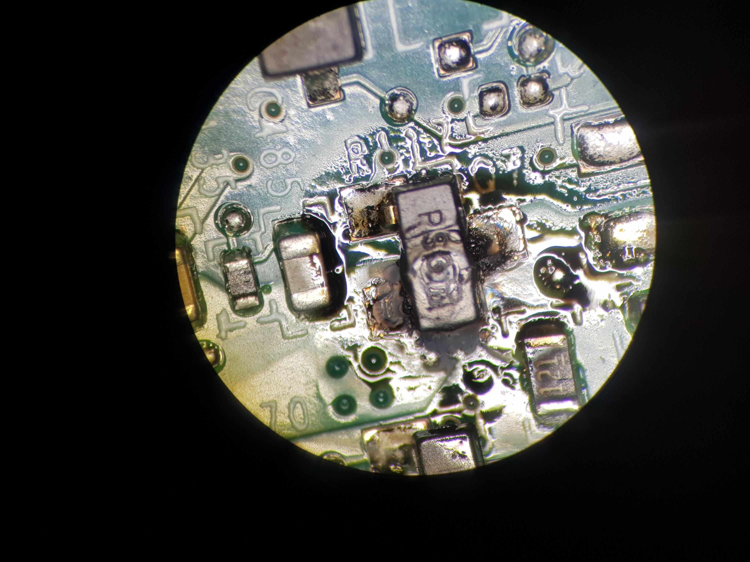

    I have a dead dell inspiron 5577 board that refuses to turn on. I found the component marked PS3 E0 is totally burned. And would be very grateful if you help me to identify it or to find a compatible one.
    Thanks in advance

    Re: Help to identify this sot23 with the marking code PS3 E0? DELL INSPIRON 5577
    It could be a DMP3160L P-Channel mosfet
      Thanks a million. It should that one as per datasheet. I agree.
      You saved me thanks a lot .
