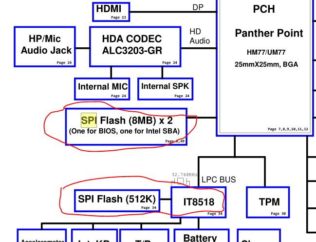

    Hello
    Have this Lenovo t430u with no post.

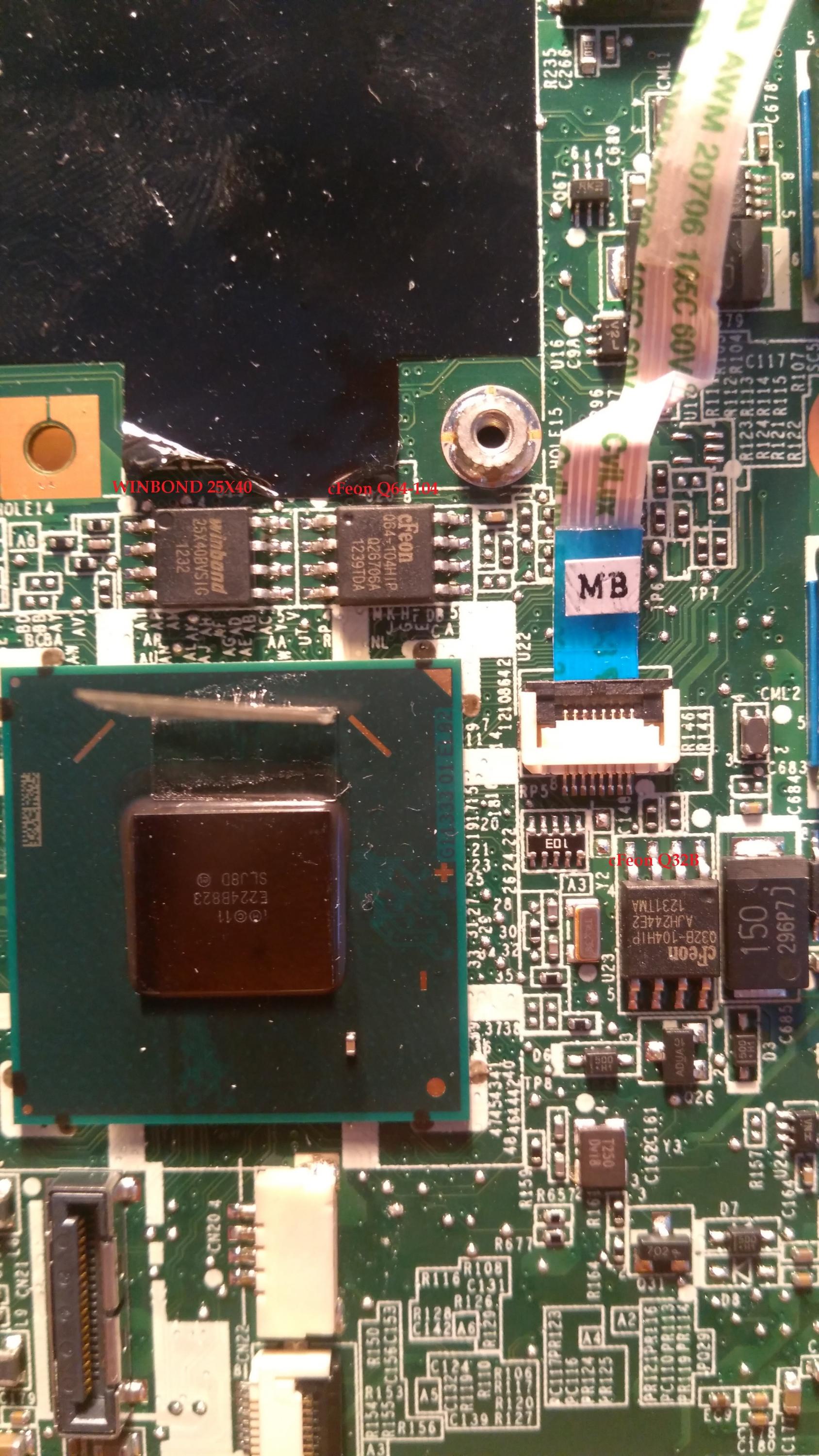

    Found three bios chips, so im confused which one to flash.
    Also if somebody have good dumps it will be great to post it
    there are two 4MB ic and one 8MB ic

      i read that but still dont know what do other two 4BM ic. EC bios and what is second one for?
      and on my board u19 and u23 is 4MB and u20 is 8MB
      MB is rev.F

        U19 is the EC for the ITE i/o . U20 and U23 are dual SPI,the bios is split across the 2 chips.

          U19 is a 4Mb (=512kB) flash. Contains EC firmware.
          U20 is a 64Mb (=8MB) flash. Contains ME Region.
          U23 is a 32Mb (=4MB) flash. Contains main BIOS.

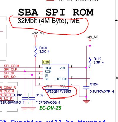

            ME region is bigger than main bios?
            flashed U20 and got picture

              I`m as confused as the schematic

                Yes this ME region is the "5MB SKU" one. It doesn't fit in a 4MB flash.
                The label "32Mbit (4M byte)" is clearly wrong on the schematics. It happens…

                  Yeah, it happens more than once in this schematic. 2 X 8MB
