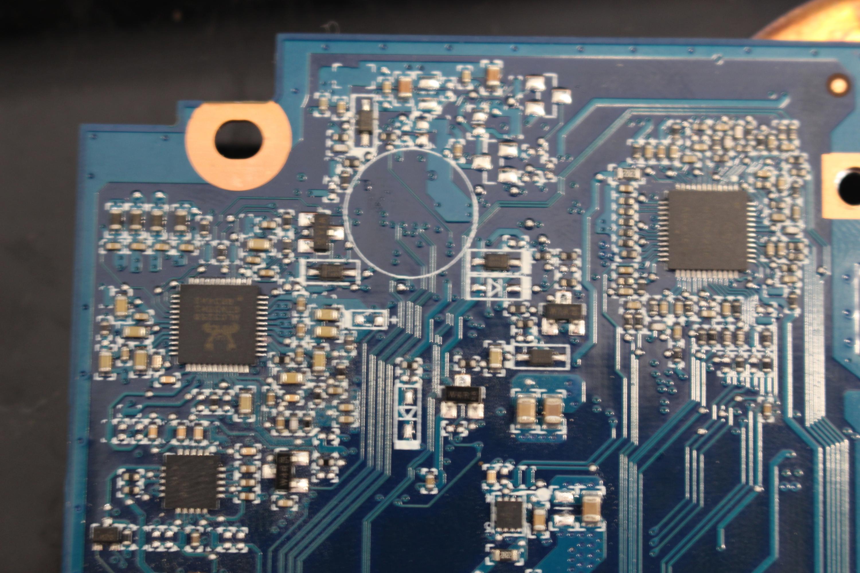

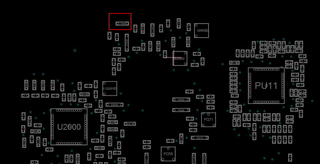

            • jasko_jacker
              • Oct 2014
              • 1137
              • italy
              Re: dag34amb6d0 Backlight fuse
              L7000 , if the boardview match your board , see the pics to identify where it's placed.
              Check if a voltage is present on this component

              • kraken9
                • Apr 2017
                • 6
                Thanks jasko - L7000 is not present.
                That part of the board you showed me does not have L7000 on it.
                • piernov
                  • Jan 2016
                  • 4435
                  • France
                  Apparently on your board "L7000" is just part of the track, so there is no component between the main power rail and the backlight rail that can fail.
